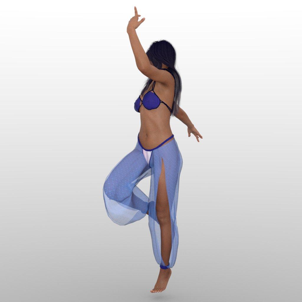

    Adding dForce to any item is easy, just right click on the simulation tab, and then select dForce->Add dForce Modifier: Dynamic Surface
    After that you cross your fingers, as some older items will work with dForce quite well, whereas others will either fall apart, or explode.
    Anyway I do own a V3 clothing item called Harem Dancer (https://www.daz3d.com/harem-dancer-v3), which has a split similar to what you are looking for. It is really old, but it is still available. I auto fitted it to Genesis 8 (I have a V3 clone I moved from Genesis 3, but I think there is some commercial V3 clones around, or auto fit to a Genesis figure you do have a V3 clone for, and then auto fit to G8).
    I changed most of the shaders, (I had to, or I don't think I could have posted it. Products were more risque back in the V3 days). I simulated using dForce, and it worked reasonably well. Make your own judgement from the images below. Figure is Karla 8.
