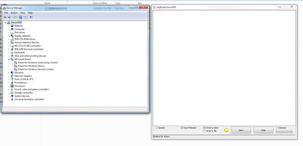

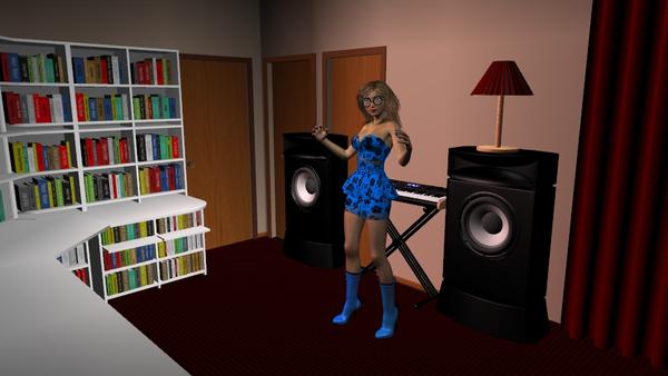

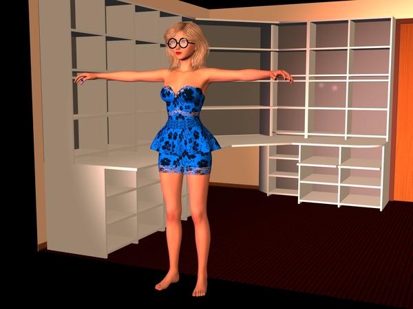

there will be a PC-exe application, the "server"
which will be launched by a Daz Studio script, the "client"
then the server will transmit a constant stream of skeleton poses
which the client will apply to a ( low-poly ) figure
So, as youfrantically gesticulate in front of your Kinect camera
your figure will frantically gesticulate back at you
and all this will be recordable
similar to what i did for the wii-mote and for the gamepads
600 x 600 - 569K

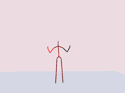

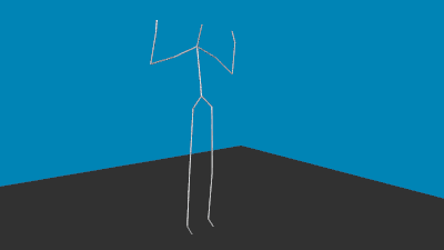

    video
    https://www.youtube.com/watch?v=VNwkHcRpja4

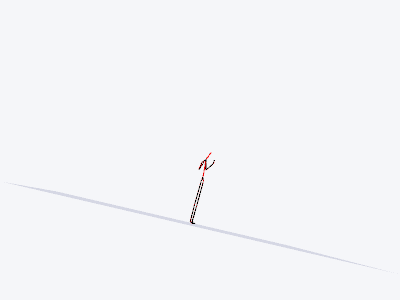

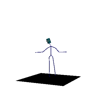

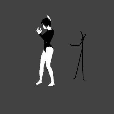

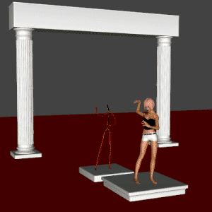

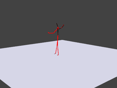

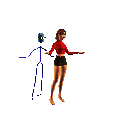

    first tests the stickman posed was derived from joint positions
    in this one it's derived from joint absolute angles (quaternions)
    so we're getting closer to seeing Amy (Aiko3) start moving !
    400 x 400 - 395K
    Post edited by mCasual on

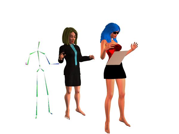

  • mCasualmCasual Posts: 4,607
    edited December 2014

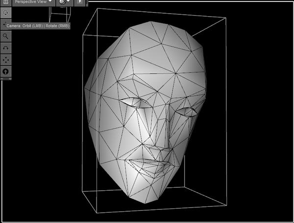

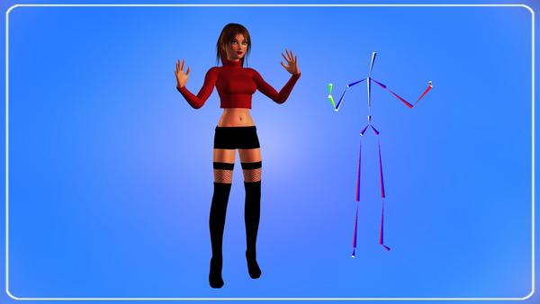

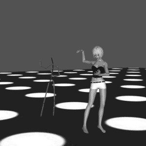

    some progress
    i'll possibly include mechanisms that remove weird limb rotations
    maybe the kinect server should talk to the kinect client ( a daz script ) in Daz Script language
    400 x 400 - 888K

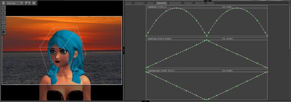

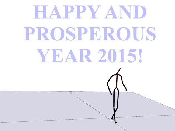

    some walk-around mocap
    400 x 300 - 438K

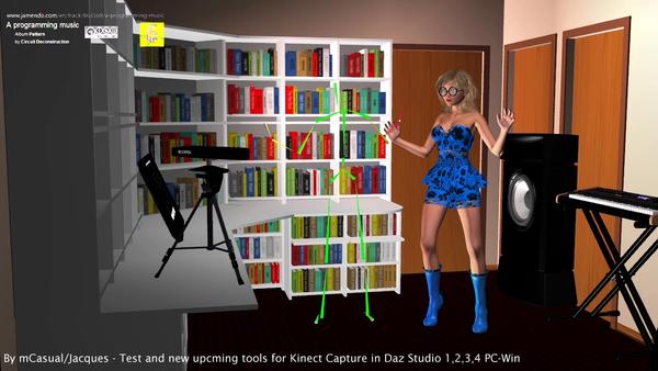

    i was supposed to wait until spring/summer before playing with the kinect
    but i succumbed to temptation

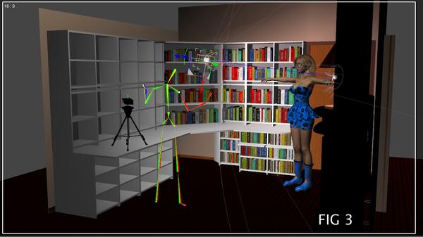

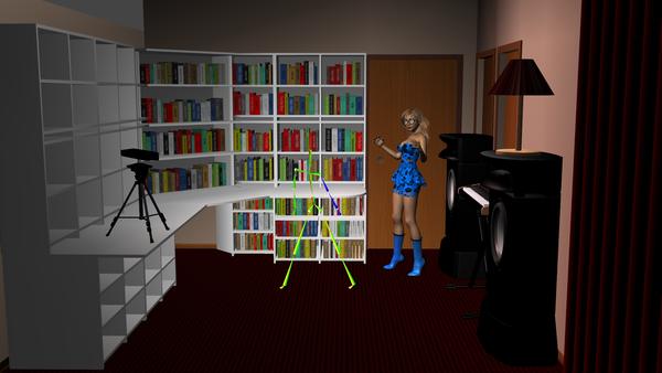

    so the plan is the roll out a usable kinect-mocap system for DS 1, 2, 3, 4 PC-Win7
    then resume work on mcjBuilder, then the Bullet Physics engine, then the cage Deformer, then 3d painting, then ... projects i announced but didnt get to in 2010-2014 :)

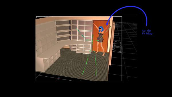

    current issue, the kinect driver doesn't compensate the skeleton poses for the current kinect sensor tilt
    (unless my kinect's accelerometer is toast? )
    400 x 300 - 344K
    1440 x 1080 - 167K
    400 x 300 - 258K

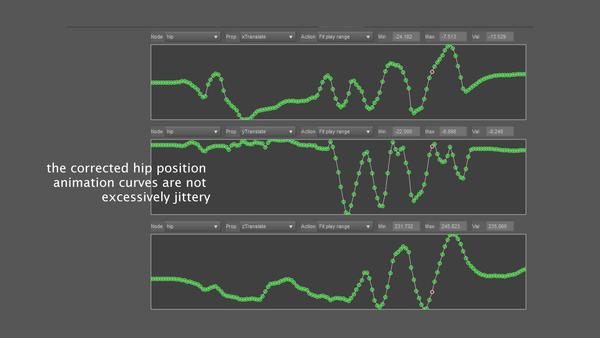

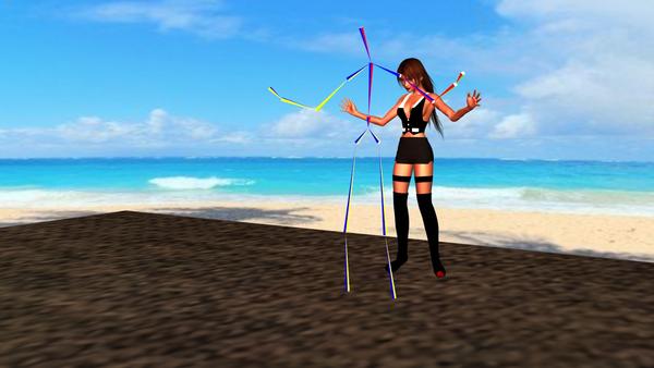

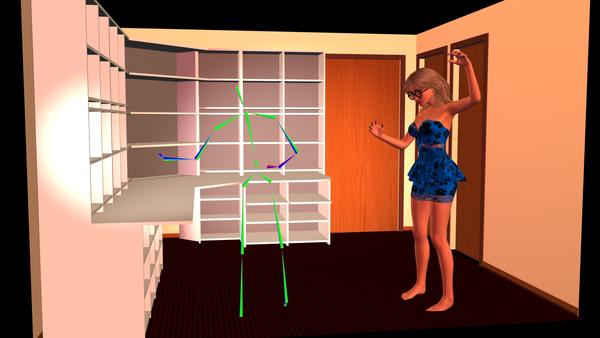

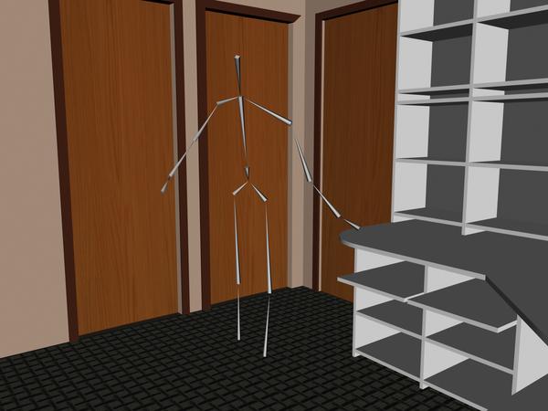

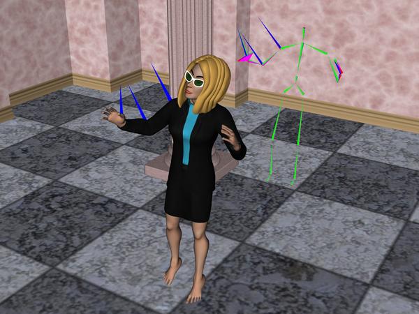

    i didn't mention it in previous renders but the kinect drivers give me the figure poses in the kinect's "space"
    so if the kinect is tilted the animation ( and implied ground plane ) is tilted
    but that's now fixed
    and i'll even bring the animation's ground level to daz studio's Y=0 level
    400 x 300 - 385K

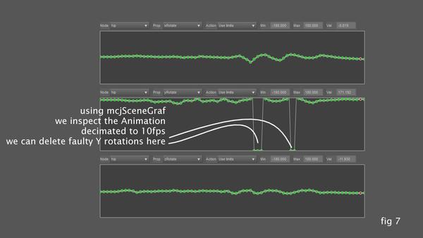

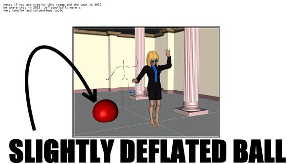

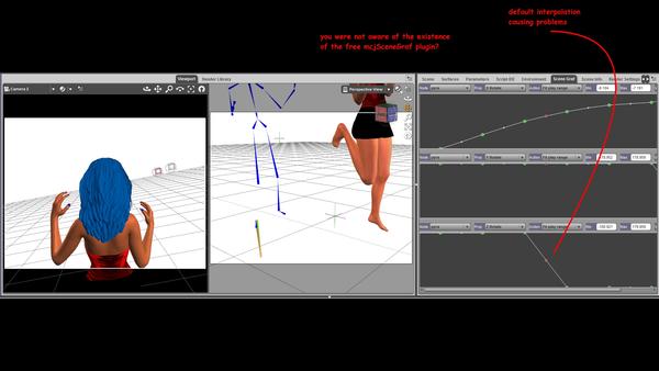

    the pose transfer from the stickman to Amy/Aiko is not correct yet
    so it will be better next demonstration
    but even then, i did have to fix the animation usin mcjCycleFilter
    ( free script that i use a lot to clean up animations and make loops loop smoothly )
    the hand and feet animations will probably always require "manual" cleanup
    the rest of the body, if you're carefull will me almost immediately usable
    the manual will include a section about using my free animation tools which help fix animation issues
    300 x 300 - 978K

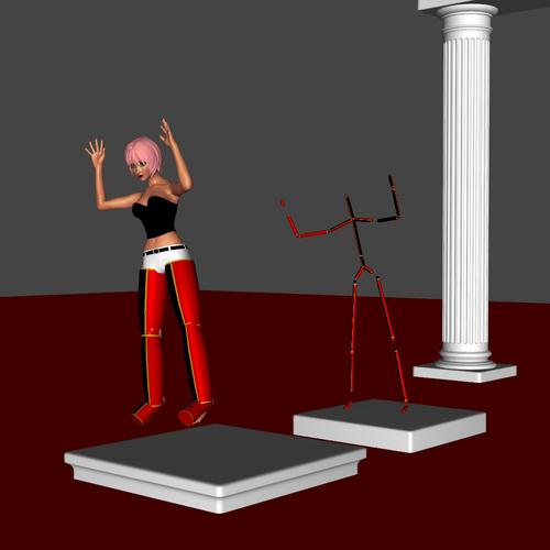

    edited January 2015

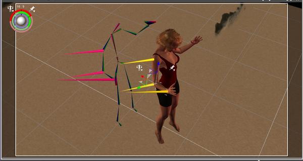

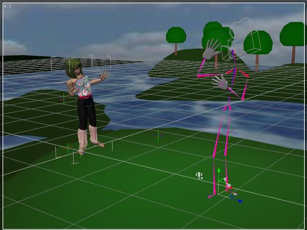

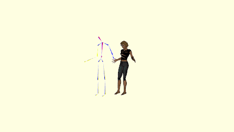

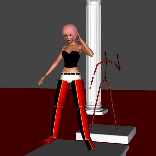

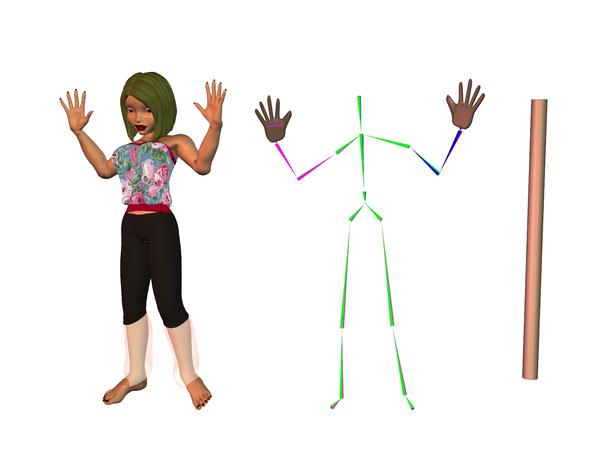

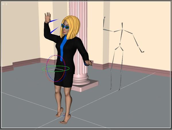

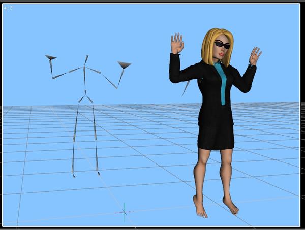

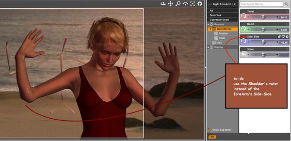

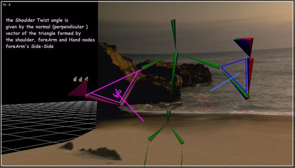

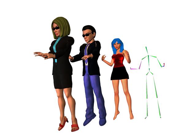

    improved the transfer from the stickman's pose to Amy/Aiko
    the arms
    there's 2 phases
    1 getting the limbs to point the same way
    2 getting the limbs to be twisted the same way
    for the collar bones, i'll probably introduce an adjustable angle offset
    note that if you're familiar with mcjParent
    you could animate a target that follows a hand position
    then have mcjAutoLimb2014 re-build the arm animation
    same thing with the feet/legs
    and using mcjCycle filter you could smoothen the target trajectories
    the legs and feet
    now i have to factor Aiko3's joint orientations
    because they are rarely perfectly aligned with the World's X, Y or Z axis
    this may allow us to handle figures like TheGirl
    1000 x 1000 - 160K
    300 x 300 - 1M

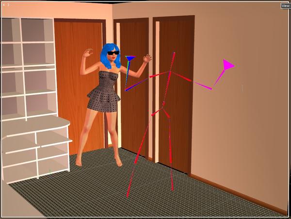

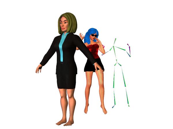

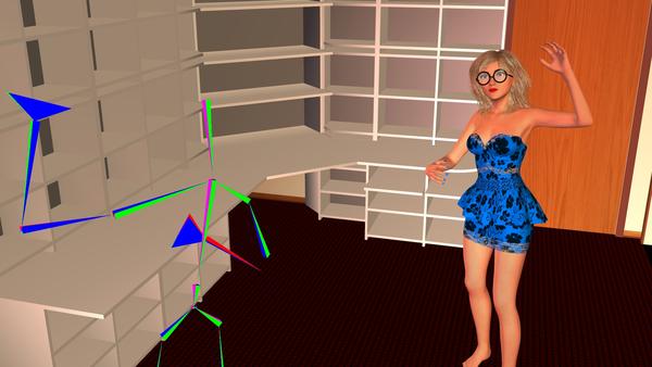

    here you can see Aiko looks extremely way better with the collarbones with an Z Rotation offset of 20 degrees
    1000 x 1000 - 179K
    edited January 2015

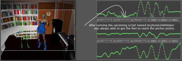

    with the collarbone rotation offset = good
    with the feet glued in place using mcjAutoLimb2014 ... not so bad but not so good
    will i tackle the "re-targeting" issue?
    maybe ... later ... the priority is to get you something to work with if you have a kinect
    ( though you must know there's breckel and ipisoft and a few others ( nuicapture? actinia? ) )
    400 x 400 - 456K

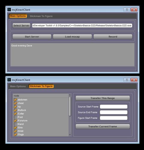

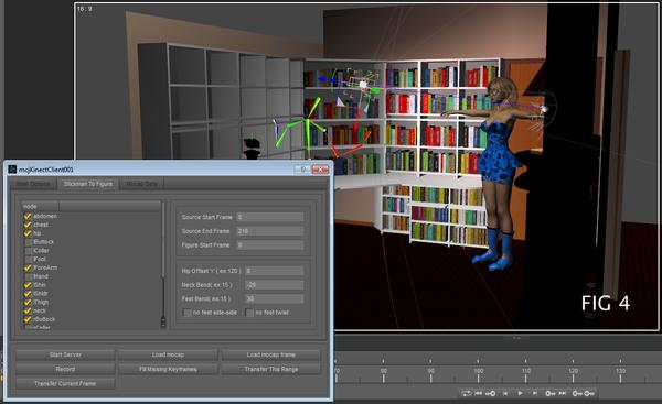

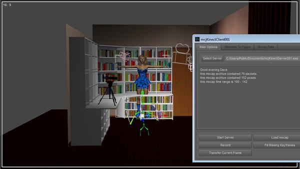

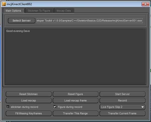

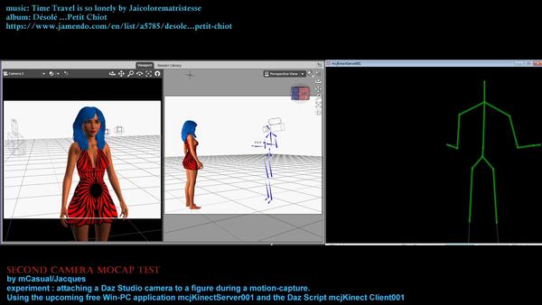

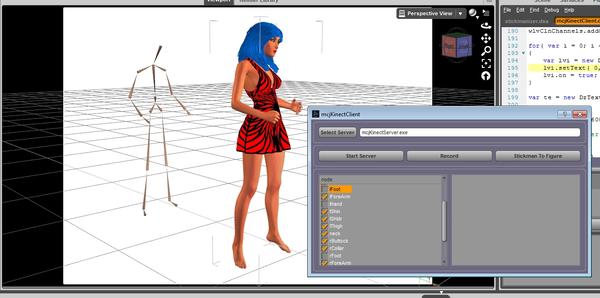

    i tried having the Aiko3 figure move in real-time in Daz Studio during the motion-capture
    but it seemed to reduce the capture rate too much
    so for the capture shown below
    i start a Daz Script named mcjKinectClient
    and through it, i launch the mcjKinectServer, which is, may i remind you, a PC-Windows application
    the server displays a stick-person which moves as fast as me ( very close to 30fps )
    and transmits the poses to the mcjKinectClient, which records them in Aiko3's timeline
    but without changing the currently displayed frame, so Aiko doesn't move during motion-capture
    then when you stop the capture
    you can repair the animation problems and render it
    but i still havethings to fix ( feet ) before the release
    320 x 320 - 553K

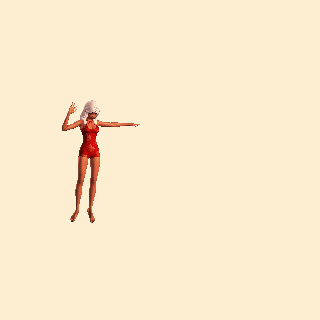

    SixDs said:
    Soooo...., I'm picturing you standing up in front of your Kinect camera doing Amy's funky dance for the benefit of illustration? :)

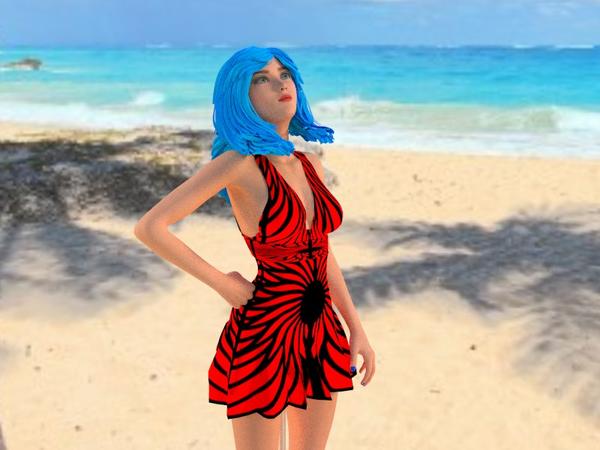

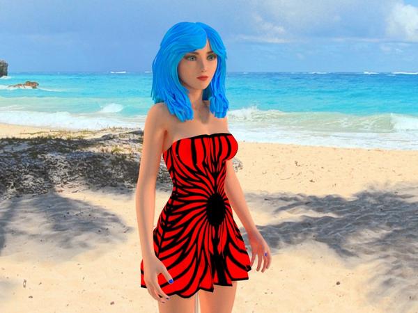

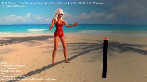

    actually that's the real-life Aiko3 which was motion captured at the beach
    Exclusive Video Footage Proving it all :
    https://www.youtube.com/watch?v=TFn286BeIQ0

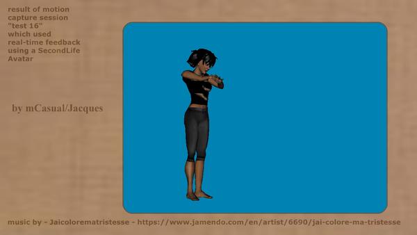

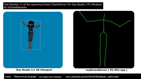

    another Video Demonstration
    here i used the very low-polygon-count SecondLife poser-figure
    and did motion capture with real time animation in daz studio
    if you have a fast PC, you'll probably be able to use more complex figures
    or, do the motion capture with just the green stickman as your feedback

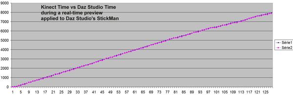

    https://www.youtube.com/watch?v=3oBtAeEW-2s
    note the lag between the Kinect Server window and the Daz Studio viewport
    it's mainly because the Kinect server ( for now ) accumulates a few
    poses before sending them to the daz script client )
    1280 x 720 - 132K

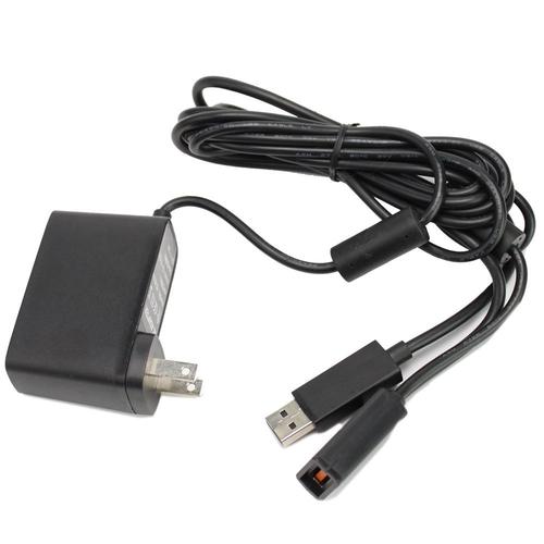

    I'm going to have to get the USB adaptor/power supply for my kinect.
    This is looking really cool. Damn you got the programming skills for sure.
    if you google for
    amazon kinect adapter
    that gets you the type i use, it was about $8
    i read that some of the old kinects don't work on the PC ,
    but the ones that were sold with the "kinect adventures" game pack ( what i bought) do work

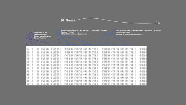

    still working on it
    one of the issues is the weight of the animation data
    another is ( possibly ) being able to record the kinect's audio during motion-capture
    16KHz audio i think ... that must not be a big burden for the CPU(s)
    and i want by record/stop buttons .... ( someday maybe speech-recognition-based )
    400 x 225 - 505K

    if you google for
    Is it the EastVita one you mention? This looks cool!!!
    3doutlaw said:
    if you google for
    mine is exactly like that
    http://www.amazon.ca/Xbox-Kinect-Adapter-Power-Supply/dp/B004IXRXGY
    the other brands, as long as they look like that and have a similar price should work
    edited January 2015
    I'm sure Darrin Stephens would approve of my marketing skills.

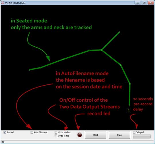

    the start/stop and led buttons work, i have to implement the delayed-start
    and possibly i'll add a control for the kinect tilt-motor
    ( one of the quirks of the kinect is that we are only allowed to activate that motor a few times and let it rest between activations )
    and i guess the control of the smoothing will also be part of the server
    774 x 717 - 86K
