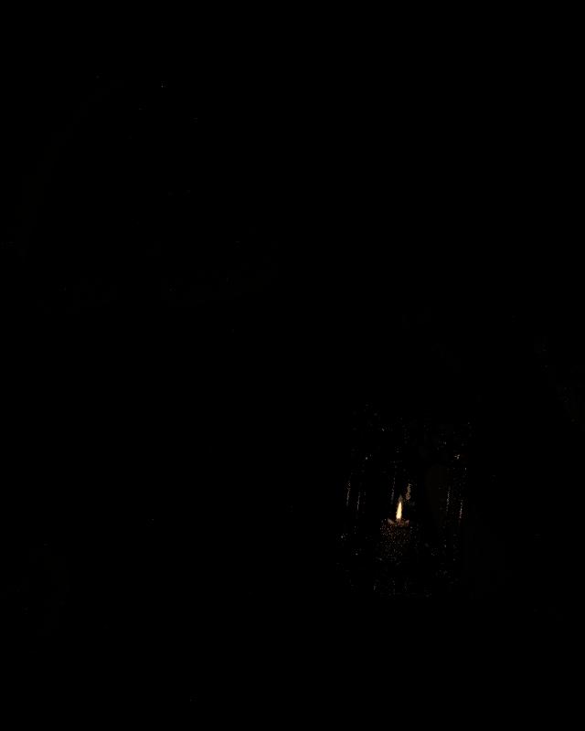

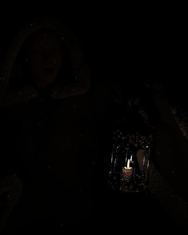

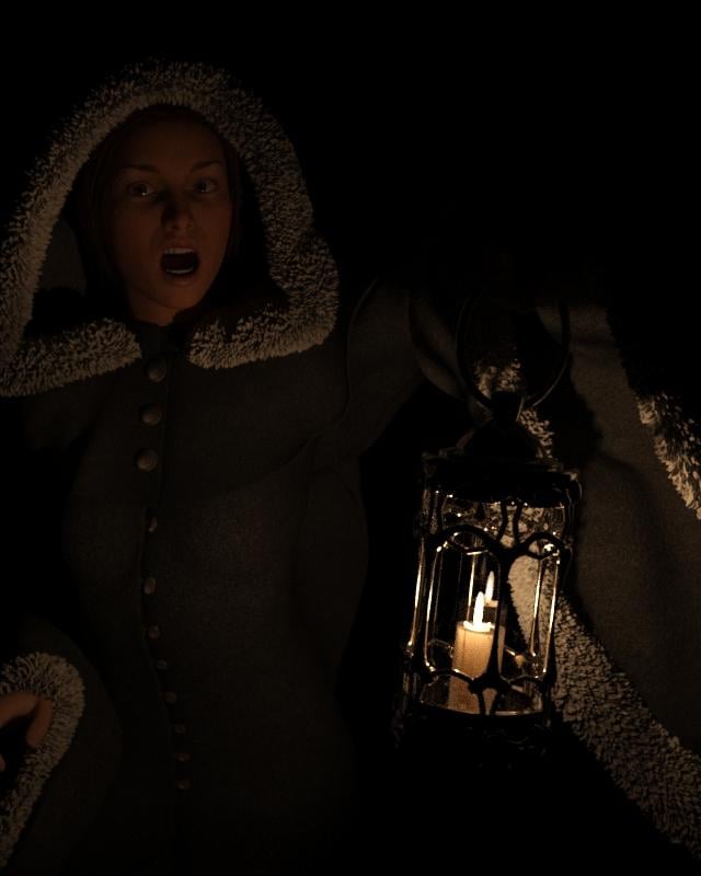

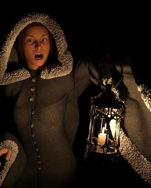

    Experiment 1: Candle light
    Searching Google, a candle outputs about 13 lumens of light so that’s what I set Luminance and Luminance Units to in the Surface Pane. I used default Iray render settings other than setting Environment Mode to Scene and varying Exposure Value. EV is an inverse variable; reducing the value results in more light. The camera headlamp was off, so the only light source is the candle.
    Exposure Value = 13 (default). Very dark, candle barely lights even small parts of the lantern it is in. 13 seconds render time (render stopped automatically at this point).
    Exposure Value = 8. Now parts of the lantern are visible but image is still too dark. 13 seconds render time.
    Exposure Value = 4. The figure is visible but seems too dark for how close the candle is to her face and body. 2 min 56 sec render (5000 iterations).
    Exposure Value = 1. This is more like what I would expect to see in real life. 2 min 56 sec render (5000 iterations).
    Conclusion: Using an Exposure Value of 1 with real-world lumen settings gives a good result.

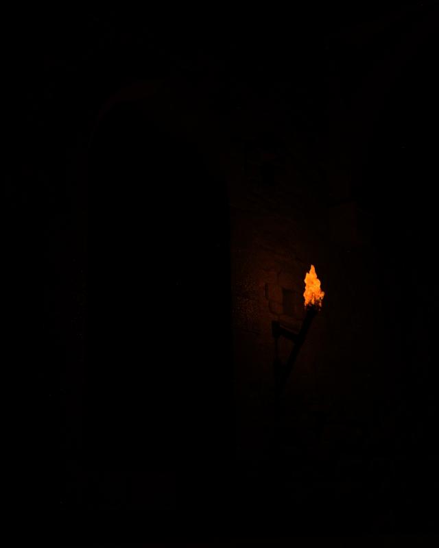

    Experiment 2: Flaming Torch
    Searching Google, a flaming torch outputs about 150-300 lumens so I used 300 lumens. Iray render settings same as experiment 1.
    Exposure Value = 13 (default). Very dark, flame barely visible, no surroundings illuminated. 8 seconds render time (render stopped automatically at this point).
    Exposure Value = 8. Now a tiny bit of the wall is visible but image is still too dark. 8 secs render.
    Exposure Value = 4. More of the building is seen, but for the size of the flame, the area illuminated is relatively small. 8 sec render.
    Exposure Value = 1. Much of the wall is lit. The steps and hints of alcove walls are also visible now. This looks to me to be a reasonable expectation for a torch-lit hall. 1 min (5000 iterations).
    Conclusion: As with experiment 1, using an Exposure Value of 1 with real-world lumen settings gives a good result.

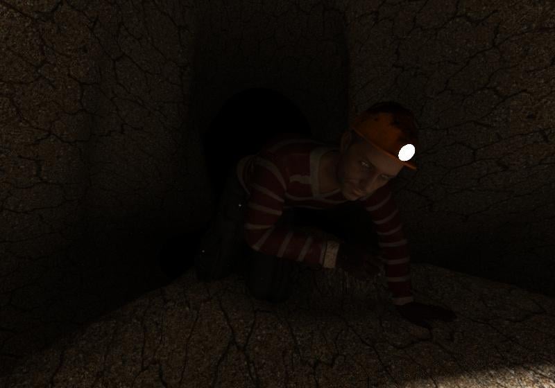

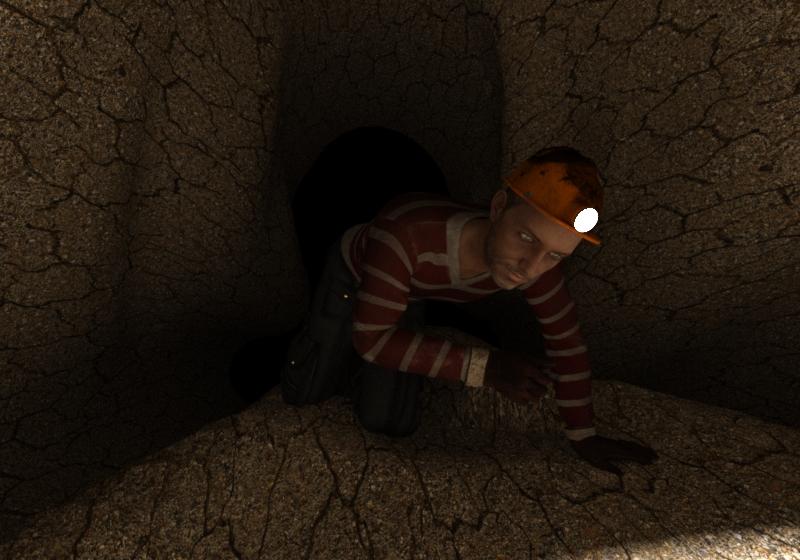

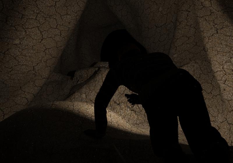

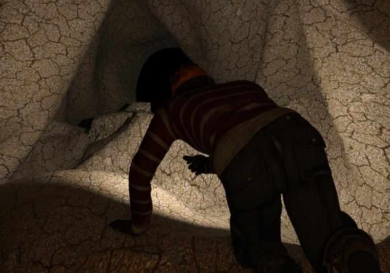

    Experiment 3: Caving
    A cave is a dark environment. Using the results from above, I set Exposure Value to 1 and used real-world values for the helmet light.
    Helmet light set to 13 lumens.
    Second 13 lumen light added behind figure. With twice as much light, I doubled Exposure Value to 2 to balance.
    Helmet light set to 5 wattsExposure Value set to 1
    Exposure Value set to 0.5 to give slightly more light.
    Exposure Value set to 2 to give slightly less light.
    Conclusion: Exposure Values of 1-2 are also a good choice for a caving scene.

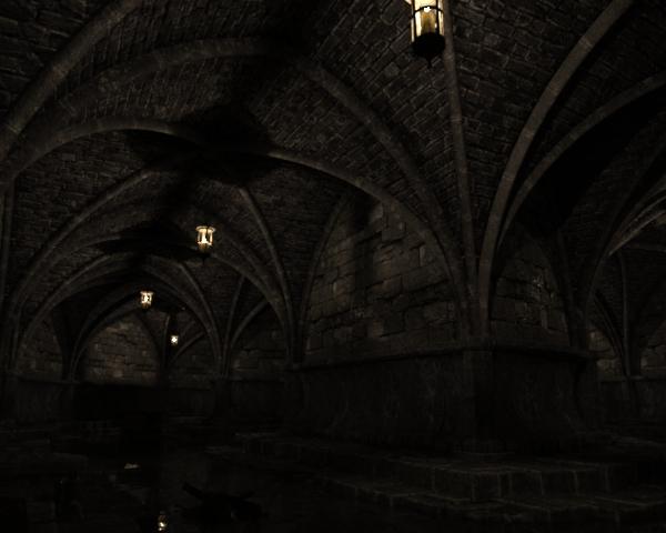

    Experiment 4: Aqua Subterranea
    This is a large stone underground room. It has nine hanging lanterns with a candle in each.
    Exposure Value = 1. Candles set at 13 lumens each. Fairly dark. In real life I wound not expect a large room to be well lit by candles.
    Exposure Value = 1. Candles set to 60 watts each. Dramatically more light, as 60 watts is equivalent to 900 lumens vs. 13 for a single candle. One could cut back on the wattage or go to a higher Exposure Value.
    Exposure Value = 2. This reduces the light a bit to a pleasing level.
    Exposure Value = 13 (default). This render shows how the default exposure level is not appropriate when using real-world values for candles, flames, and light bulbs as it is almost totally black.
    Conclusion: Exposure Values of 1-2 are again a good choice.

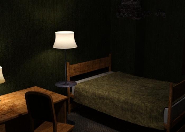

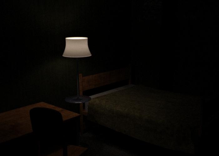

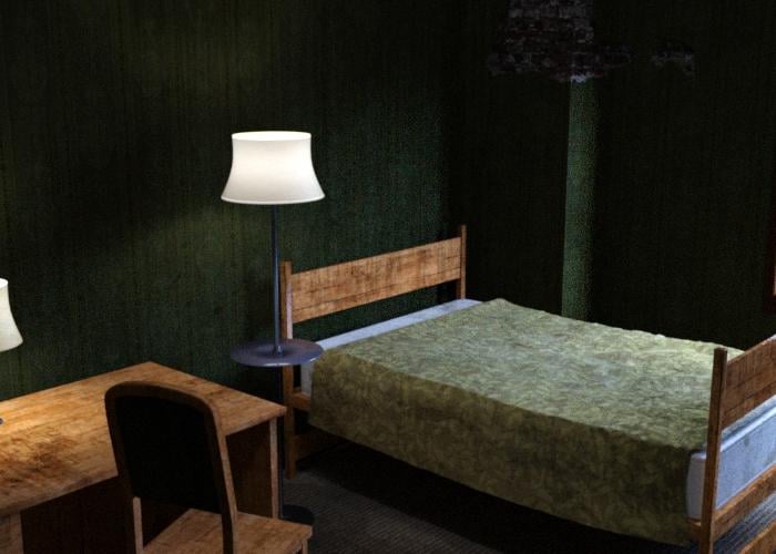

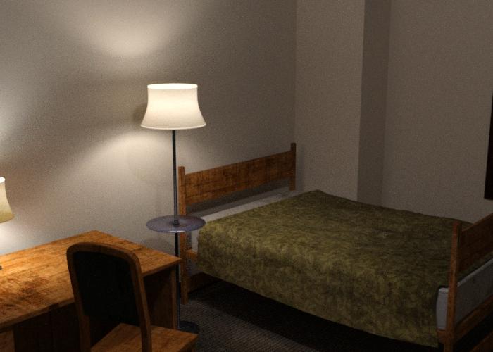

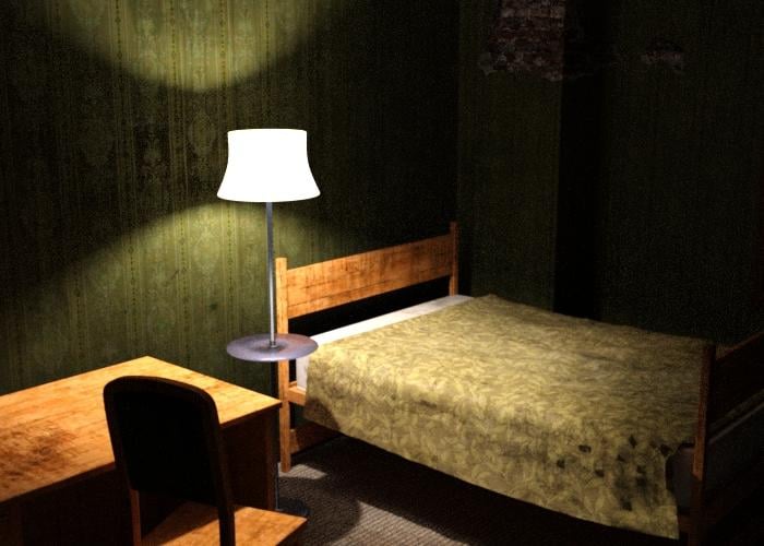

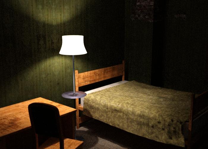

    Experiment 5: Motel Room
    This room has a floor lamp with a 60 watt bulb as the only light. I used the same Iray render settings as for experiment 1.
    Exposure Value = 13 (default). Lamp shade barely visible, no surroundings illuminated. 3.3 seconds render (render stopped automatically at this point).
    Exposure Value = 8. Still very dim, not like one would expect from a 60 watt bulb. 41 seconds render.
    Exposure Value = 4. The walls and floor are now partially illuminated as well as more of the furnishings. Lamp shade is getting overly bright. 59 seconds (5000 iterations).
    Exposure Value = 2. This corner of the room is now fairly well lit. 59 seconds (5000 iterations).
    Exposure Value = 1. This is starting to approach over-exposed, so Exposure Value of 2 may be the best choice. 59 seconds (5000 iterations).
    Conclusion: Exposure Value 1 is fairly good for this case too, although EV 2 is probably a better choice.

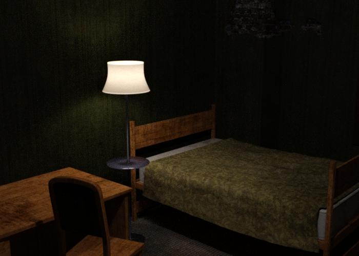

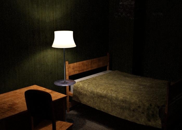

    Experiment 6: Motel Room with Spectral Rendering
    Spectral rendering is supposed to be a more natural way to render light interactions with surfaces but can give darker results as it does in this case. For this experiment, I’ve set Spectral Rendering to On, chose Natural as the Spectral Conversion Intent, and used cie1931 as the Spectral Observer (these are all found in the Render Settings pane). These are all made at Exposure Level 1.
    Spectral rednering = On. 60 watt floor lamp. This gives a result similar to Exposure Level 4 without Spectral Rendering. The walls and bedspread appear to me to have a richer green though. 1 minute (5000 iterations).
    Added a 150 watt ceiling light (out of view). With two light sources, the foot of the bed and the edge of the chair now show light, even though the image is still dim overall. 1 minute 41 seconds (5000 iterations).
    Added a 60 watt desk lamp. There is more light around the desk as expected. I’ve been in hotel rooms with dark walls like this and find this a reasonable representation. 1 minute 45 seconds (5000 iterations).
    Turning Spectral Rendering Off shows how bright the room is with the three lights at Exposure Value 1. The high light level is washing out the green color of the bedspread but is showing the pattern in the wall paper.
    Conclusion Spectral rendering is supposed to better reflect how light interacts with walls and other objects but it can make for darker scenes. As in real life, when that happens you can lighten a dark room by adding more light sources.

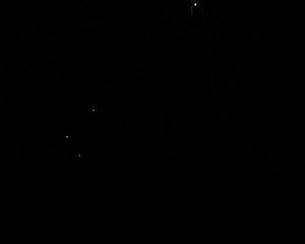

    Experiment 7: Adding a Dome Environment
    The bedroom experiments above had Scene Only render settings. Turning on the dome with the default map will add more light as there is a window off to the right.
    As in real life, opening the drapes bathes the room in more light. Rendering with Dome and Scene at Exposure Value 1 makes for an overly bright room with the bedspread color washed out. Even though there is more light, it takes longer to render than the scene only examples. 4 min 39 sec render time.
    Using an Exposure Value of 1 makes the scene much more light sensitive than the default, which is why the room above is washed out. To compensate, set Environment Intensity in Render Settings to 0.01 to strike a balance. 5 min 15 sec render time.
    Conclusion: If you want to use the dome at Exposure Value 1, you need to reduce Environment Sensitivity to a very low number like 0.01 or 0.02.

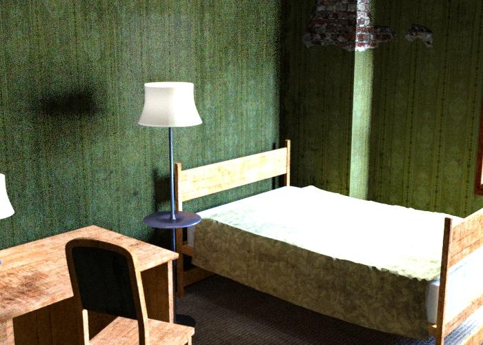

    Experiment 8: Lighter Color Walls
    Everyone knows if you have dark walls (paint, wall paper, paneling) you will have a darker room as the walls absorb a lot of light. Replacing the dark green wallpaper in the room above with light-color walls results in a much brighter image.
    Exposure Value = 1. Render time 6 min 50 sec
    Conclusion: Iray will bounce light around a room. If walls and furnishings are light, you will have a better lit scene just as in real life.

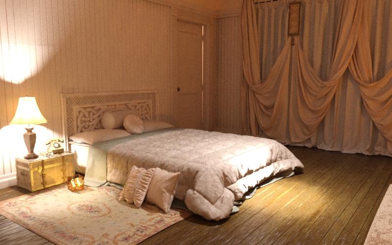

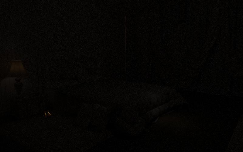

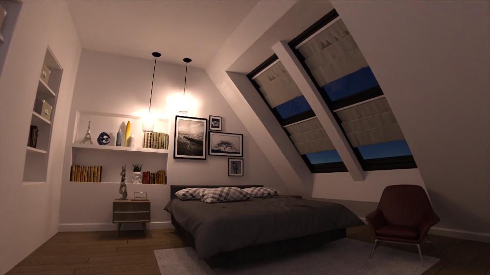

    Experiment 9: Another Bedroom
    This bedroom has light colored walls and multiple light sources: table lamp, candles on the floor by the bed, ceiling fan lights, fireplace flames, candles on the mantel, and a floor lamp. Only the first two sources appear in the render, the others are out of view off to the right side or above. Candles are 13 lumens, table and floor lamps are 60 watts, the three ceiling fan lights are 60 watts each, and the fireplace flame was 300 lumens.
    Exposure Value = 13 (default). Almost totally dark. 5 min 52 sec render time.
    Exposure Value = 1. Now it is well-lit. 17 min render time (this used 15,000 iterations as the 5000 iteration version timed out while still grainy).
    Conclusion: Exposure Value of 1 works well for this light-colored room with multiple light sources.

  • barbultbarbult Posts: 26,827
    edited June 2021

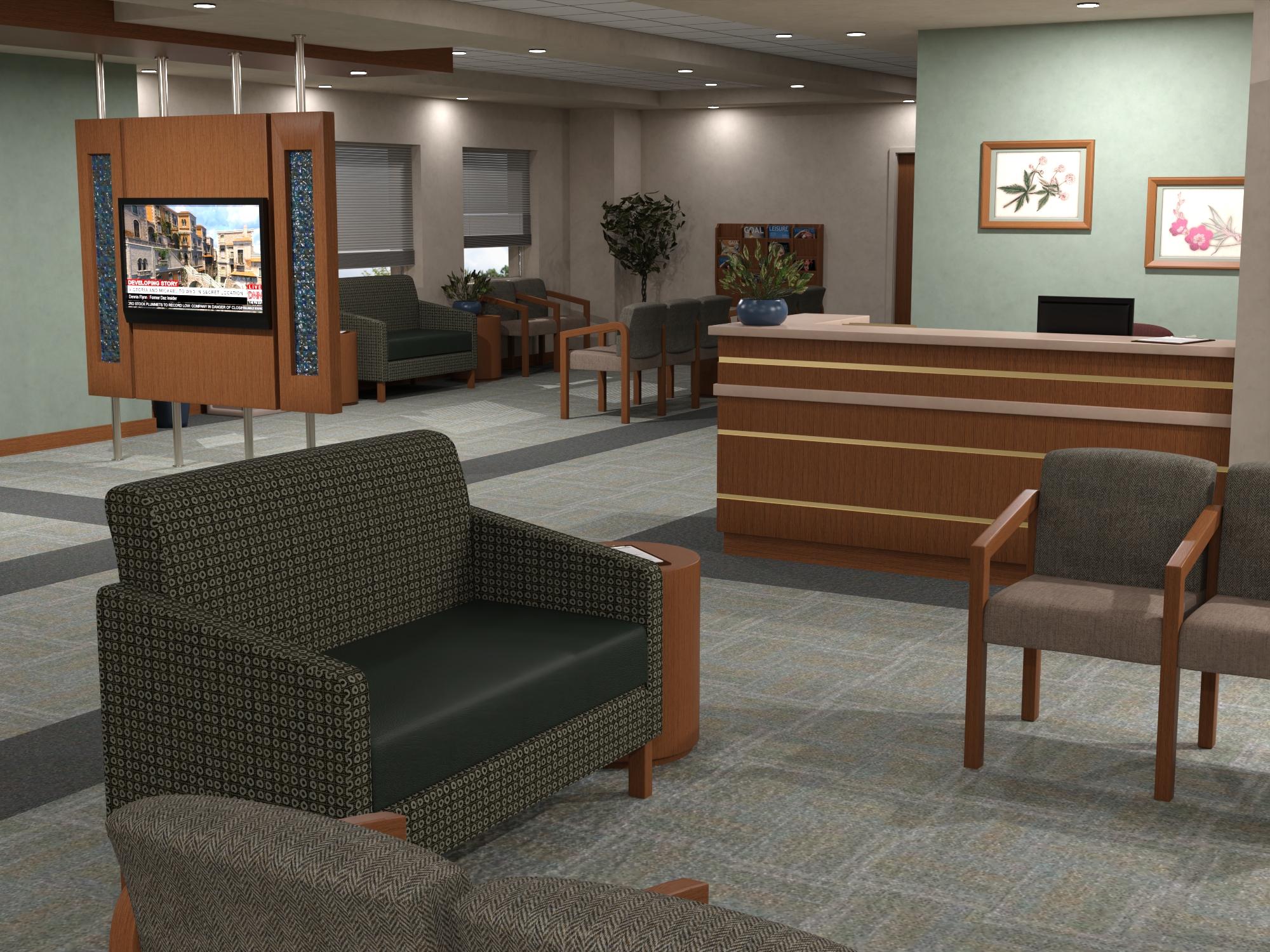

    Here is my first attempt. I think it was very successful and rendered quickly - 98% convergence in about 10 minutes on RTX 2060.
    2000 x 1500 - 2M
    Post edited by barbult on
  • marblemarble Posts: 7,500
    @barbult ... that is really nice, realistic-looking indoor lighting. Before I got the RTX 3090 I wouldn't have attempted something with all those emmisives but I would be able to render that now.
    Somewhat OT but don't you wish that the artists would soften the razor-sharp edges of objects? For me, it is the biggest give-away that I am looking at a CG model render. I sometimes go over those edges with a blur brush just to soften them.It's not that it can't be done. Compare the wooden chair arms with the vertical edge on the reception counter.
    I guess I've never been bothered too much by sharp edges. I'll be more aware of them now that you mentioned the subject.

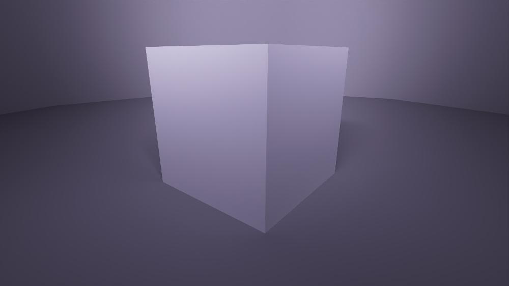

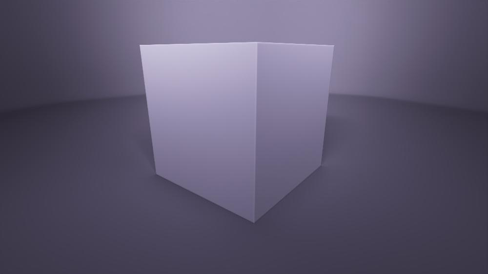

    Try using round corners radius in your shader settings - It basically fakes beveled edges.
    a simle scene with 2 basiv primatives - and prfectly sharp edges
    with round corner radius. a smaller value for the cube and a much larger value for the cylinder its sitting in
    1000 x 562 - 95K
    1000 x 562 - 95K
