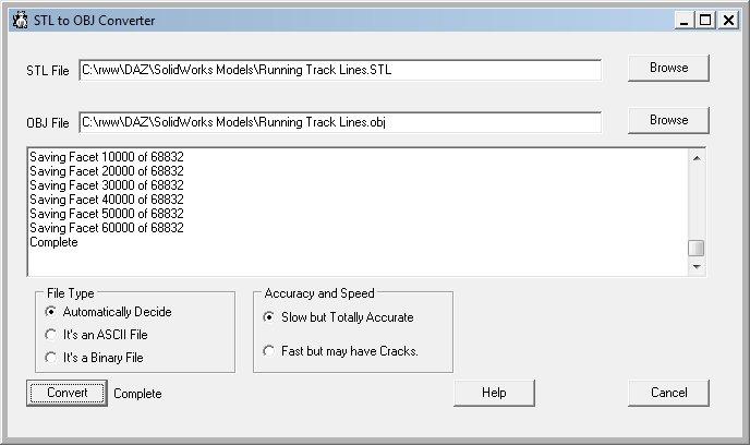

With the Olympics, hopefully, happening this year, I have been inspired to create a running track freebie. Not sure if anyone is going to find it of the slightest interest, but even if no-one does, it will have taught me a great deal.
I have modelled a complete county level stadium in SolidWorks.
Then, the problem is getting it out into DS, as there are no shared file formats. DS works with shells, SolidWorks with, er, solids. So, I have to export the component I'm interested in via STL format. Then use my own software to translate to OBJ.
STL format has no mapping, surface groups or anything like that. So, I load it into my own modeller, allocate surface groups, do the mapping and correct any triangle problems. I have done this to the outfield and spectator bank.
This showed me there was a problem with lack of significant figures in DS, so I had to create a low wall between the bank and the outfield, to cover over gaps not present in my own modeller or the OBJ files. Then onto the tartan and lane markings. That went reasonably well.
Then into DS and allocating materials. I am mostly using seamless textures offered for nothing on texturelib.com, and then use the freebie package 'Materialise' to create the other maps needed with no further reference material. The short grass texture works well, but the long grass one shows banding at integer tiling values. Rather strange, it seems to me. When a tiling value of 51.23 is used, banding disappears, but is strongly visible at 51 & 52. The banding isn't even consistently at a set position across a tile, with bands randomly being darker or lighter. Very, very odd. A minor band is just visible to the right of the low wall levelwith the capping stones below:
Anyway, I attach a few images to show the progress. If you're interested, take a look. If not, take a look anyway ;). If you can suggest things to add, or better ways to do things (bearing in mind that I can't load Blender on my PC because the AV software kills it), I'm all ears.
I'm hoping to release everything at or below ground level in one package, then work through with things like sprint starting blocks, sprint poses, hurdles, hurdle poses. Then steeplechase, long and triple jumps, high jump, pole vault, discus and hammer, along with the cage, then javelin. Then get the 100m monorail camera working, followed by the medal podia and the flags. All in all, it's a big job, just started.

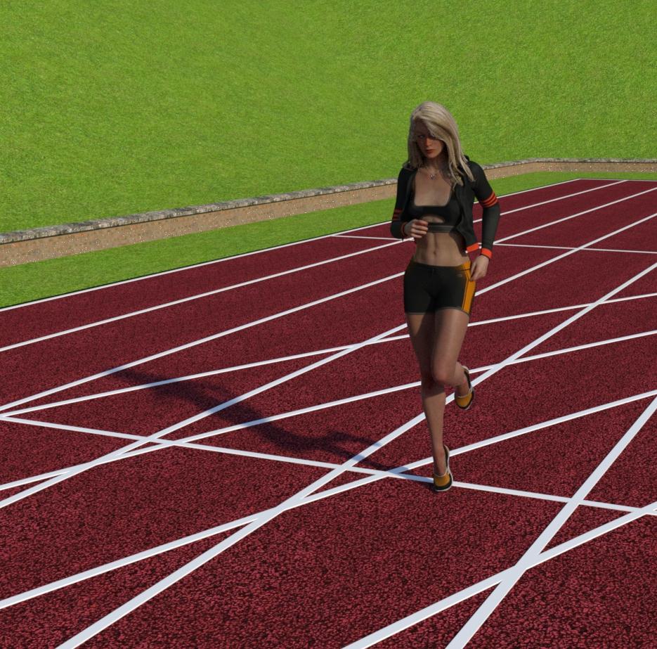

And finally someone just jogging on the track, the first render for it:
Regards,
Richard.

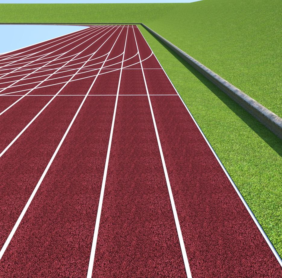

  • One thing I meant to mention, the whole thing is accurately scaled for a 400m track, with data on sizes harvested from the IAAF, and a number of its national subsidiaries, the Australian one on particular had a very useful and informative web site.
    The number of lanes is 10 - big enough to host the Olympics if needed. The bank and outer wall could be replaced with a stadium.
    Regards
    Richard

    Did a bit more towards getting the model into DS. It seems I'm going to have to re-model the central grass in my modeller because in the third render, you can see sharp triangle artefacts marking the grass going from the end of the Javelin Runway to the corner by the 200m start in the bottom left of the image. Irritating as it's a fairly complex shape with those clipped corners due to the running track and the 800cm radius at the end of the Javelin thowing runway. Going to take a fair bit to correctly model that again.
    I've got the water in the steeplechase water jump, and need to create a tartan cover for it. The pole vault, shot and discus/hammer features are there along with most lines needed. There are 8000+ facets in each of the sand pits for long & triple jumps (5cm square) ready to apply impact morphs. Getting there, but still a bit of work to do. I have an idea for the sand morphs - pose a figure and animate an impact with the sand with dForce dynamic surface for the sand and no gravity. Then save as an obj & re-import as a morph. Do it with several poses & that should give a reasonable range of dialable morphs.
    Plan view:
    From the 100m start at competitor eye level:
    From a 300m altitude:
    Regards,
    Richard

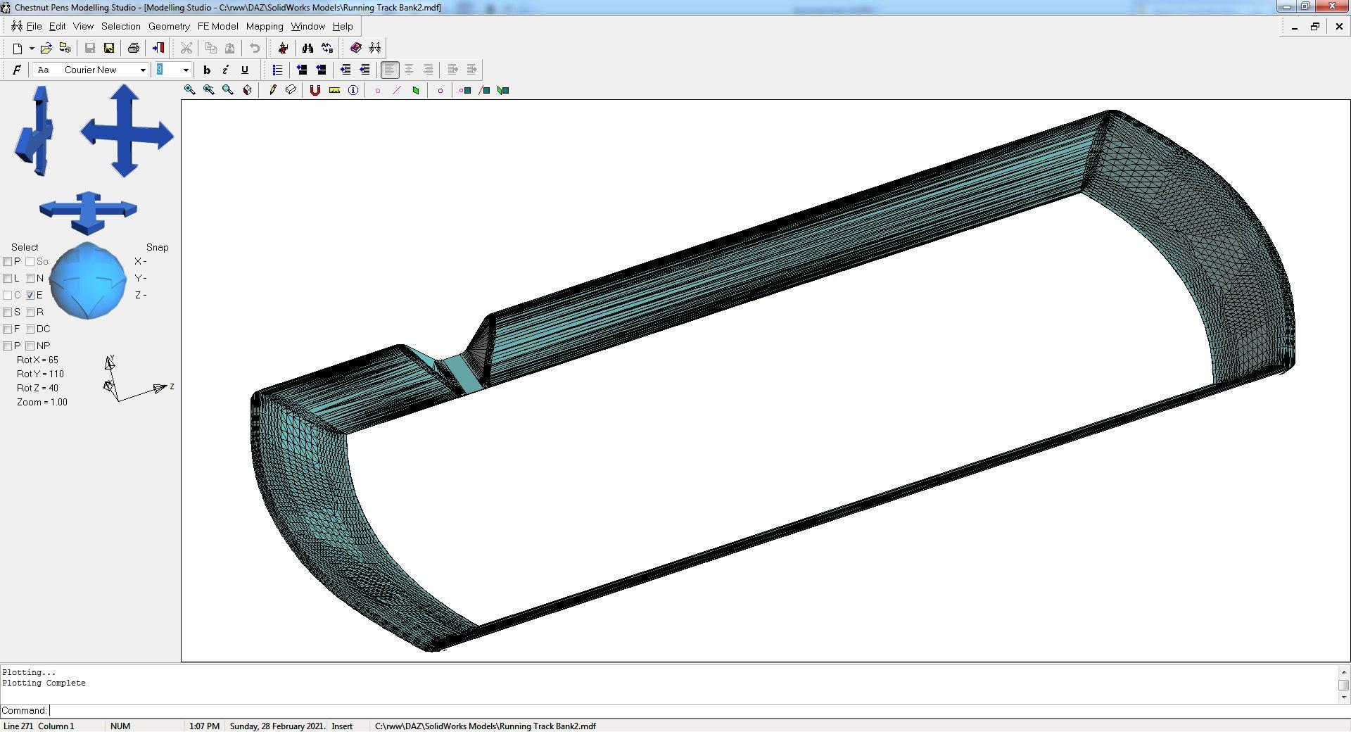

    I've made the central grass area separate from the track, track lines, javelin lines, shot-put lines and discus/hammer lines - makes it easier to texture map the right facets and apply surface groups easily. But due to the shape, and the fact it's come from SolidWorks via STL, it's all pointy triangles going any which way. I'm going to have to replace them with quads where possible.
    I have learnt my lesson from the bank model, cover over all joints where possible and extend faces through others to avoid gaps, even after vertices have been welded. It is a disconcertingly imprecise method of designing things.
    Regards,
    Richard.
    Post edited by richardandtracy on

    Right, I have fired up my modelling machine & got some images off it.
    The first is the whole stadium with its 98+ separate bodies.
    Now  the central grass body.
    Imported into my modeller showing the triangles needed to match the curves on the corners of the track. Diagonally top right in the first image is up/down in my modeller, just to get the orientation clear. It cannot go under the track surface as on a model this size, sometimes iRay displays the grass above the track surface & sometimes below even when the top of the grass is nominally 2.5cm below track level.
    Now re-modelled using the original vertices & whatever new ones needed for the new quads. The cyan arrows showing normals on the edging facets that seem to be needed to prevent a gap being visible where the grass stops. I'm sure a lot of this is only needed because iRay/DS only use floats for vertex position. If it used doubles, it'd be OK. This seems mostly OK, but I have had an inkling that the slenderness ratio of some of the facets may cause problems (around 400:1) & I'll need to re-mesh some of the patches I created. Certainly, if it was FE analysis (which is what I aimed my modeller at when I started programming it in 2004), the model would be catastrophically bad.
    Regards,
    Richard.

  • richardandtracyrichardandtracy Posts: 7,113
    edited March 2021
    I started programming it in 2004 and aimed it at my then Finite Element Analysis system NISA (https://www.nisasoftware.com/) because at the time the modeller (DISPLAY III) was utterly, utterly useless having been designed for Unix in the early 1990's and was simply ported to PC's in a Unix window without development or any Windows features. The native Windows version of the NISA modeller (DISPLAY IV) made the Unix version seem the epitome of speed & grace. After 6 weeks doing stress analysis for an aircraft interior's company I told myself that 'Even I can program a better modeller than that'. Turned out I was right - because for the next 3 years a majority of my income was from subcontract FE work where I modelled faster and got the jobs at a lower price despite a higher hourly rate. I started programming at a time when I was using Poser 4 and AutoCAD LT97 . The result is the thing uses UI ideas from both. You can type every command in, use a menu or navigate around the model with the Poser4 like images. I started programming it in Borland C++Builder 4 which I got on the front of a magazine in 2001, and eventually moved it to Embarcadero C++Builder 10.1 that I actually paid for (a really painful experience). The biggest problem I ran into was that C++ Builder 4 limited the unit code length to 64k lines, so I ended up with 3 units sharing the same header to be able to do it. For the UI navigation balls, I modelled them as 3D objects in AutoCAD, exported as DXF surfaces, translated to Obj and rendered them in Poser4 before putting the resulting bitmaps into the program - quite a palarver.
    Since the FE only days of the program, I've added basic texture mapping and stl/obj import (though the standalone stltoobj convertor I've written is better than the modeller's stl importer) and a few modelling methods like 'Thicken Surface' and 'Offset Surface'.
    Regards,
    Richard.
