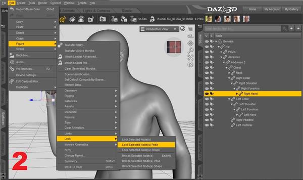

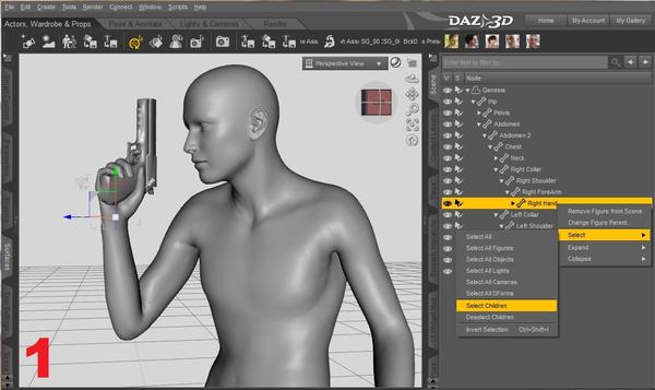

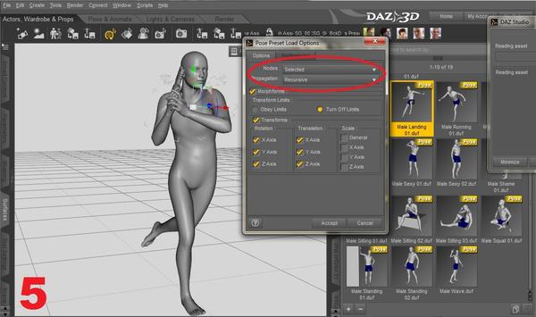

    And really, also, is there a way to lock a body part in place so that it doesnt move even if you make the model pose differently? Like if I liked the way the hand looks in one pose and wanted to keep the hand that way but use the legs of another pose. Is there a way to keep the hand in place?
    There are many different ways to accomplish this, so let's just pick one. ;-)
    So, i loaded a pose where i really like how the hand is holding the gun, but i want to use that with another pose.
    1. Select the hand. In the scene-tab rightclick it -> Select -> Select Children.
    2. Now we can lock the pose of the hand and fingers.
    3. Load the new pose, the hand is still holding the gun like in the first pose.
    The hand will stay in this pose until unlocked again (same menu as in step 2).

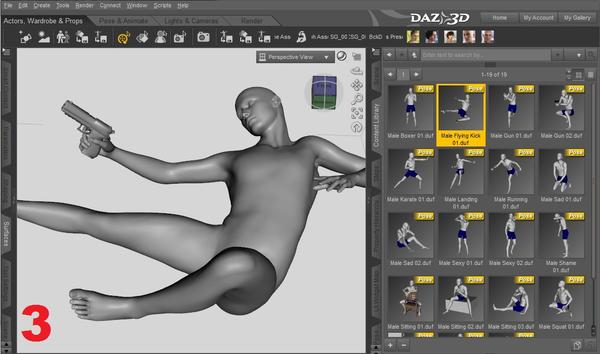

  • BlackFeather1973BlackFeather1973 Posts: 739
    Taking it a step further now...
    I used the previous method to lock the hand with the gun and use this with a running pose i like, but i want to load the arms from another pose.

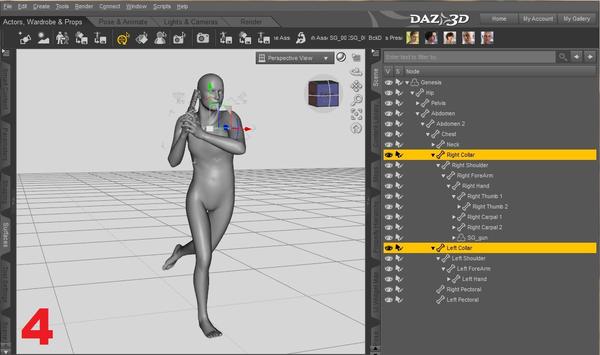

    4. Because I only want to change the arms, I select both collar-bones. These will be the starting points for the new pose to load.
    5. Hold the Control-key when loading the new pose. This will load a pop-up menu with extra options.
    Set "Nodes" to "Selected", this way the new pose will only be applied to the selected collarbones instead of the whole figure.
    The default for "Propagation" is "Recursive", this will apply the pose also to the children of the selected nodes (collar -> shoulder -> forearm -> hand .... etc.). If you set "Propagation" to "Selected", the pose will only be applied to the selected nodes and not to it's children.
    6. Three poses combined. The right hand is still holding the gun because we locked it in step 2.

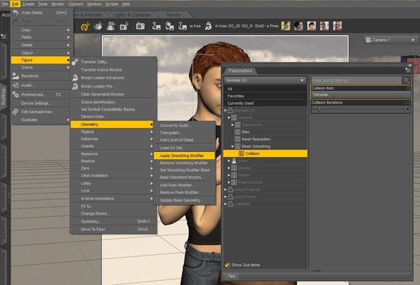

    i will often tweak a pose so that the figures are just touching each other, to the point where they start to 'phase through eachother'. Then i start applying smoothing modifiers and set the clothing and the figures to collide with each other. Note that an item cannot collide with more than one other item.
    You can also use D-formers to achieve such an effect. They offer more control and can give very good results, but i find them difficult to use.

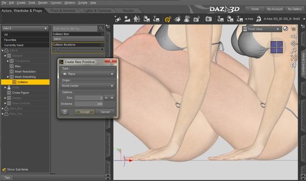

    The collision detection can also be used to have your figure touch a wall, sit on the floor, ...
    Here i created a plane and set the figure on the right to collide with it. The figure on the left is the same pose, but no collision.
    You create these planes (or other shapes) from the menu Create -> New Primitive. Make sure you give it enough divisions, or your figure will not find enough mesh to collide with (although my 200 divisions is probably way too much :) )
    I will often use these planes to simulate walls and floors. You can set them invisible so they won't show up in the render.
    Also, if your figure is holding a prop, you could set the prop as a collision item.
    1157 x 686 - 184K

  • kaotkblisskaotkbliss Posts: 2,918
    Select the item in the scene you want to bend and adjust for collision, then go to edit -> figure -> geometry -> apply smoothing modifier
    What this does is adds a new option in that items parameter to check for collisions with.
    You can see where all this is at in BlackFeather's post above (post #4)
    Yep. You can also go to your scene tap, select your figure or object, and click on the little box in the corner and go to Edit>Geometry>Add Smoothing Modifier.
