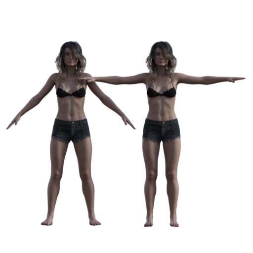

I have recently finished creating a series of G8F poses based on old V3 poses. So, naturally this is the point at which I have learnt enough to write a script that would have cut my time spent doing the conversion considerably.
Anyway, here is a script to do a lot of the conversion automatically. Because V3 had some bones G8F doesn't, and vice versa, the twist in the arms and legs isn't corrected, but foot angle, fingers, arms etc is. You'll be fairly close to the original V3 pose. The script is pretty well documented with comments to describe what is and isn't converted. In the image below, on the left is G8F in the G8F zero pose, and on the right after the script alters the pose to be similar to the V3 zero pose.
Given how few people seem to have V3 poses lying about, there won't be a lot of use for it, but it may save a bit of time if you have a favourite pose that you've not yet converted to G8.
To use. Apply the V3 pose to G8F, then select G8F, and run the script. Finally, correct twist in arms and thighs.
Hope you find it useful.
Regards,
Richard
Edited further to mention a second script lower down this thread that transfers a V3 pose to G8F a bit better than this first correction script.

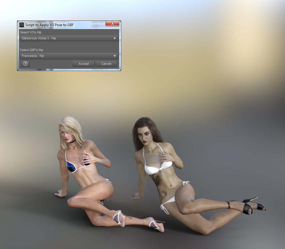

    To operate the second script, select the V3 figure hip using the top selection combo box, then select the G8F hip using the lower combo box. The final operation is to press the accept button, and then sit back and prepare to be amazed. Well, it'd be nice if that happened!

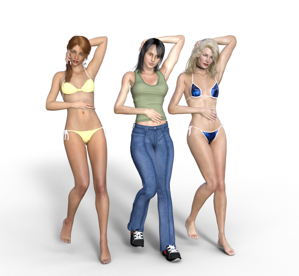

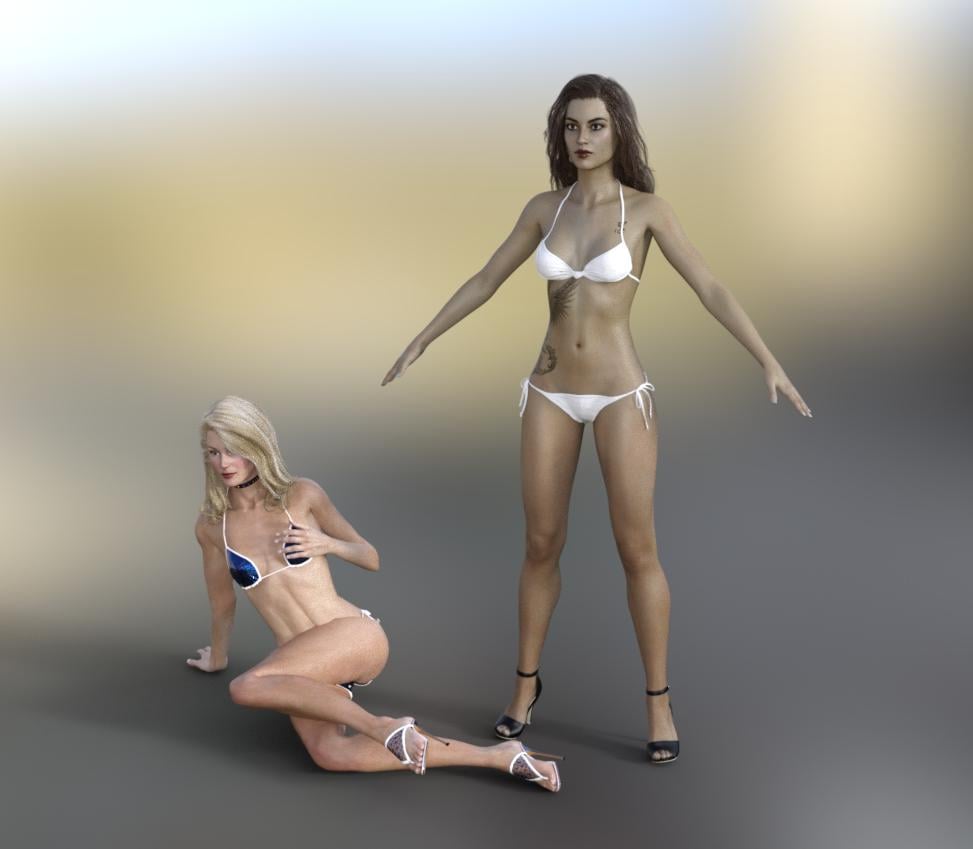

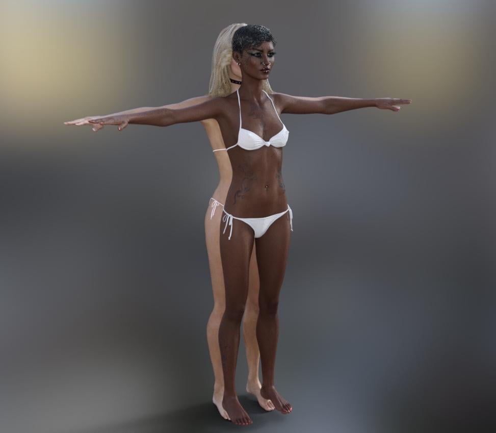

    So, here's what it looks like with the V3 zero pose, showing that G8F is posed reasonably well compared to the V3 character behind.
    Then here is what happens with a more difficult pose: From left to right Noosha G8F, GND2 for V3, and Glamorous Vicki 3. There seems to be an over bend of some of the elbow joints that is not present in the zero pose. Almost as if 20 degrees for G8F is bigger than 20 degrees for V3. But only on some joints. I am tempted to leave that be for user tweaking after the pose transfer.
    Finally, 2 stages of GV3 and FWSA Francesca for G3F converted to G8F. First image with GV3 posed as the reference pose and Francesca in the zero pose. Second image is the after pose. Francesca's hand looks to be too high, but that's partly because her bust is lower than GV3's and partly due to this apparent difference in elbow angle sizes. Otherwise, a few tweaks needed, but a lot less than would be needed to recreate the pose from scratch. Given that the figures are 5 generations apart, use entirely different joint concepts and different bones, I feel the pose transfer is actually pretty good.
