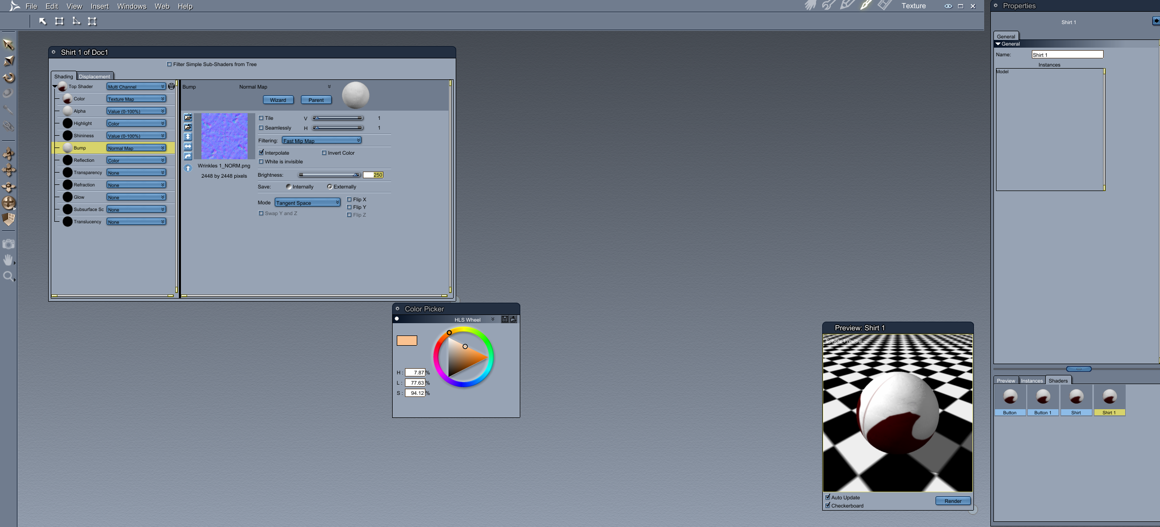

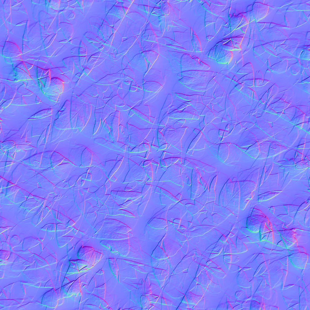

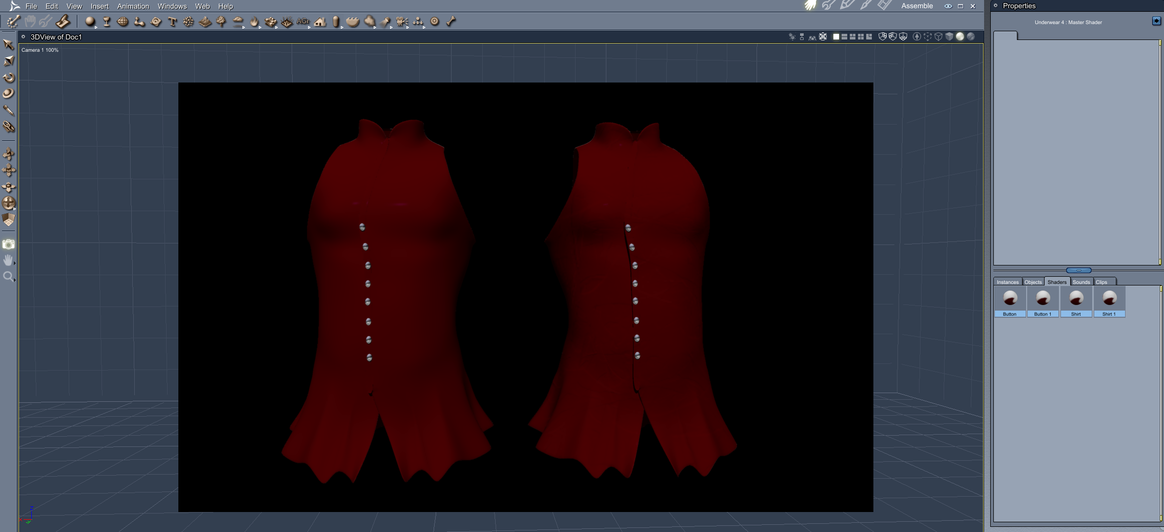

    Just for fun I made a quick wrinkles normal map out of a multiple leaf picture and applied it to a piece of clothing.
    LHS - No Normal  RHS - with Normal (click on image for bigger picture to see difference)
    Shader setup
    Normal map
    1024 x 1024 - 2M
