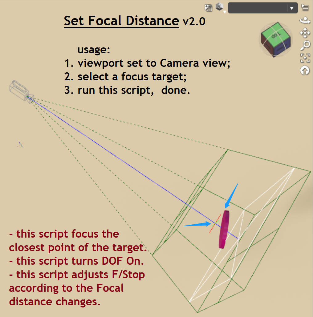

    Ok, this post contains two scripts from ten years ago, @cwichura , @mCasual , shall we renew and combine them?
    Here I tried, combined mCasual's mcjclosestvertex.dsa with cwichura's Set Focal Distance.dsa, to make the life easier. Now user needn't to create and move null, all automatically.
    The usage is:
    1. viewport set to Camera view;
    2. select a focus target; (smaller is more accurate, such like an eye, nose, finger, etc.)
    3. run this script, done.   Will pop up the new Focal distance value.
    This script turns DOF On, otherwise the Focal Distance is meaningless. This script adjusts F/Stop a little bit according to the Focal distance changes for blur effect.
    However, @mCasual , the mcjclosestvertex.dsa seems has problem now, for some bones such like G8 or G3 head, the 'getCachedGeom' thinks it is no face bone. As a compromise, this combined script uses the middle position of those 'no face bone' instead of closest vertex, the result is close.
    Finally, this Set Focal Distance v2 script, plus Cayman Studios' Perspective Control for DAZ Studio which can adjust Focal Length together with camera position, can let anyone to become a camera expert immediately.  Have fun.
