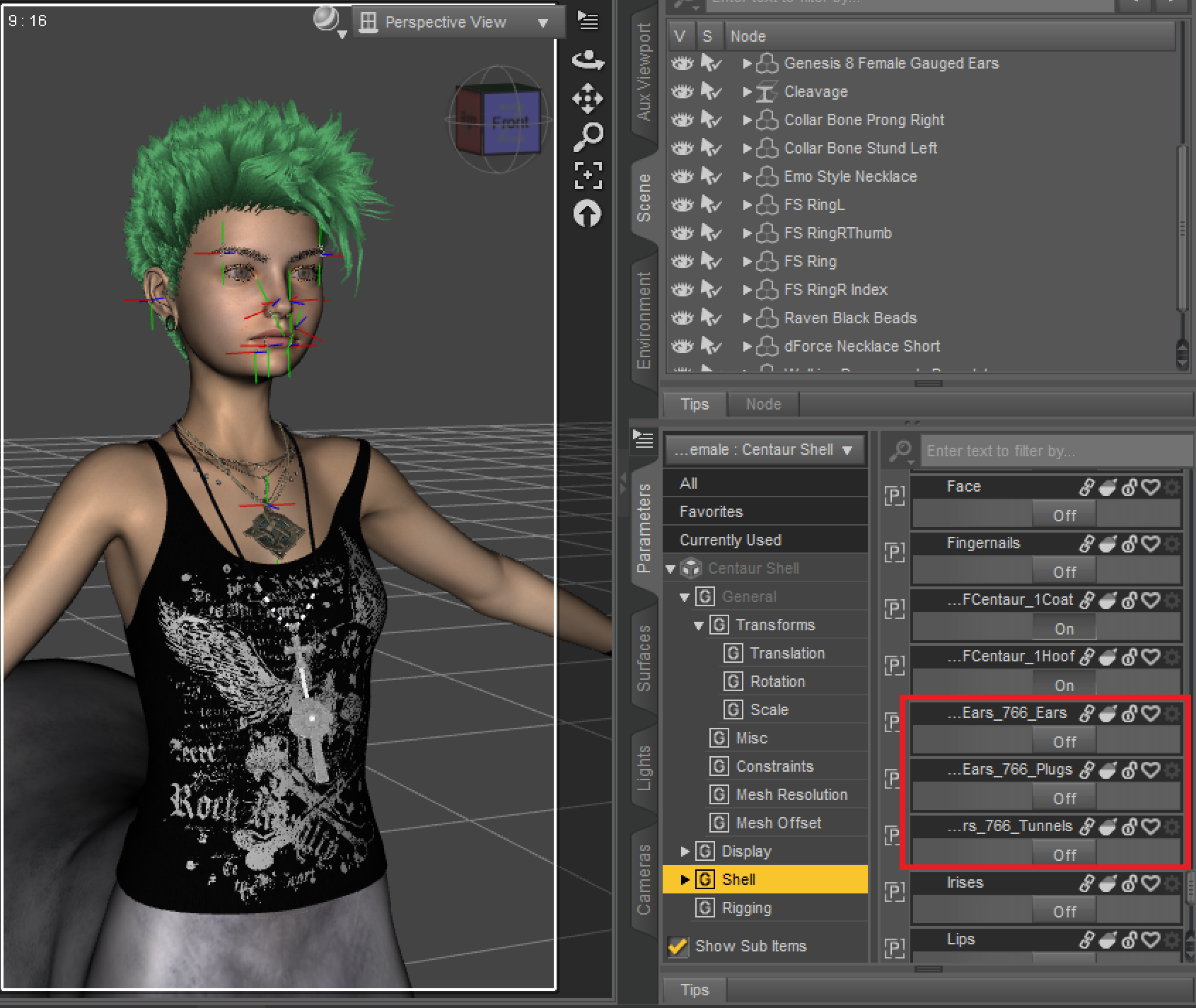

I'm hoping this is the right forum, but I have a question on this product: https://www.daz3d.com/gauged-ears-for-genesis-8-females
I bought this a while ago, and I know it comes with geo-grafted ears; however, I am having a problem getting the ears to match the skin texture of my character. What am I doing wrong? Or more specifically, what do I need to do to get the geo-grafted ears to match the skin texture of the character I am using it on.
Thank you in advance!

    Are you using any other geoshells? Geoshells can conflict with each other, causing that whited-out look. Incidentally, I just had the same issue using this same product on a centaur with a makeup geoshell. Look under parameters for any geoshells you have, and make sure that the gauged ear nodes are set to "off", as in the attached image.

  • @Gordig, Thank you so much!!  That worked!!  I have a character where I want to use the gauged ears! I didn't think about the shells conflicting!
