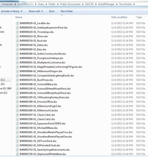

  • JaderailJaderail Posts: 0
    Here is my DIM Downloads folder also set to delete after install. As you see I have dsx files for all installed content. If that file is deleted DIM thinks the file was never installed.

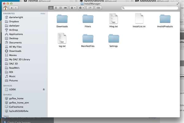

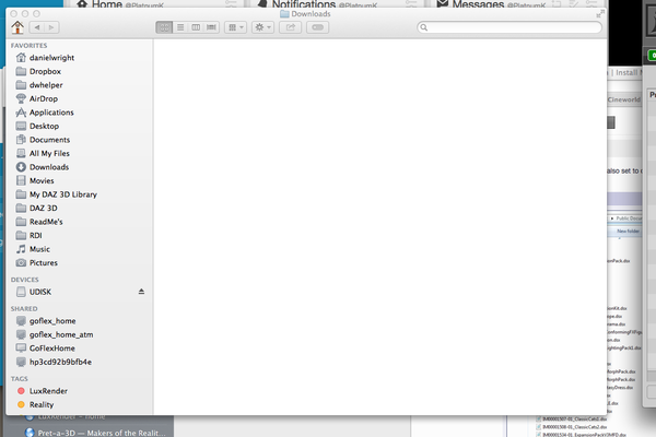

  • PlatnumkPlatnumk Posts: 682
    here are screen shots of before and after install, but as I said I do have a folder called 'ManifestFiles' which is where DIM has put the .dsx files, they are not being left in the 'Downloads' folder

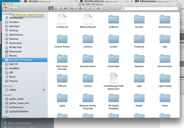

    the file is in the correct place (See screenshot).

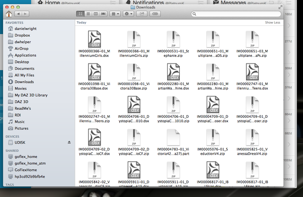

    OK, it just did it again, but if i Copy the .dsx files from the "ManifestFiles' folder and put them into the 'Downloads' folder then every thing works as it should.
    So what seems to be happening is that after installing the packages DIM is moving the .dsx files to a folder called 'ManifestFiles' when they should be left in the 'Downloads' folder.

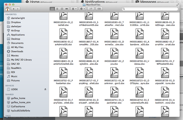

    What is the location of your ManifestFiles folder? Does it contain .dsx files for the installed products?
    the location is
    Users/Shared/DAZ 3D/InstallManager/ManifestFiles
    and yes it does contain all the .dsx files

  • fixmypcmikefixmypcmike Posts: 19,731
    That's very strange, does DIM show the items in the Installed tab or the Ready to Install tab? I hope you're copying the .dsx files and leaving them in the ManifestFiles folder as well as the Downloads folder?
    edited June 2014
    Files show in the 'Ready To Download' Tab & in the 'Installed' Tab

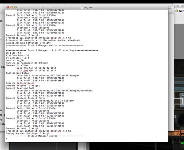

    Does the log file say anything of interest?
    log.txt in the DIM directory.
    The only thing in the log file that I can see is that it there is no mention of the ManifestFiles folder (see screenshot of last log entry)
    951 x 775 - 223K
