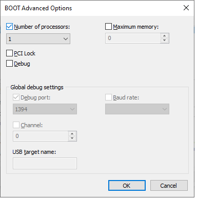

    To force the CPU read
    1. Type ‘msconfig’ into the Windows Search Box and hit Enter.
    2. Select the Boot tab and then Advanced options.
    3. Check the box next to Number of processors and select the number of cores you want to use (probably 1, if you are having compatibility issues) from the menu.
    4. Select OK and then Apply.
    Thats the one I installed was CUDA 11.  I have no idea if that helped or if it was a technical placebo but it did make my card actually sound like it was working when I hit render.
    Also, the CUDA 11 package, it shows up in my Nvidia Control Panel now.  I don't think it was there before.
    Okay, thank you. I've downloaded that huge package [2.5GB], will install it and hope my computer doesn't blow up [jk].
    Wow, it gave me an option up to 12 processors?? Was only sitting on 1, so I upped it to 4. Obviously I'm learning this one as I go along today.

  • Wow, it gave me an option up to 12 processors?? Was only sitting on 1, so I upped it to 4. Obviously I'm learning this one as I go along today.
    sockets 1
    cores 6
    logical processors 12
    So which is the best choice me to put there, 4, 6 or go for all 12? or ?

    @ kenshaw011267 For what it's worth I had looked at some other places about this number of cores being used, so it's good to know not to mess with them contrary to their advice.
    These are 2 pics from my computer, would seem that while I thought I had changed the 1 to a 4, and rebooted the computer. Now it popped up showing still at 1. So I left it at one and now it's saying to reboot the computer? It started at 1. Is that where it should be then?
    The drop down goes from 1 to 12.

    Yo!!! Now it is only saying "1" ... what did I do and how do I get that 12 back? tia
    Got 'em back. Found a nice page over at Microsoft. Apparently nothing should be ticked in that little box and also to be careful 'cause that first general thing before Boot options has a nasty habit of first appearing with the option to start in some very unhelpful right now set up. Almost 'safe mode' but not quite, geez. Anyhow, nothing is broke and nothing blew up :-)

    Glad you got it worked out.  That screen shows you have 1 socket but 6 cores.  I have 8 cores, but initially that screen showed 2 cores, 4 logical cores.  I changed it to 8 cores as it should be.  I know I have an 8 core CPU, my BIOS shows an 8 core CPU, Windows System Manager shows an 8 core CPU... but the Task Manager was only showing my computer utilizing 2 of my 8 cores.  Initially I thought maybe when it maxes out to 100% it'll show 2 more cores or something as maybe an energy saver or something...  However, when gaming, rendering, using Photoshop, Blender, Unity, etc I was finding it would max out, everything would basically freeze....
    I'm talking right clicking on my desktop would take about a minute for the display menu to come up...  After coming from 7 where everything was as fast as thought to not being able to play Java games on Win10, there was absolutely a problem.
    Changed it to 8 cores , now it's displaying 8 cores and the speed is back to what it was before I 'upgraded' to 10.
    Likely the system detected that there was only one socket and wouldn't take your changed setting but this could have forced you to reinstall Windows.
