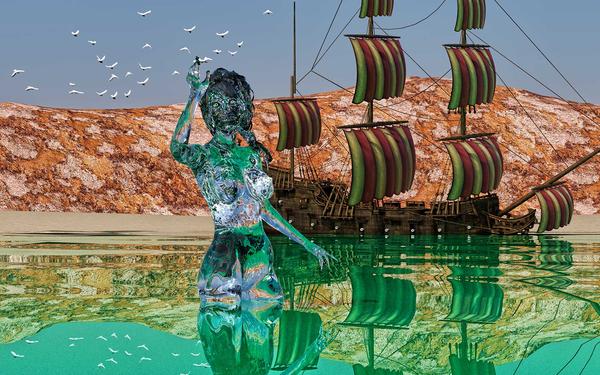

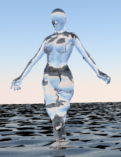

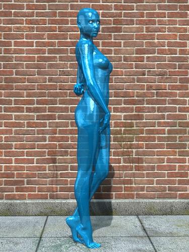

    I did this in Reailty 2.5 using the water surface preset
    1159 x 1500 - 3M
  • TheWheelManTheWheelMan Posts: 1,014
    Valandar said:
    I think the OP means "Make it look like a character is COMPOSED of water", not is manifesting out of a pool or lake...
    Correct, although I am actually envisioning a character made of water emerging from a lake.
    You know, I forgot that Reality has a water shader preset built in. I may have to experiment with that. I also have some wavy water shaders that I can try.

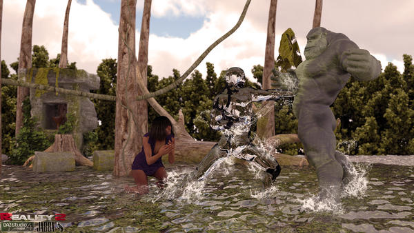

  • TimbalesTimbales Posts: 2,423
    I played with the parameters for the ripple of the water on the mat zones of Genesis, more rippled at the legs, less so up top.
    1159 x 1500 - 3M
  • cwichuracwichura Posts: 1,042
    Reality's water pseudo-material is setting up a glass2 volume with Pope97 data for the absorption of water (when you select the Sea/Pool water option) and a procedural noise displacement map with strength based on the 'Ripple amount' setting. You might have more luck simply selecting glass and creating your own displacement/normal maps, since you'll have exact control over them. Set the IOR to 1.33 to approximate water with a blue tint for the glass colour (or hack the generated scene file to use the Pope97 absorption data).
    While not water, I've done a couple crystalline figure renders with Lux. The principal is the same, just with a higher IOR and clear colour instead of water absorption. See Crystalline Timekeeper 002, for example.

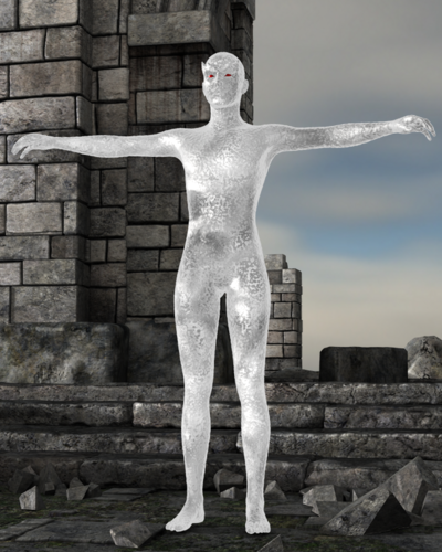

  • JaderailJaderail Posts: 0
    edited April 2014
    Way back in the Past I did this in DS3A with a V4. It is doable much better in DS4.5+ now. I might need to revisit the Idea. This one looks a bit odd to me so I never went farther with the idea. View full size to see the Translucency in effect.

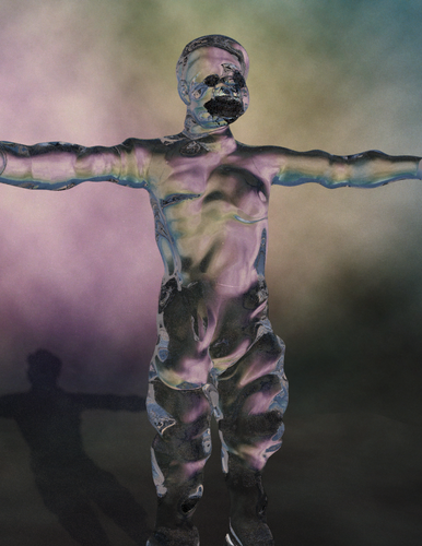

  • kyoto kidkyoto kid Posts: 41,942
    ...been getting close but can't seem to get rid of the tongue and teeth. Can't delete them as that deletes the entire figure.
    ...the shaders I was using (Metallised Glass Shaders) overrode that particular parameter so it wasn't available. I tried flagging them to not appear in the final render but that didn't work either.
    edited April 2014
    Kyoto Kid said:
    Zawarkal said:
    I leave the inner body parts, tongue, mouth, etc at the default daz shader and set the opacity to 0. I think this has always worked for me. Could be instances where not. I do know that some other shader types even with opacity 0 would still render.
    ...again. the shader I am using overrides the opacity channel by removing it from the surfaces tab. Once I apply the shader, the setting defaults back to 100%.Hide ALL except the Inner mouth parts use the Polygon Group Editor to SELECT all the inner mouth parts then do HIDE, turn rest of model back on. Now in Polygon Group Editor do Delete Hidden. Pop no mouth parts, now apply your Shader and save as Scene or scene Subset. You may need to Open the mouth to get at the inner mouth but it is doable this way.

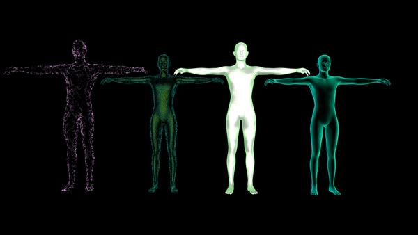

  • XenomorphineXenomorphine Posts: 2,421
    edited April 2014
    The last promotional image on this shader set appears to give a 'The Abyss'-like effect to make figures fluidic.
    http://www.daz3d.com/pweffect
    Anyone tried it? The same vendor's 'pwGhost' was excellent for creating ghosts with, I found (with a specific automated techniques for hiding teeth, tongue and so forth), along with holograms, X-rays and so forth. If 'pwEffect' is of the same quality, I'd be tempted to purchase it, myself.
    I have it and I have even Used it. I have so many shaders I forget which do what.
    Opps I wondered off. Sorry give me a few...
    Here is 4 of the presets that come with it... from right to left is, Crackling Pink, Epileptic Sprit, Gaseous Ghoul and Phantom. And the effects are 100% editable so Water should be easy to set up with time.
