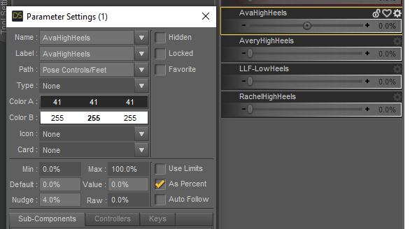

    I seem to have solved this one.
    Under pose parameters, there are two "Morphs"?
    Well, settings AvaHighHeels and RachelHighHeels. Both of thses were set to 100% and each throws the feet into a full high-heeled pose, together, you get the super-tip-toe thing.
    When both are turned back to zero, the feet flatten out and match the intended pose properly. So it seems like the poses don't affect these two added..add-ons and thus.....
    https://www.daz3d.com/rachel-high-heels-for-genesis-3-female-s
    https://www.daz3d.com/ava-high-heels-for-genesis-3-female-s
    The best news from this is that I now have (at least) two (new) morphs (I didn't know I had) to adjust the foot pose manually and will be easier to get the feel pose to match any shoe!
    AND!  I can reverse and flatten out ANY heel POSE. Once I turned off the parameter LIMITS.
    586 x 328 - 37K
    Post edited by Griffin Avid on

  • It's morph in the posing under the foot catagory there's one for either the left foot ot right foot for example "Left Foot Heeled Shoe" "Right Foot Heeled Shoe" just dial it to 0 and you're good. I just came to this page for help and saw what @Matt_Castle had said then i went to the foot catagory and saw the dials the fixed it
    The easiest solution. Worked for me. Thanks.
