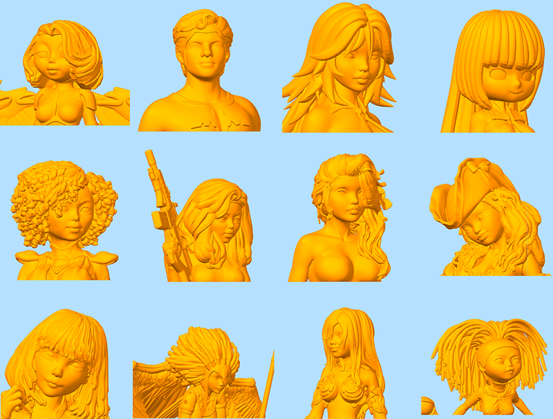

    I would highly recommend you test using the GamePrint plug-in and use their service to prepare your files. At $2.00 a model, I have been very, very, very happy with the hundreds of models I've had them do for me. In the rare instances that it was a failure, it's been 100% my fault. Timewise, I can't justify trying to prepare my more complex models for 3D printing.
    Using their plug-in, pretty much all DAZ hairs will print, with varying results. I like to use the toonier hairs as I find them more predictable, but even complex hair usuallly works well. The thing to watchout for is transparency -- as you're no doubt aware, it doesn't come through in a 3D STL. As a result, some hairs that depend more on transparency might not work as well. For me, I occasionally forget about the skull cap -- often it's very, very minor, other times it means some editing in a modeler, or a little sanding, or occasonally just leaving it is as it actuallly looks like it belongs. Here's a quick sampler of some hair on 3D STLs that have been generated by GamePrint. I normally have my models put through at 3" -- less detail, but if I'm normally going to print larger I prefer things get thickened up unstead of thinned to non-existance. In the sample, you can see at least three models where the skull cap is present. If you have any particular hairs you're interested in seeing how they come out, let me know and I'll see if I've used them yet.
    800 x 606 - 1M

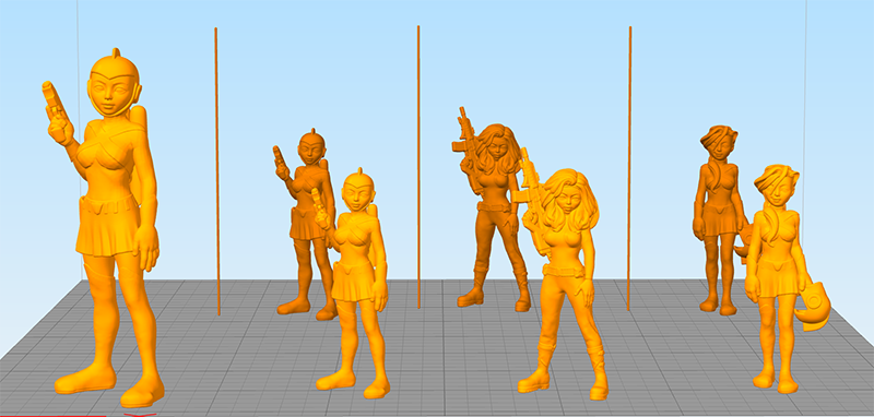

    I had similar issues printing characters to the same scale when some were standing and some were sitting or kneeling — Gameprint picks the largest dimension and creates the STL at either 3, 7 or 12 inches (the sizes offered for STLs are different than those for printing). I was creating a small set of “reading fairies” for for my wife for our library and I printed the first one standing and reading, which was perfect at 3”, then the second was sitting cross-legged and reading but when I went to print it, the scale was quite a bit larger than the first. A 3”-high standing figure is smaller in scale than a 3”-high sitting figure. For me, the exact scale wasn’t that important, but since PLA is cheap I placed the two figures in the slicer software and eyeballed the scale of the sitting figure until it matched the standing one (I did this by superimposing them and scaling the sitting figure until the heads matched in size). Obviously that’s not going to work for exact scaling, especially when there may be characters of different heights to begin with and also in widely various poses. The second problem is that even if you took the 3” STL (the closest size offered to 1/72, assuming a 6-foot figure) and printed it at 33.3% (taking a 6-foot or 72-inch height character to 1”, for example, your 1/72 scale) things start to disappear. I accidentally had one of the reading fairies prepared by GamePrint at 7” and scaled it in the slicer to 3” to match the others. My wife wanted to know where their clothes went. Scaling the STL from 7” to 3” made most of the clothing too thin to print. The same thing happened to a 3” prepped figure I’d made for myself with a jet pack that I wanted to print as a 28mm figure for gaming — the jet pack disappeared because the walls of the jet pack were too thin, much like the clothing of the fairy (even though I could see them clearly in the slicer or a 3D program). I got around this issue by creating a 72” extruded cylinder in DAZ Studio, which I add anytime I need something scaled exactly. The cylinder is added to the character’s node so that it’s seen as part of the figure, but I keep it a slight distance from the character. If I need a character or prop printed at 1/72” scale, I would make the cylinder 3x taller, then send my model to be fixed at 3-inches high, which would prep a 6-foot standing character to 1-inch, or character or prop to 1/72 scale, regardless of the character’s pose. Once I have the STL from GamePrint, I pop into the free program Meshlab and delete the cylinder. (takes less than a minute).
    As mentioned, I'm a huge, huge, huge fan of GamePrint's service, and thanks to them I've printed over a thousand items in the last year and have been very happy with the results (I only got my first 3D printer last September, so it's been just over a year).
    Below is a shot from inside the slicer (I'm using Simplify 3D); all the models were prepped by GamePrint at 3" in size, the far-left character is still 3" in the slicer, the other three characters were scaled to 2" tall (back row with cylinder, front row with cylinder removed). What's important to note that without the cylinders, the three front-row scaled characters wouldn't be the same scale. The character on the far-right would be "normal", the scaled character on the far-left would be scaled slightly-smaller (the fin on her head would count towards her 3" height, scaling her down a little) except that the hair on the far-right character is roughly the same addition to the overall height, and the middle scaled character would be scaled quite a bit smaller (the top of the raised gun would be counted as the top of the 3" height, scaling the character down considerably). With the cylinders, they're all the same scale. If I scaled the full-3"-figure down to their size or smaller, her skirt and jet pack disappear in the final print as the thin walls of the mesh become too thin to print (you might have better luck with your resin printers -- in fact, you definitely will). I've added a second image to show the three scaled characters and how they'd be if I hadn't added the cylinder.
    Hopefully, that helps a little without making things too confusing. Adding the cylinder to control scaling, doing the math to control the scale and removing the cylinder after the file's been prepared really only takes a couple of extra minutes, total.
