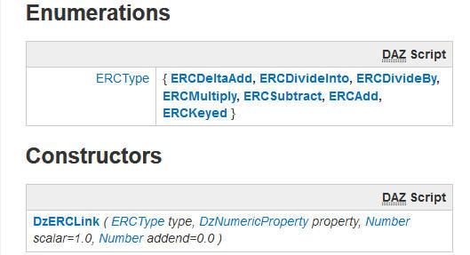

    So I tried a different constructor (sidenote: yours isn't listed in the documentation)
    	oERCLink = new DzERCLink( ERCDeltaAdd, oProperty1, 0.5 ); //Set up the controller	oProperty.insertController(oERCLink); // Set the slave
    My script errorss and the log file gives me...
    WARNING: ReferenceError: Can't find variable: ERCDeltaAdd
    I just cannot work out how to use the ERCType enumeration ! (Yes,I'm very rusty)
    Obviously not just ERCDeltaAdd. Nor does it appear to be ERCType.ERCDeltaAdd (that appears to be the Java jive)...
    I've rummaged around in the DAZ Script basics to no avail. I've Googled 'qtscript enum' and  'ecmascript enum' and that just confused me even more.Anyway, here' are the relevant bits of documentation:

  • Richard HaseltineRichard Haseltine Posts: 112,037
    Try DzERCLink.ERCDeltaAdd - the enumerations belong to the object, they are not globals.
  • 3dcheapskate3dcheapskate Posts: 2,732
    yesyes  Thanks again Richard !
