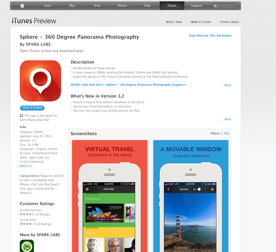

this looks interesting
https://itunes.apple.com/us/app/sphere-tourwrist-360-degree/id335671384?mt=8
- but i don´t know if it makes sense?!?

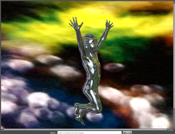

    i´ll post an extra screenshot just for the case i didn´t make clear what i am looking for
    thanks

    just realized that the app is just a viewer - not a camera....
    any ideas?

    so.... this is what i have so far
    576 x 595 - 259K

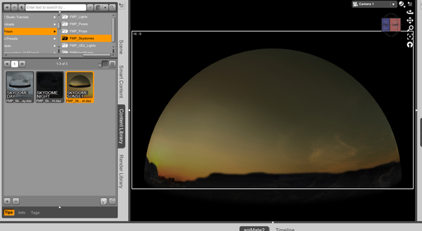

    one more thing... have you got an idea how i can make the background (the sphere itself) invisible in render
    i just want the reflections but not the background itself...
    it would also work if could get and alpha channel just of the object
    what i do right now is i render it with and without sphere and than i put the alpha from the image without background
    (and without reflections) on the other one with the whole shebang and have my mask than... but this is maybe an extra step?!?
    any ideas?

    Select the sphere, go to Surfaces (Color) tab in Editor menu/mode select the sphere, switch to Presets menu (upper left corner) - Shaders and double click !UberSurface Base to apply it to the sphere. After applying ubersurface, switch back to editor mode and near the bottom there should be a field called Fantom with on/off switch. Turn that on and the sphere wont render but will still "cast" reflections.

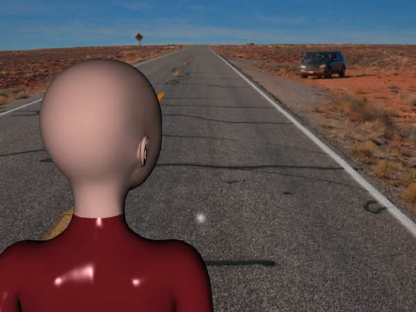

    Wow amazing tips! This means one can basically make his own skydomes and IBL lights :-)

  • octobusoctobus Posts: 117
    thanks everyone... works perfectly... great!
