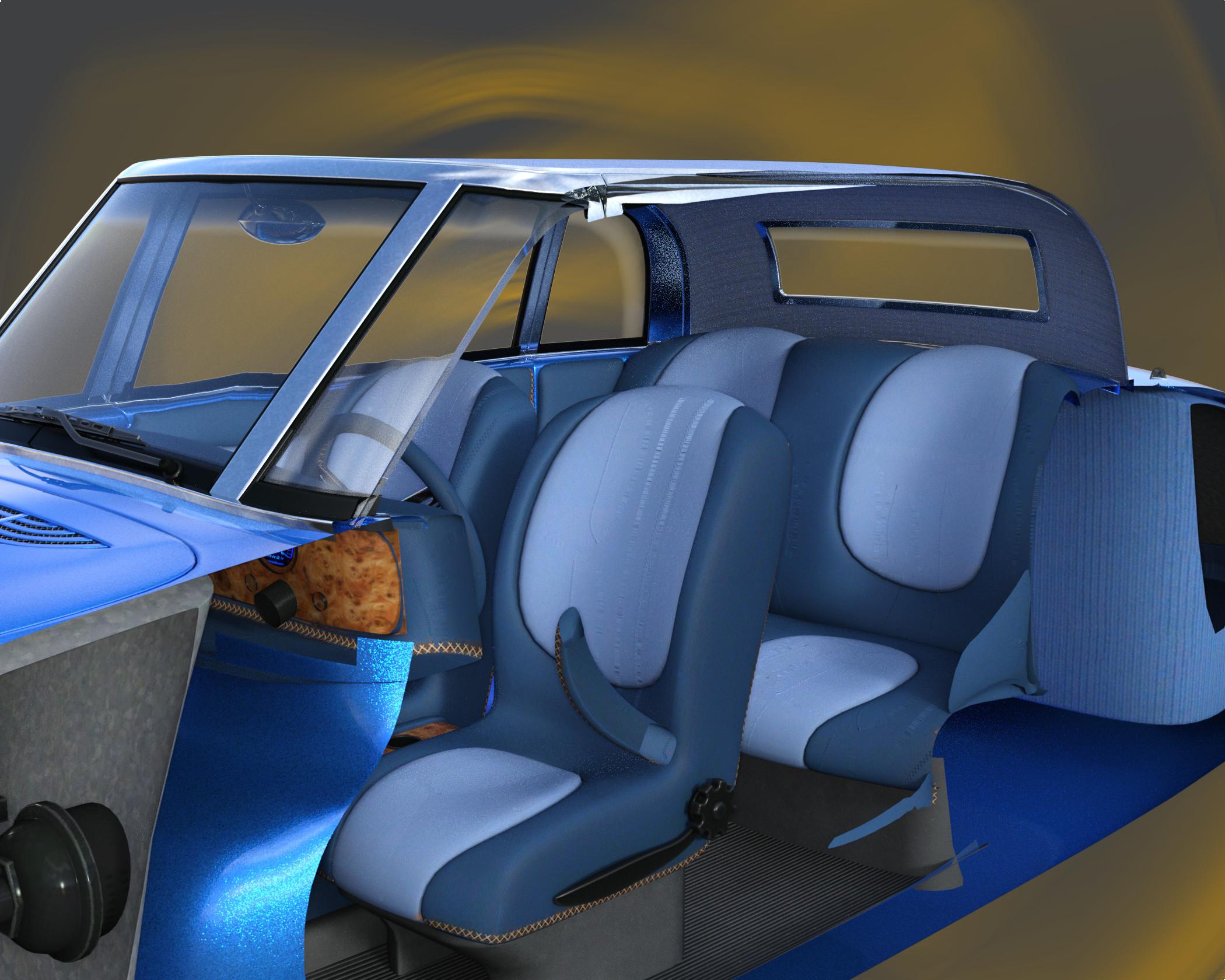

    I hadn't thought of Iray section planes (Create -> New Iray Section Plane Node), but that would be the quickest and easiest way to chop off the side of a car during render time. You don't have to fiddle with opacity settings and rolling down windows/opening doors to fool with the car.
    Everything "above" the plane gets chopped out, so keep that in mind when positioning. You just rotate the plane so the "top" of the plane is the dividing line for the chopper.
    You could use a Primitive Plane object (in the same spot as the Section Node) to help position where the plane will chop things out of view.
    CHOP! (terribly placed camera to illustrate the section plane technique)
    2100 x 1680 - 766K
    Post edited by The Blurst of Times on
