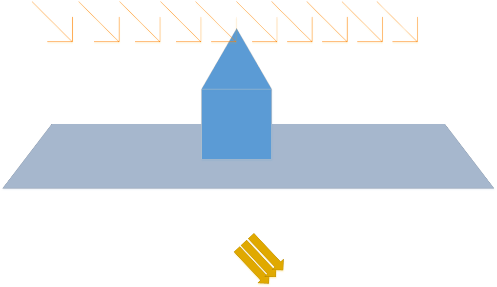

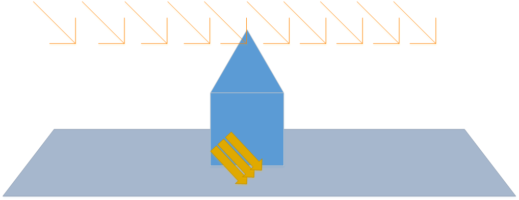

    Distant Lights in 3Delight don't work that way.
    When you place a Distant Light, it creates the little 3-arrow icon. The location of that icon does not matter in regards to how the light is actually added to the scene. The light cast and considered by the 3Delight rendering engine is calculated as being from the same angle no matter where the object for the light is located in the scene.
    I can move the light object to the far left, and I still get universal light across the entire scene.
    Heck, you can even move the objet BELOW the scene and as long as the angle of the light doesn't change, it will still cast light (and shadows) in the same direction.
    I suspect if you are not seeing this behavior, then you are not using a Distant Light, but rather a Spotlight or something like that.
