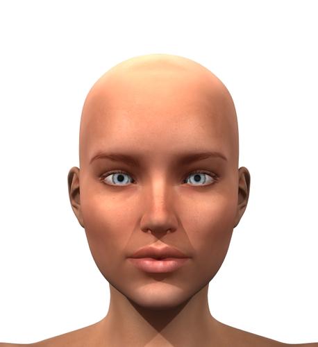

What is the deal with the V6 Belle skin and the red glow that always seems to be seen at the face in render? I don't like the way it looks and I would like to know which map or dial is the one creating it.

    I am tired but there is something you can do to fix it, in the surfaces for teeth, gums, mouth and tongue there should be something called "Group ID" near the subsurface stuff, change that to a different number than the one that it is currently. That should fix it. I have done it a couple of times and it seemed to help.
    Yes, the 'lightbulb head' effect.
    You can fix it by using the normal non sss maps, or tweaking the lights to minimize this look.
    I don't always like the sss shading effects, although I know they are popular.

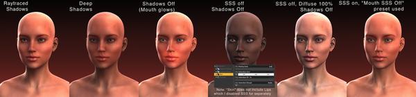

    The quick thing to know is that Puntomaus is right that the Belle Mouth NO SSS preset will reduce the red face. But here's a hopefully useful illustration of various options to see something more about what's going on.
    V6 Belle loads with AoA SSS active, and very "realistic" settings. AoA subsurface can work with both Raytraced Shadows and Deep Shadows (raytraced works better), but it needs some shadows, or it's going to give you the glow face. Shadows need to be active for every light-emitting light that hits the figure.
    The lighting setup I'm using here is very much like the one described in the DAZ promo light tutorial DAZ_jared put here - two distant lights, two spec lights, and UE2 with an HDR map. The only thing I change with the lights from render to render is the shadow settings, and the only thing I change with the surfaces are the SSS settings and the Diffuse setting.
    Far left is default V6 Belle with raytraced shadows on the lights. Then, moving left to right, Deep shadows with same surface settings, then No shadows with the same surface settings, where we see the red face effect, then with SSS toggled off for all skin (Note: also lips must be turned off on their own, the helpful "skin" surface group does not include the lips, since they often have different spec settings, etc.). She looks like a zombie here because the the SSS is realistically replacing a portion of what is usually handled by diffuse. Diffuse in Belle is set by default to 50%. So in the next image, also with shadows still off, I've restored Diffuse to 100%, so she behaves now like a typical skin surface with no SSS. The last image uses the "Belle Mouth NO SSS" preset that Puntomaus mentioned, which compensates to reduce glow effect when you are rendering using lights without shadows. I don't think this is really a proper way to go, but in a pinch that will get rid of it.
    I love the results achievable with AoA SSS, and I've been adding it to all my figures now, though it does take time. Anyway hope it helps.

    It's interesting, Belle's group IDs are setup fairly well by default, I think: eyes and teeth are different, though tongue, inner mouth and gums are the same group as the rest of the body. As long as you are using lights with shadows, it's fine and makes sense. Although I'm intrigued by what you're saying, DimensionTheory, about the eyes interacting through the lids, that makes sense to me too. And that's a lovely render, BTW.
    What the "Belle Mouth NO SSS does", I now see, is change the gums, inner mouth, teeth, and tongue from using the AoA to using ubersurface. So I sort of think the fact that that reduces the red face may be an accidental consequence - it excludes them from the SSS calculations because they're just a different shader now, much like Hellboy's recommending changing group ID would have separated them from the body's calculations. In my mind it makes no sense to use SSS without shadows, so I think the preset is more about just not using SSS on the mouth/teeth than about the reducing the glow effect. I see it as, you reduce the glow effect by either using SSS with proper shadows, or else you turn off SSS.

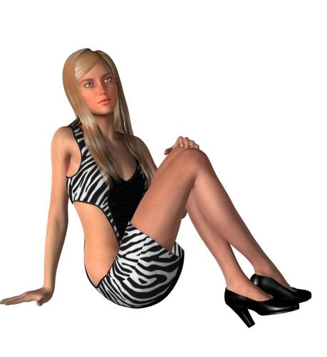

    Well, I tried what Storypilot's explained and I think I finally got what I wanted. The image below is V6 with a very simple setup of a UE2 Sphere with Intensity and Intensity Scale at 50%, and two Spot Lights: a 75% Key and a 25% Fill. Though, I think its bit of a shame that in order to make it look right without the NO SSS option you HAVE to have raytraced shadows. It's almost as if the skin requires that you don't use anything but a high quality professional lighting setup to render it with...

    Hmm, I think it's still glowing quite a bit, but not as much as the original one. :/

    I think that's just because of the way I have the spot lights pointed. I have each one pointing down-ward 45 degrees at the base figure. But you can tell that from the evident shadow mustache she has. :lol:
