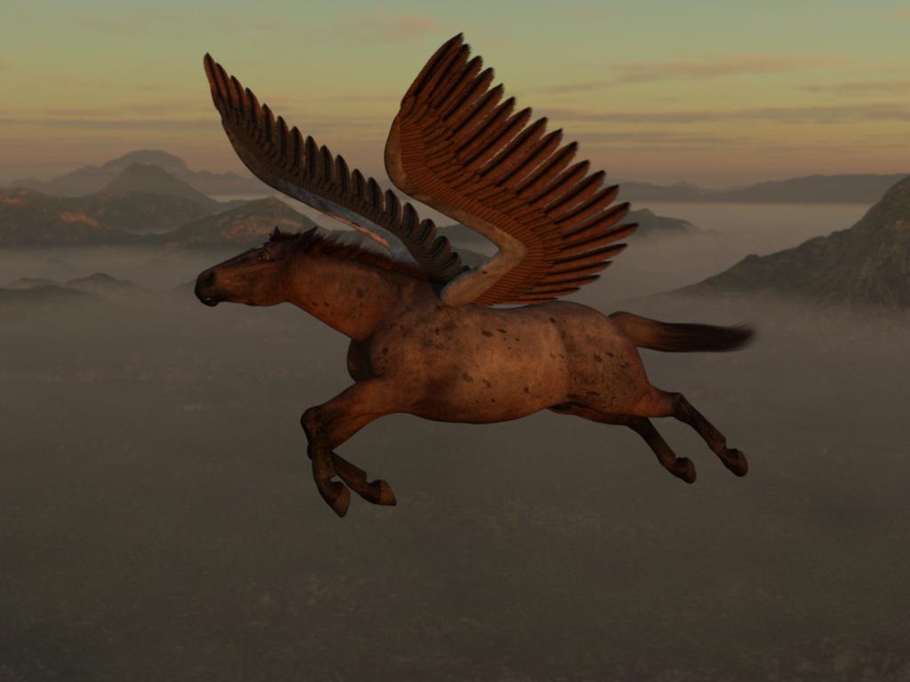

Any ideas/tips on why the textures on "Griffin Wings for DAZ Horse 2" are not mapping correctly?  This is just the default bay material

    Thank you for the info, My settings match yours exactly but I still get the wierd texture on the wings. Are you rendering in Iray or 3Delight?  I noticed it works just as expected in 3Delight but looks wierd in Iray (see attached image)

    I've tried everything I can think of and kept having the same problem.  Does "midnight_stories" ever look at these forums?  Anyone  eese have ideas on how to fix this or are you experiencing the same problems.  I am using the latest version of DAZ Studio.  Any help would be greatly appreciated.

    Here's an Iray-ed Hancock Roan showing off his wings:
    1024 x 768 - 356K
    Post edited by MelanieL on
