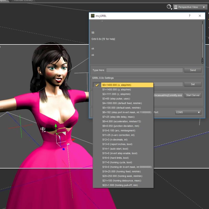

mcjGRBL - Control G-Code Devices From Daz Studio - mcjGRBL2 Marlin Laser
mCasualmCasual Posts: 4,607
edited May 2018 in Freebies

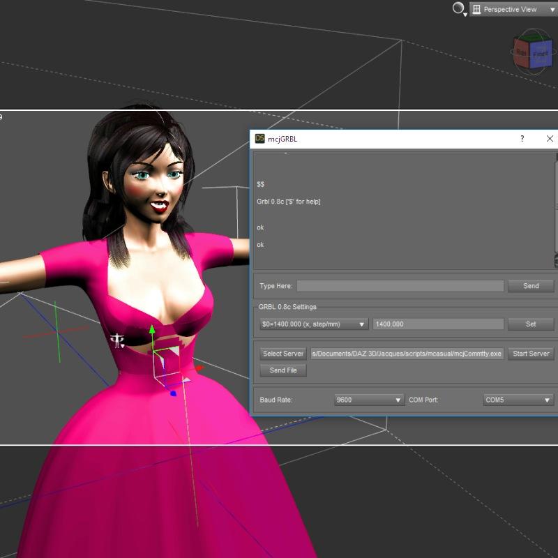

this is mainly for techies
it's the basics (PC only) needed to communicate with serial devices
there's a version called mcjTTY which is a simple terminal, much like arduino's "monitor"
the GRBL version adds some GRBL-specific features (not much but it saves time )
https://sites.google.com/site/mcasualsdazscripts9/mcjgrbl
1920 x 1080 - 450K
800 x 1067 - 197K
800 x 800 - 97K
800 x 800 - 82K
800 x 800 - 107K

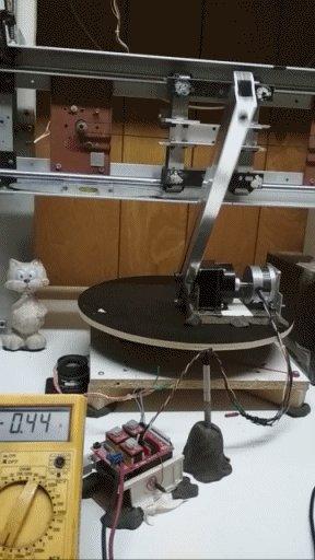

  • mCasualmCasual Posts: 4,607
    edited February 2018
    there will probably be a version for 3-degrees of freedom robot arms
    4160 x 3120 - 1M
    Post edited by mCasual on

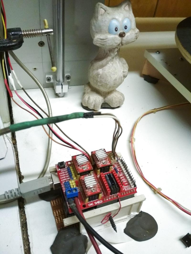

    i used this grbl file for this demonstration
    G0 Z0G0 Z2.5G0 Y4G0 Z0G0 Z2.5G0 Y0G0 Z0G0 Z2.5G0 Y-4G0 Z0G0 Z2.5G0 Y0

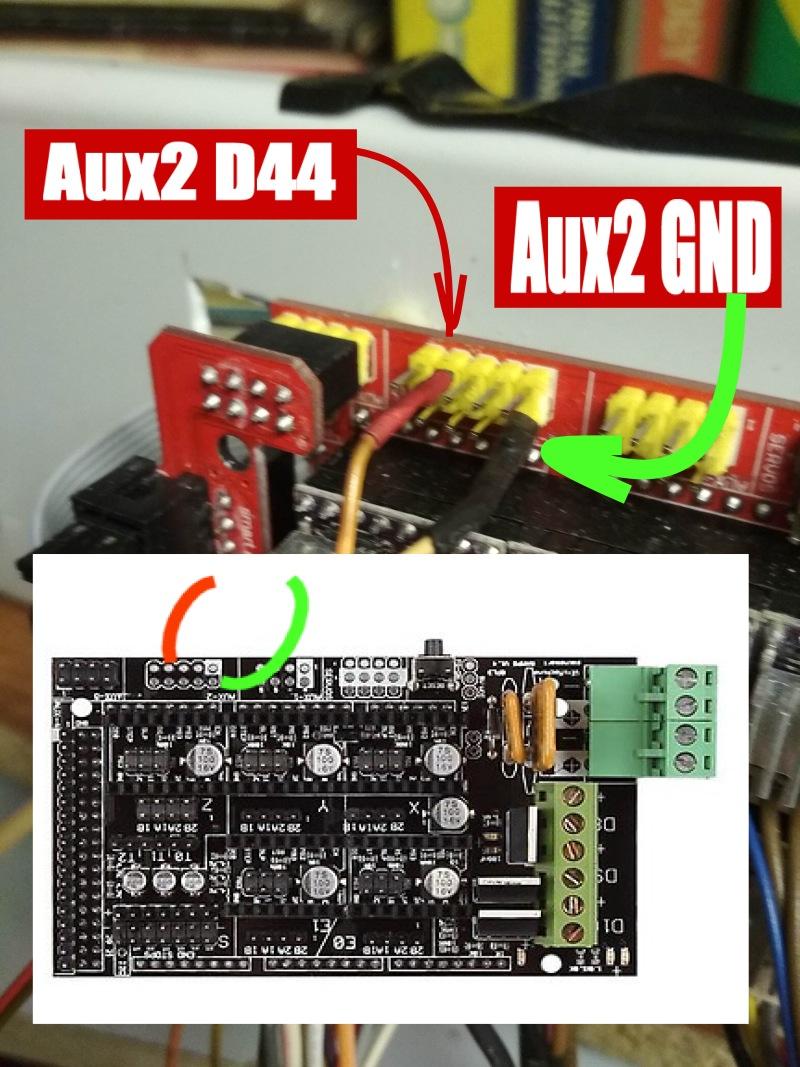

    edited May 2018
    UPDATE UPDATE
    i posted mcjGRBL2 - Which is a version that works with the Marlin firmware
    and i posted info on how to make a laser on/off TTL input controlable by Marlin
    https://sites.google.com/​site/mcasualsdazscripts9/mcjgrbl2

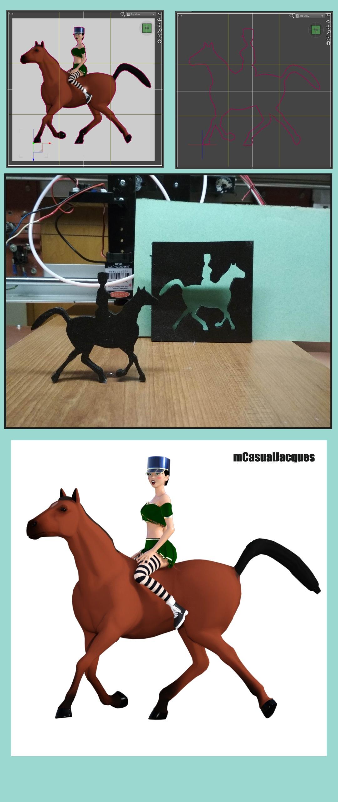

    edited May 2018

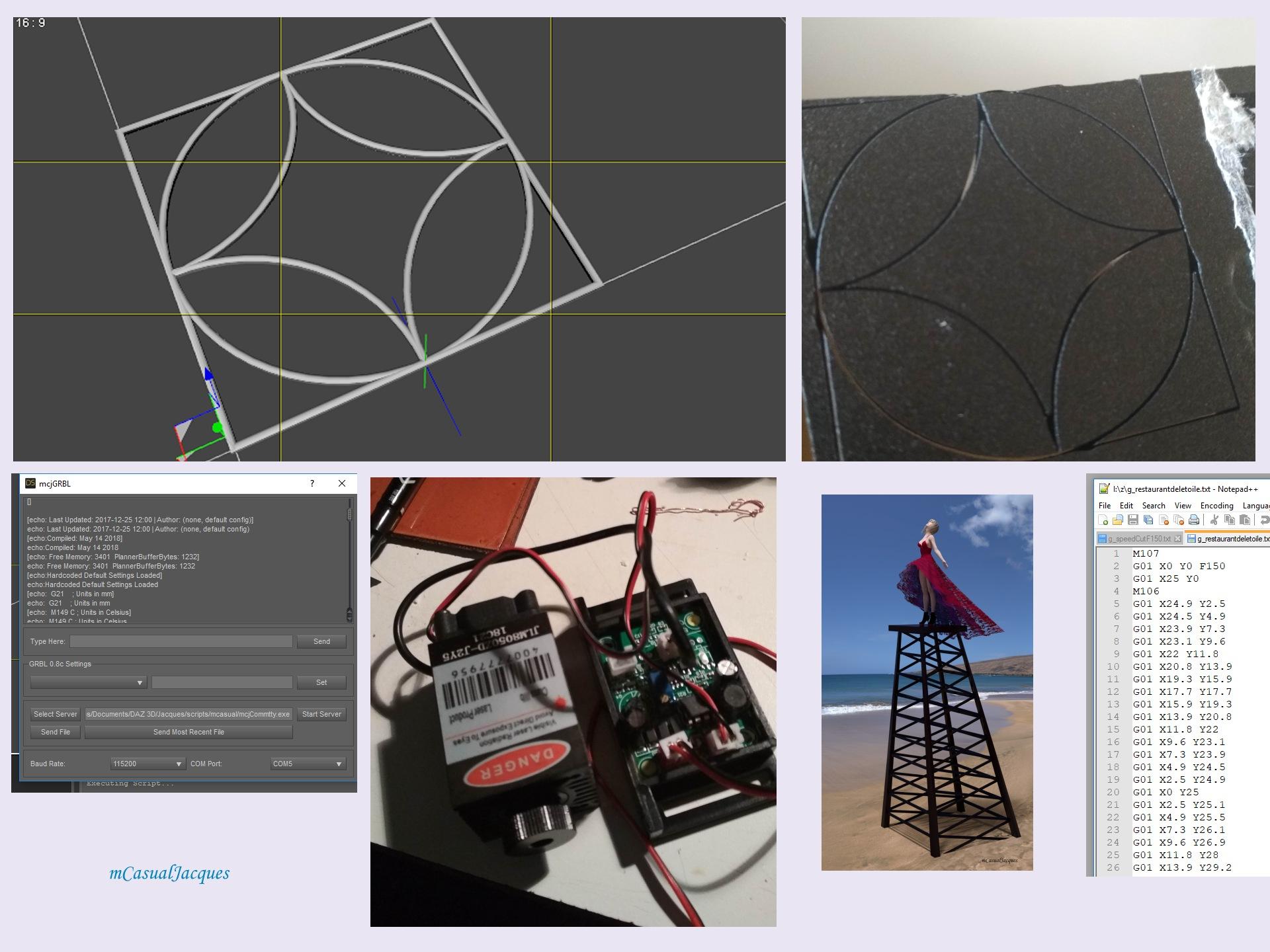

    UPDATE UPDATE UPDATE mcjGRBL2
    which is a Daz Script that lets you send G-Codes to devices attached to a COM (usb) port
    ( Only tested on a Marlin + Ramps 1.4 + Arduino Mega machine,
    but should work for other G-Code 3D Printers, CNCs and Lasers
    that issue an "OK" after each accepted command
    https://sites.google.com/site/mcasualsdazscripts9/mcjgrbl2
    May 18th 2018 12:36 AM - New version reacts correctly to Marlin's "Busy" messages
    by ignoring them and waiting for the OK from the previous command before sending a new one
    Here you can see a cutout ( g-code file ) that was succesfully sent to my laser cutter !
    1080 x 2560 - 376K
