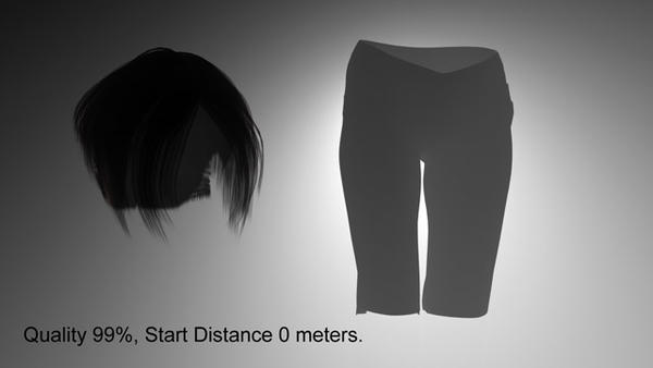

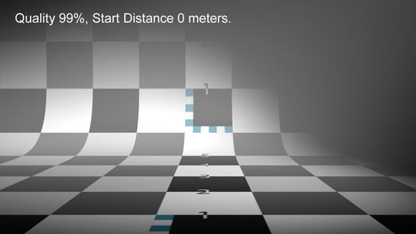

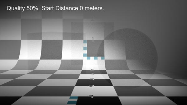

    No, there has not been an update though the issue has not been forgotten. The cameras do work in DS 4.5 but the issue with the volumetric camera showing transparent objects slightly darker or lighter than they should be is still there. It is a very puzzling issue and, so far, I have not found a solution.
    The only thing I can recommend at this point is to set the Distance Start setting in the Volume camera to 0 and increase the quality as it lessens the inconsistency. You can virtually eliminate the transparency problem by adjusting those 2 settings.
    Honestly, the fact that the quality setting affects the strength of the volume inside transparencies proves to me something is not working quite right. Unfortunately the code to correct it has eluded me so far.
    Here are two possible ways to lessen the issue.
    Solution 1: Set the Volume Distance Start at 0 and the quality to 99%
    Solution 2: With lower quality settings, turn off the limits on the Distance Start Parameter and set it to a value slightly less than 1. In my tests a Distance Start setting of -0.25 Meters worked the best when the quality setting was at 50%. A Distance Start at -0.42 gave the best results when the quality setting was at 10%.
    The lower the Distance Start setting the brighter the fog inside transparent objects became. So if you are using a low quality setting and your transmapped objects are too dark then try setting the start distance to a small negative value. If they are too bright then try increasing the start distance a little bit.
    Solution 1 gives the best results but does take longer to render. I'll post some examples from my tests.

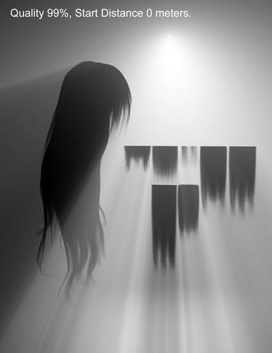

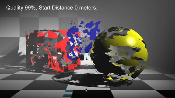

    I did do additional tests with transparency maps and my results were the same where setting the Distance Start to 0 and the quality high eliminated the problem with transparency. Also using the second method of setting the Distance start to slightly lower than 1 when using lower quality settings helped lessen the issue too. All these tests were done in DS 4.5.
    Just to be sure I did a few with a bright light behind the transmapped objects with and without shadows. Here are some examples of the high quality tests.
