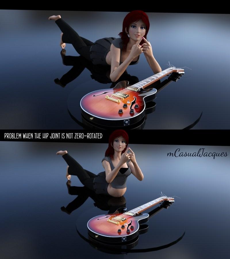

The repair
by "repaired" i mean the animation/playback range functionnality was repaired
in version 2, i memorize the orientation of the head before applying the spread
because ...lets say there's no keyframes on the abdomen node,
at frame 0 i apply the torsion-spread, which modifies the abdomen orientation
... for the whole animation range !!
... which corrupts the head orientation for the whole animation range
800 x 800 - 107K
800 x 800 - 142K
Post edited by mCasual on

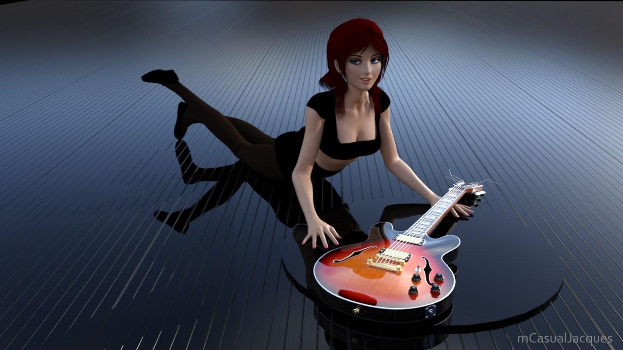

  • mCasualmCasual Posts: 4,607
    edited August 2017
    here's the first test of the fix
    before computing the Torsion-Spread,
    the script notes the rotations of the hip node for every frame
    then it zeroes the hips rotations for every frame
    then it computes the abdomen-chest-neck-head Torsion-Spreading rotations
    then it puts the hip rotations in their initial rotations for every frame
    1920 x 1080 - 204K
    edited August 2017
    tada i solved the puzzle
    1 - memorize hip orientation
    2 - zero hip orientation
    3 - compute torsion-spreading rots for hip, abdomen, chest, neck, head
    4 - apply initial hip rotation multiplied by new hip rotation
    5 - new coffee
    6- upload the new version ( v3?) to my site
    1280 x 720 - 159K

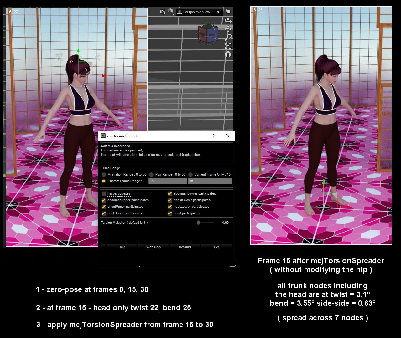

    edited April 2023
    i'll try it on genesis 8
    the basics is that it takes the rotations of the head and divides it between the other nodes of the trunk
    usually i don't checkmark the hip, so it doesn't participate in the torsion spreading
    in some cases the rotation limits of the trunk nodes can be an issue, meaning that the script applies a
    rotation of 25 degrees on a trunk joint but the limits ... limit it to 15 degrees ... so the pose doesn't make the final head orientation the same as it was before mcjTorsionSpreader was applied
    ok ... testing on G8 ..
    1 - zero-pose at frames 0, 15, 30
    2 - at frame 15 - head only twist 22, bend 25
    3 - apply mcjTorsionSpreader from frame 15 to 30
    seems to work as expected
    note: since nothing was keyframed between frame 0 and frame 15
    we now have G8 starting in a zero pose staring straight ahead at frame 0
    and all the trunk nodes slowly moving to the new pose at frame 15 ( the pose set be mcjTorsion Spreader )
    since initially there were no keyframes from frame 15 to 30, we start at frame 15 with our torsion-spreaded pose
    and one frame after the other torsion spreader applies the de-torsioning based on the pose at the previous frame and the pose at frame 30.
    All this to say that depending on the way the figure is keyframed, the result may be unexpected.even if mcjTorsionSpreader did what it always does
    two ideas to improve mcjTorsion spreader
    1 - add a "smart-mode" - in this mode, the script memorizes the head positions for each frame (even the non-keyframed frames) before applying the de-torsioner
    2 - add 3 checkboxes to enable/disable use of the bend/twist/side-side rotations of the trunk nodes
    note if you want a figure to look behind her back, the limits of each trunk node wont allow the torsion-spread to work, so you may want to turn limits Off of those joints, use mcjTorsionSpreader, then readjust things that would hurt your figure's spine
    in the (very mean) meantime, one could use mcjDecimate or mcjDecimateEx or even bLooper to keyframe every frame of the playrange
    this way mcjTorsionSpreader's keyframes wont affect or be affected by other frames in the playrange
    1280 x 1080 - 733K

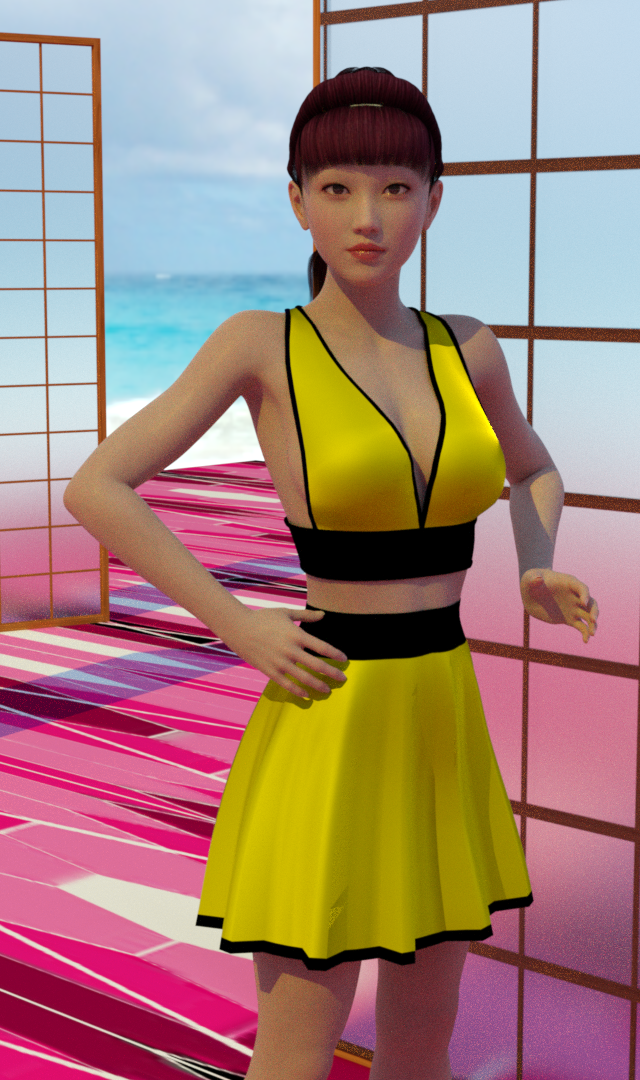

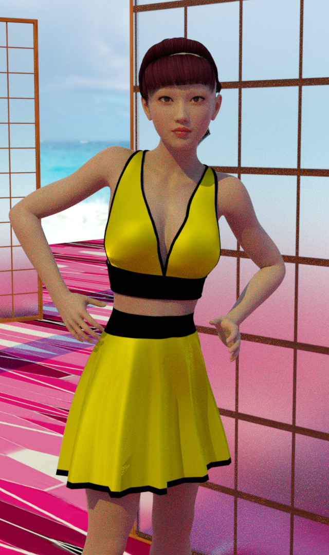

    edited April 2023
    i didn't test an animation but it seems to work,
    When the script succeeds the head orientation remains the same after applying mcjTorsionSpreader
    so in this case Kim's torso was twisted to the left but her face/head was facing us,
    after running the script she was still facing us, but her torso joints helped her attain this head orientation
    i looked at the code and there's just the hip node processing that looks wrong, but i always un-check-mark the hip node
    640 x 1080 - 1M
    640 x 1080 - 1M
