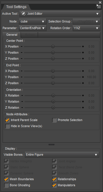

    If we are meaning the same thing, use the Joint Editor to move the centre point (green crosshairs).
  • @thilion With the Joint Editor tool selected open the Tool Settings pane where you can see the coordinates and enter precise numbers. If its a figure not a prop/item you want to edit make shure the root node is selected - this is the most upper part of the figure in the Scene pane.
  • Thanks! Right the answer I was looking for ...
