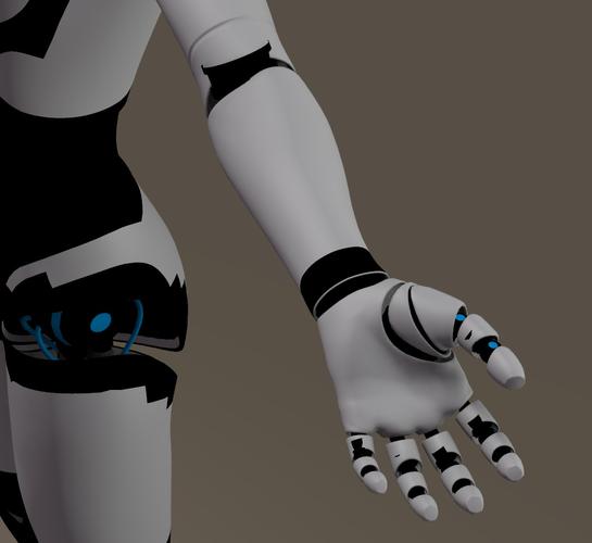

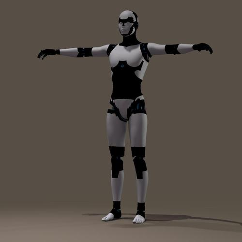

    Here are a couple shots of what you get when you first load in Poser Pro 2012 before the update.
    1055 x 968 - 59K
    800 x 800 - 19K

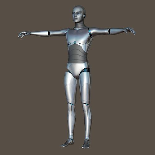

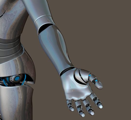

    And, here is a default load after the update. One important thing to note about matching materials is that to get the best possible results in a variety of conditions, I started by matching the environments as best I could. To do this I replaced the default Poser lighting in the scene with a single infinite light mounted to the camera (to match Daz Studio's default) and disabled gamma correction (Render > Render Settings > Firefly tab > uncheck Gamma correction) since DS doesn't do gamma correction on materials.
    1055 x 968 - 92K
    800 x 800 - 31K

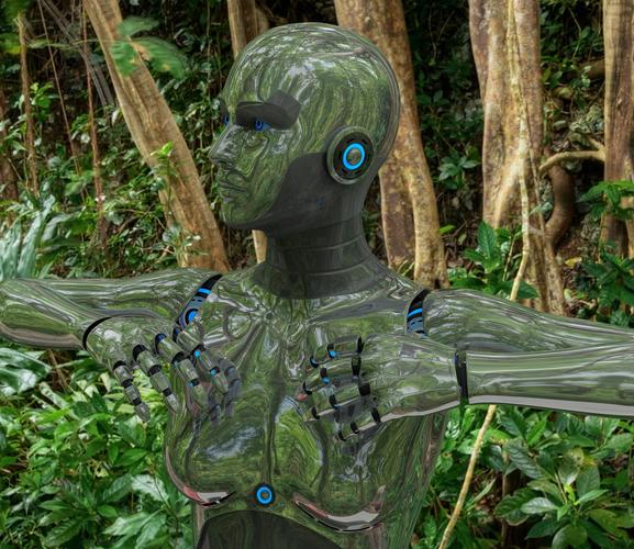

    Here is a specific problem I'm having. I am trying to use the ray traced reflections. I am using DS 4.5.1.56. I installed 15588_BotGenesis_1.1_trx.exe. My render shows that the hands, nipples, and part of the neck did not get the ray trace material applied.The outer edge of the "ear" doesn't look like it was ray traced either. What did I do wrong to cause those areas to not get ray traced reflections?
    These are the steps I performed:
    1) Load basic Genesis female
    2) Select Genesis in the scene tab
    3) Double click BotGen_All,duf in the Content Library
    4) Select Genesis and all 14 Bot_Gen attachments in the Scene tab
    5) Double Click BotGen_TraceMat.duf in the Content Library
    6) Load a 360 degree environment with UE and distant lighting so I have something to reflect (green leafy environment selected to make reflections obvious)
    7) Render with 3Delight, Max Ray trace Depth 2
    1676 x 1453 - 1M
  • ParrisParris Posts: 392

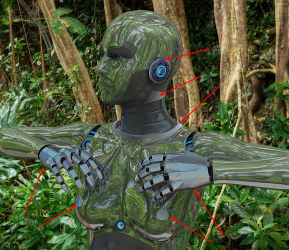

    Barbult - Ok, yes I see. I did a test on my end. For the nipples, it looks like the Trace setup is missing from the shader. So sorry about that. Without the update (not yet released), the quickest fix for that would be to select the 2_SkinTorso surface in the Surfaces tab, then in the Shader Mixer tab select File>Import From Scene. BotMetal will then be the active shader in Shader Mixer. Next, select the Nipple surface and click the Apply button in Shader Mixer.
    For the other areas where ray trace materials didn't get applied, there are material presets in your Content Library that should fix that in People>Genesis>Materials>Bot Genesis. So for the hands, head and torso, look for the ray trace material preset that matches the figure. For example, the ray trace preset for the left hand would be BotGen_Trace_LHand.duf
  • barbultbarbult Posts: 27,284
    Got it! Thanks.
    1676 x 1453 - 2M
    Great. Nice render and thanks for reporting back.
