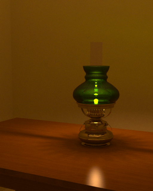

    I have an image I created last year that I've been reworking using Kindred Art's Iray Ghost Light Kit. The last version is posted in the "Iray Ghost Light render and support" thread in The Commons, and was rendered using Spectral Rendering On, Faithful, cie1964. Previous renders used Architectural Sampling On.
    The original image is 2560x1440, so I set the render size to 1280 by 720 to test the Spectral Rendering settings. Other settings I used include Max Samples to 5000, Quality "off", and Max Time "0". I then rendered the image 6 7 times, with the following settings:
    • Architectural Sampling Off, Spectral Rendering Off: 1449.353s (24 minutes 9.35 seconds)
    • Architectural Sampling On: 3414.986s (56 minutes 54.99 seconds)
    • Spectral Rendering On, Faithful, cie1931: 1313.596s (21 minutes 53.60 seconds)
    • Spectral Rendering On, Natural, cie1931: 1392.673s (23 minutes 12.67 seconds)
    • Spectral Rendering On, Faithful, cie1964: 1315.761s (21 minutes 55.76 seconds)
    • Spectral Rendering On, Natural, cie1964: 1319.192s (21 minutes 59.19 seconds)
    • Architectural Sampling On, Spectral Rendering On, Natural, cie1931: 3518.754s (58 minutes 38.75 seconds)
    I didn't bother trying all the Spectral Rendering settings with Architectural Sampling On as the Spectral Rendering alone took little more than 1/3 the time to render. At only 5000 samples, all images had some grain in the dark areas—probably only noticable at high magnification—but the Spectral Rendering images were less grainy. The cie1931 setting, whether Faithful or Natural, left the corridor behind the open door and acolyte, (upper left,) completely black. After I determined Spectral Rendering On, Faithful, cie1964 was the optimal setting for this image, for both speed and final appearance, I set the size back to 2560 by 1440 and rendered to 15K samples. I don't have the exact time for the original, but the Spectral Rendering at that size took about half the time. I do not, as yet, have a render without either Architectural Sampling or Spectral Rendering.
    (The final image is in my gallery, here.)
    ETA: Added actual render times, and also a "control" image without either Spectral Rendering or Architectural Sampling on. Also to mention I'm using one GTX-1080 on an 17-6900K based PC. Changes are in blue.
