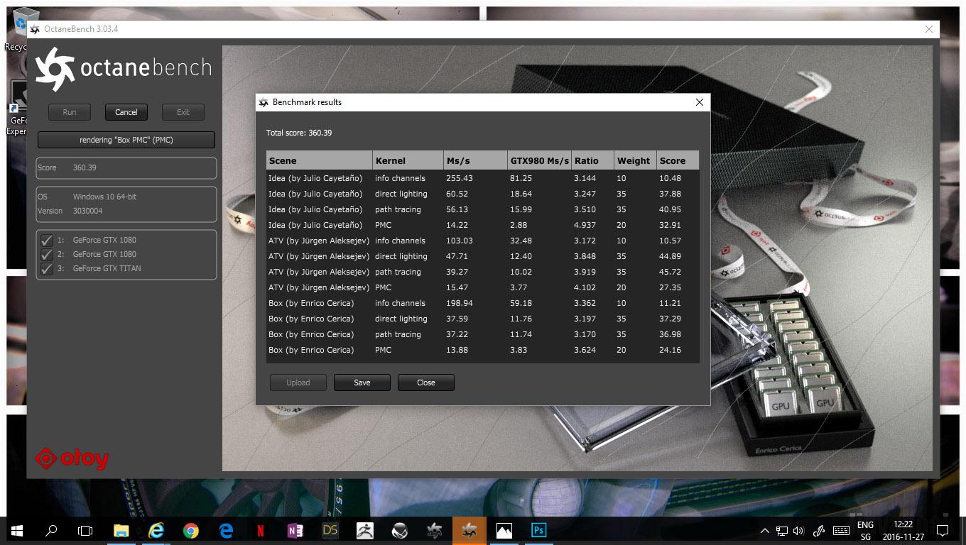

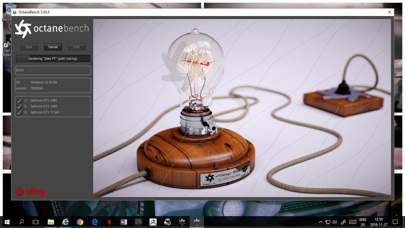

    Maybe you can get some idea about how your system performs when you run the OctaneBench while at the same time having a look at the temperature in GPU-Z?
    It may not run that long. But at least you get a temperature estimate and system check with all available GPU.
    OctaneBench is the official software from Otoy to test how all your GPU perform.
    Officially the OctaneBench application was not yet updated to test Pascal cards.
    Unofficially some savy forum users moved some files around and now you can also test Pascal cards...
    The average performance of a "standard" GTX 980 equals 100 score.
    If your 1080 scores around 130 it means its around 30% faster than a GTX 980.
    Quick guide:
    - First read how you would install and run the OctaneBench test normaly here:
    https://render.otoy.com/octanebench/
    - Then perform the same steps with the unofficial version:
    https://render.otoy.com/forum/viewtopic.php?f=9&t=56108
    - Download .rar file attached in the first post by unica of the linked thread
    - extract .rar file
    - Double-click the script "_run_benchmark.bat" in the Windows Explorer.
    No need to start the included OctaneRender test version...
    - Select the installed GPU you want to test
    -> Now a series of test scenes will render
    After the test scenes have finished rendering you get your score.
    Alternatively:
    Wait a few days, weeks or months until the official update for OctaneBench is released.
    1360 x 768 - 189K
    1360 x 768 - 229K
