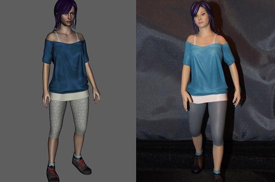

    Here's a pic of one of my designs and the resulting model. The model was built at the DRAFT setting and the pic is from my cell phone's camera.

    For a point of reference, the company I work for for would charge about $400 for the model I built; she is 7.25" tall. Keep in mind that it takes about 10 hours to build the model and do the initial finishing on it; that amounts to about $350 of the cost. My employer is considered to be one of the cheapest places to get high quality, 3D printing done. Most Canadian service bureaus charge 10% to 50% more than what we do.

    Our ProJet HD 3000 can build a model within the following constraints: 11.5 " x 7" x 7" with a 0.04 mm layer thickness. If you want a finer layer, the maximum envelope is about 7" x 5" x 5" at a 0.016 mm layer.
    Tall models take longer, so I believe that if you have an action posed model, you will want it under 3" in any one direction, and under 2" is best to keep costs down.
    I laid my sample model on her back, she was 2 inches high that way, so it took her about 10 hrs for the build.
