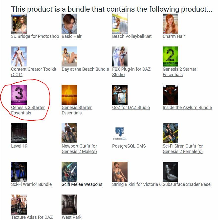

    Have you downloaded and installed the Genesis 3 Starter Essentials?
    If yes, have you downloaded and installed them by using DIM, Connect or manual?

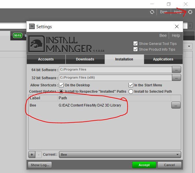

    Okay... Where does DIM install, and where is DAZ Studio looking for it?
    In DIM, check the installation path:
    Click on the small gear in the upper left side, and then check for the location, as in the image below.
    Now, check the path in DAZ Studio. It has to be the same as the one you have in DIM, and it has to be set in both, DAZ and Poser Format.
    You have to check it in the Content Directory Manager, which you can find under Edit--> Preferences (refer to the imnage below).
    Are the settings in the DIM and the Content Directory Manager the same on your system?

  • Thank you!  That is what I was missing.

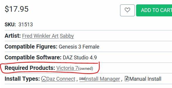

    (Also, which character are you using, exactly? Some need other characters to look like in the promo image, like http://www.daz3d.com/fwsa-alysa-hd-for-victoria-7-and-lf-little-mystery she needs V7). Additional morph packages are only needed if they are stated in the "Required" section in the shop here; it can differ in other shops. Still, a morph should still work (even if it won't look exactly like the one in the promo), without the base character.
    As for the extra morphs, they are recommended, as they allow you a much wider range for non-puchased character creations. But they are optional, really.
    EDIT: I found her over at Rendo. According to the product Readme, she needs "Miss You for Genesis 3 Female(s)". It also has a file list, that says where all the files are supposed to be. Can you please check out if all the files are existing, and in the correct place? Here's the URL to the readme:
    https://bw-1651cf0d2f737d7adeab84d339dbabd3-bcs.s3.amazonaws.com/products/product_112826/Help112826.txt
    Mods: I hope it's okay to post to the Rendo Readme. If not, please delete the link.
