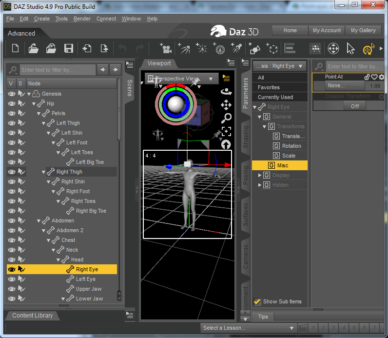

    Is  there any way to point a characters eyes at the camera and have them follow the camera as you move it around?
    In the Scene tab, navigate down to an eye and select it in the heirarchy. Then, in the Parameters tab, under Misc, there is a parameter called Point At - select the node to follow in the dialog that pops up.
    - Greg
    796 x 693 - 126K
    Post edited by algovincian on

    You can make your own eye control rig with the 'point at' as mentioned, or alternatively get MCasual's free Stare At Cam script
    https://sites.google.com/site/mcasualsdazscripts4/mcjstareatthecam

    As Greg says, you can choose Point At. But be aware that the eyes may) look unrealistic if the camera is too close. The eyes will unnaturally set their gaze, making your character look cross-eyed.
    It's usually better to set a null object well behind the camera. Parent that object to the camera, and have your character look at the the object, rather than the camera. This method also makes it easier to make fine-tuning adjustments to the gaze -- looking over the shoulder of the camera, for example, instead of right at it. (Depending on what you're doing, in many kinds of portraits the subject does not look directly at the camera; still, it's handy to be able to control the gaze without manually adjusting the eyes.)
