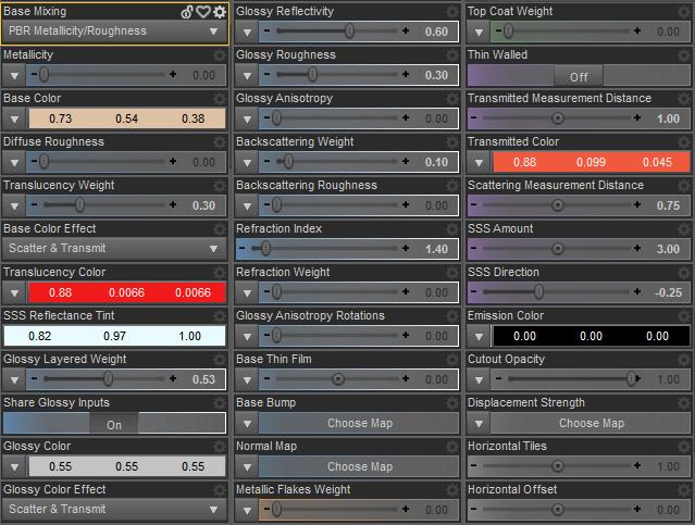

    Hello all, this is what I have been working with so far. My first attempt was to try to get something that approximated skin without using any maps at all. The settings are shown below.
    Although it looks pleasing, you have some glitches build in: From an artist's point of view, you can still say "I give a ... (whatever you want to put here)", if you want to get physically based shading right, you can't say that. How you want it to be is always up to you. smiley
    • "Glossy Color" is always WHITE. Don't use that to supress your glossiness strength. In the PBR Metallicity/Roughness Mix you use, the "Glossy Reflectivity" parameter will take care of your specular reflection color, which will modify the glossy color. Non-metals will not tint the coloring of the specular reflection in any way.
    • If you want your specular color to match the value of your "Refraction Index" (1.4) you'd have to set your "Glossy Reflectivity" to 0.3472222. The reason why and how to calculate that parameter you'll find a few pages back, and the method in @AndyGrimm's formula collection. Unless you set "Refraction Weight" to anything >0, the "Refraction Index" parameter will simply do nothing.
    • Having a linear value of or going towards 0.00  in any "Translucency Color", "Transmitted Color" or "Glossy Reflectivity" can seriously mess things up. People at NVIDIA recommend to avoid that.
    639 x 483 - 123K

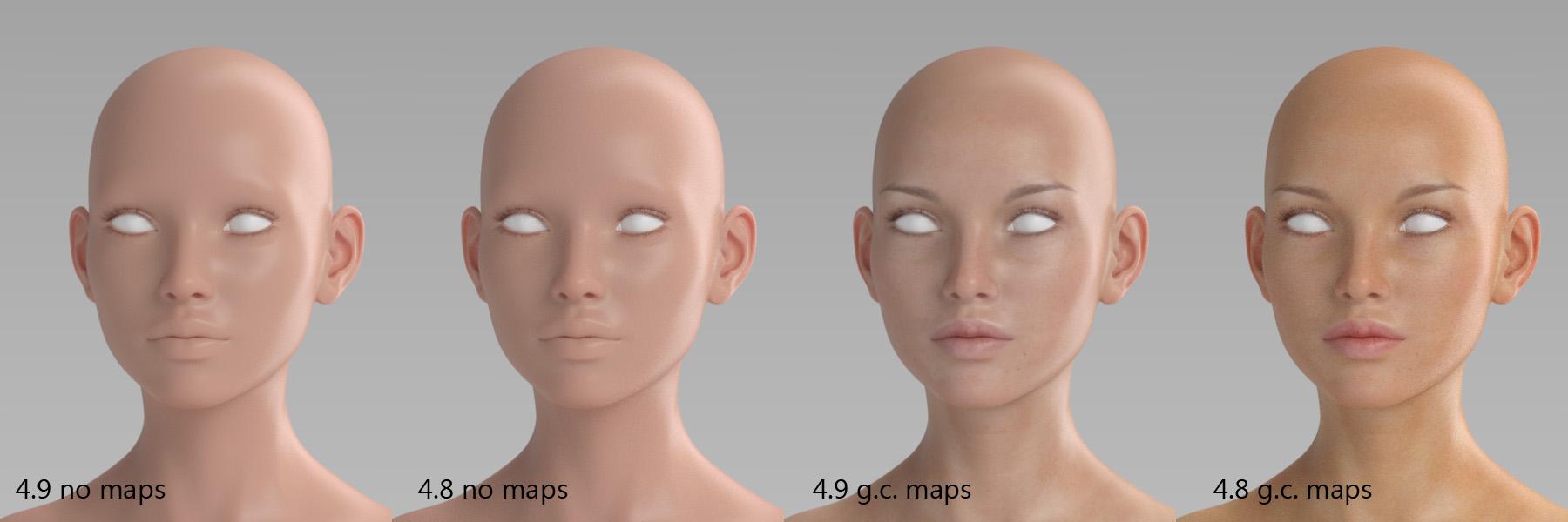

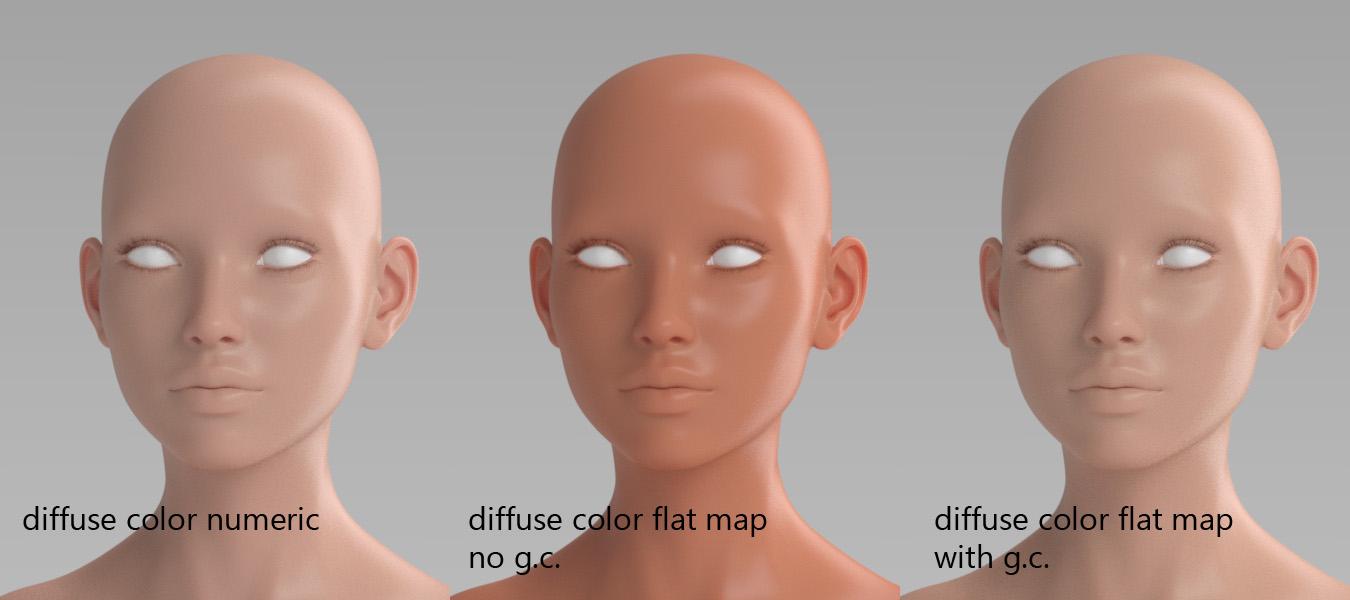

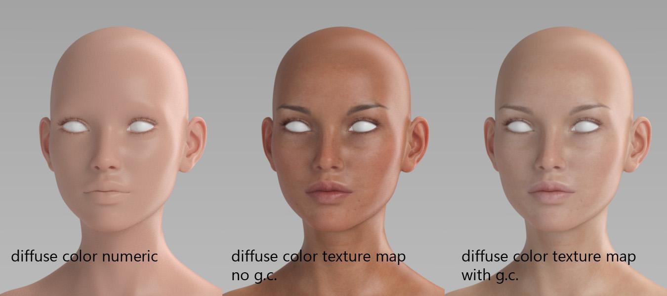

    First set of renders is comparing the "too red" issue in 4.8 and 4.9. Rendering the non-image-based setup looks exactly (exactly!) the same in both, so changes and issues are solely in the handling of texture maps.

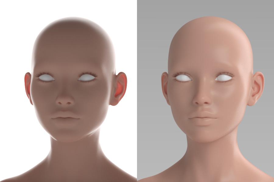

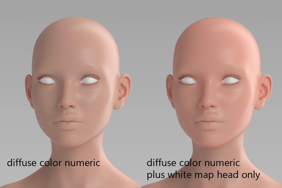

    4.9 has a new and exciting but still map-related issue. This is what happens when you take a shader setup, blank the diffuse color, and plug in an image map which is exactly, or in the case of the full texture, very close to the same color. Red, red everywhere. In preview, they match without gamma correction.
    Finally, plugging a strength map into translucency strength works okay (yay). But plugging them into transmission color or translucency color does this. The difference here is literally just plugging a flat white map into transmission color and translucency color while leaving the colors already in the channel as they were. This should be changing absolutely nothing about the final render. White should change nothing. Instead, it causes the color to explode.
