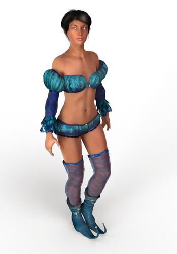

    Well my Jenni's been transfered, got some tweaking to do and I need to get rid of those "claw hands" she's inherited from Genesis 1, but all told she bends really well as is, Jenni is on the left with G3F on the right.

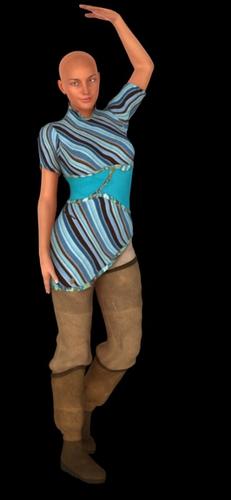

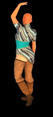

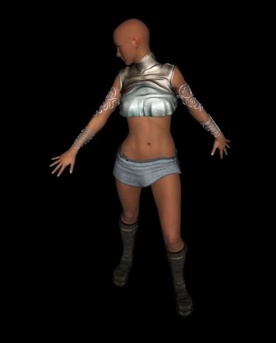

    I've tested V3 clone on G3F, transferring it all way from Genesis Mil 3 Iconic Shapes to G2F -> G3F.
    Below are transfer results for V3 Eclipse (arm ornaments, panties), V3 Yaara (top), V3 Samil May (skirt and boots); second set is V3 SF Uniform (with random textures for top as I couldn't find anything light-coloured enough). I didn't try any kind of long skirt or drapes because autofit will give its usual messed up results anyway. Sorry for bad lighting and shaders, as my DS isn't rendering very well.
    Flat boots transferred well and everything close to body transferred well. I suspect V4 would be doing ok as well in this regard. There was a deformation under boobs when I tried V3 Winter Wear but I recall it happened on G2F and Genesis with some kinds of loose tops. I didn't use any kind of smoothing modifiers, so I wonder if they could help.
    The problem with clones, I think, might happen because clones for Mil 3 and Mil 4 are different from default pose for Mil 3 and Mil 4, especially in leg positions – when I used Iconic V3 _morph_ instead of clone I've got unpleasant results. So, use _clone_ as a basis for _clone_. I've got mine from same Mil3 Iconic shapes for Genesis and it has been very useful.
    Genesis and G2X default poses are same as zero poses, so either morph or clone should work ok.

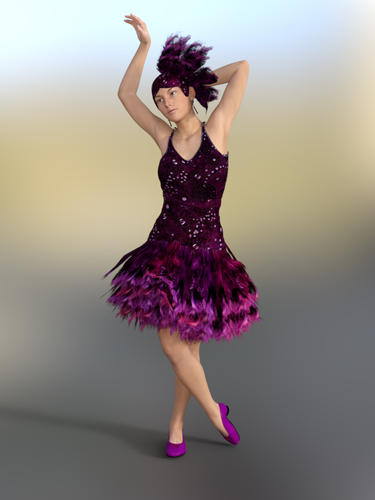

    Hey Kattey, thanks very much for this really informative thread - I hadn't really taken a look till today, but here's 5 minutes work following one of your threads to make a V4 clone for autofit to G3F - I'm rather pleased so far :)

    So far I've also tested A3 clone (using Genesis Iconic Shapes for A3 clone -> G2F ->G3F). It has minor pokethroughs as well as standard autofit problems with area under/between breasts on some outfits, all kinds of drapes, handing sleeves and skirts. Flat footwear transfers well. I had to hide G3F toes on Charmed but I think it is because shoes were built for more narrow foot than usual on purpose.
    A3 Desolation Earth Nomad (with Emigré textures) and A3 Elfdance Charmed with Blue textures. Apologies for terrible lighting. I've also tested on Shadow Dancer, A3 Amorah Elven Knight, A3 Lotus and A3 Modern Rose.
    596 x 855 - 74K
    481 x 782 - 40K
