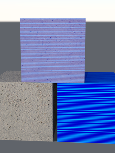

  • jag11jag11 Posts: 885
    Actually I was playing with Shader Mixer, just mixed two materials, Concrete with a procedural shader.
    600 x 800 - 488K

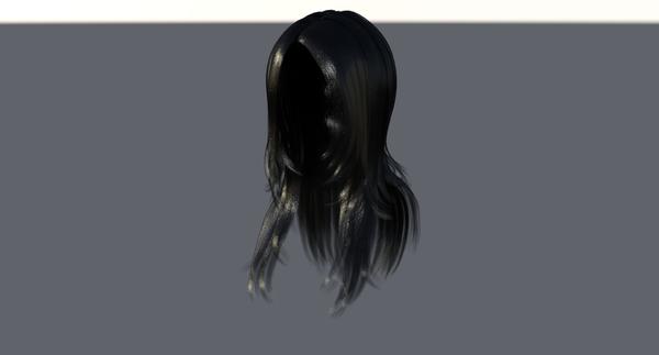

    GarrettDR said:
    I tried Moonsong hair
    PH Sweet
    Orianna Hair
    I have these and more...
    Olympia 6 Pro Bundle
    Gianni 6 Pro Bundle
    Gia 6 Pro Bundle
    David 5 Pro Bundle
    I really appreciate your time!
    We have in common Dream Hair. Just to make sure everything matches, the steps you should do:
    1. File|New Scene.
    2. Go to Smart Content Tab|Hair|Dream Hair, doublé click Hair Asset.
    3. You should see it plain White as it has no shader applied.
    4. Again in Smart Content Tab|Hair|Dream Hair, select any Material, it doesn't matter.
    5. Once the material is applied, go to Surfaces Tab|Editor click on Dream Hair Node, make sure sub nodes Bangs, Base, etc. all are selected.
    6. Go to Surfaces Tab|Presets|Shaders|Iray and apply Iray Uber Base.
    7. Go to Content Library Tab and locate the Iray Black Hair shader and double click it. You'll see the appearance changes once again.
    8. Zoom-in.
    9. Render.
    Tip: I always prefer to work with NVIDIA Iray defaults, so, go to Render Settings Tab|Editor and click on Defaults button
    600 x 800 - 189K

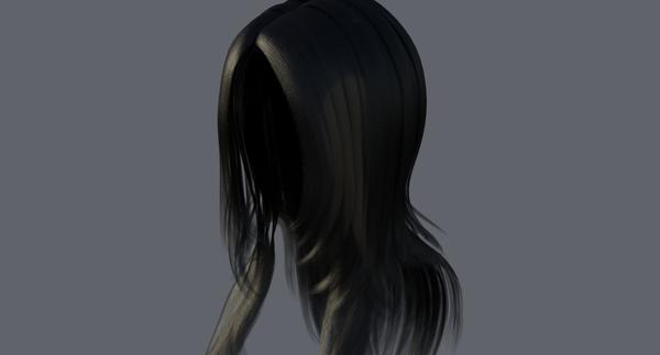

  • GarrettDRGarrettDR Posts: 229
    OK! I don't use Smart Content, but I will see if I can this time and get back...

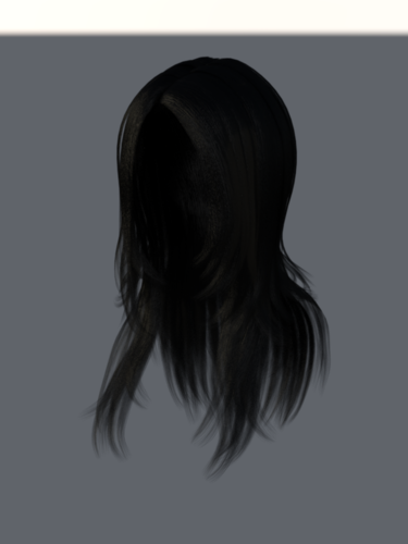

    rendered 72%
    1914 x 1030 - 347K
  • evilded777evilded777 Posts: 2,545
    Thoughts?
    I have loved the Aaron texture since it first came out, and it really does stand the test of time. Morris is the queen.
    741 x 1200 - 276K
    GarrettDR said:
    rendered 72%
    I think I found the reason, Top Coat Roughness, set it to .25, the lower the value, the glossy the hair.
    It was set to .45, which is way off.
  • Oso3DOso3D Posts: 15,115
    Anistropy is probably a good idea (not an expert, but seems to help do that 'long gloss' effect).
    Also, I've had decent results with .4, though with lighter hair where I'm more layering light elements. Generally, roughness at a high level for gloss, then a lower level for top coat, then adjust the two to get 'lit' vs. 'gloss' effects.

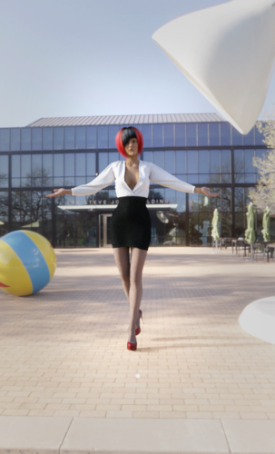

  • kyoto kidkyoto kid Posts: 42,396
    OcamRzr said:
    Kyoto Kid said:
    OcamRzr said:
    Still trying to wrap my head around the scaling issues.
    Here is my latest attempt with the Pixar Campus. How you guys are getting such exacting details and my attempts come out fuzzy I don't know but I am pretty sure I am at fault.
    As you can see "Gen" is as frustrated as I am with it all...
    ...I basically cheated.
    Changed the dome size to 80 to get the camera position and angle I wanted, turned off the character, Rendered just the setting. First took it into PSP to fix the "barrel" effect (curvature to the image) then opened it up in Gimp and used a sharpen script to add more definition. After that rendered the Merida character and will o' wisp separately with the Draw Dome setting turned off, opened all in Gimp and composited the scene together.
    One question, which HDRI resolution are you using, the 4000 x 2000 or the 8000 x 4000 one?
    8000 x 4000
    I rendered both images separately but for the life of me can't get them to layer in Gimp...
    ...turning off Draw Dome should leave you with the shadow catch plane the character and the transparency background. Also, remember to save any image that will be layered on top ofthe background image as a .png as this preserves the transparent background.
    After both the background and character are rendered, when you go into Gimp open both the rendered background and character as separate files. Click "Copy Visible" (Edit menu) for the character. Then switch to the background image and click "Paste". It should place the character exactly where she would be if you rendered everything in one pass provided you did not move the camera or character between renderings.

  • Occams_RazorOccams_Razor Posts: 40
    Kyoto Kid said:
    OcamRzr said:
    8000 x 4000 I rendered both images separately but for the life of me can't get them to layer in Gimp...
    Almost there with the scaling but still need to try the layering tricks. Tried the Dreamlight LDP-R and it worked, more or less...
    I know "Gen" is floating a bit here but I really didn't feel like running another render to correct it. LOL!
    312 x 515 - 122K

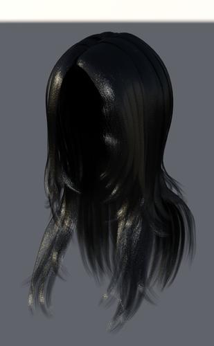

    .25 setting on Top Coat Roughness
    1914 x 1030 - 224K
    Weird. Looks like oil. we'll figure it out.
    Please follow this steps:
    1. Go to Render Settings Tab|Advanced.
    2. Adjust Texture Compression with Medium Threshold and High Threshold as 3072.
    I don't know if changing this settings requiere to restart DAZ Studio.
    Sett render settings back to default, Medium and High Threshold changed to 3072 each; Closed Daz Studio, reopened. Made sure Settings remained.
    Opened Dream hair, plain white.
    Added Coffee texture
    Applied Iray Uber Base
    Applied jag11 Hair Shader
    Changed Top Coat Roughness for all of Hair from .45 to .25.
    I had tried SickleYield's advice about Default Camera and turning it off but I haven't noticed a difference in the look of the hair.
    I am taking my wife to go eat and then I'll be back but, I am going to install Daz Studio 4.8 on my laptop and try this with g2 base hair. I think I might be having more problems.Will get back with the result.
    Thanks again, even though you say don't worry.
    One last question, Where did the hair shader you kindly gave me come from?
    1187 x 1920 - 794K

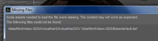

    edited April 2015
    now I get an error when trying to use your shader...
    this is from the laptop
    526 x 136 - 16K
