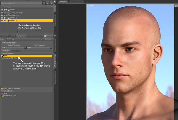

    (EDIT-reattached photos from before the thread was merged back into the renders thread) Thanks to Mec4D for the "Tech Grotto Getaway" for our fellow "Iraynians" (HAHAHa I love that!) It's nice to have a place to geek out & share techincal works & tips relating to PBR & Iray alongside the render showcase thread. For those who don't already know me, like Cath I'm a bit of a "seasoned" student & professional of the visual arts ;-) 20+years as an Audio engineer, Editor, film, video, lighting & Photoshop professional; Photographic study & play from childhood, and shooting stills professionally for 17+ years; A hardware & software nerd since the late 70's who built every non-laptop system I've owned (though I've tricked out my laptops too LOL); And of course a member of the DAZ/Poser community going back to the Zygote days of the Millennium Woman & Man.
    So in short terms I'm a G.E.E.K. & proud of it!
    I've long waited & worked for the day when we could blur or erase the line between the physical & virtual worlds via CG and now we have multiple tools & great render engines to accomplish this, with Iray being the latest to make it's way to our corner of the 3D universe and I couldn't be happier.
    Enough with the blah blah, here's a cool tip LOL
    Did you know that you don't need an Nvidia GPU graphics card to render with Iray? It's true! As long as you have a decent CPU, as most modern PCs do, you can work with Iray while waiting for that drool-worthy GPU upgrade your tax refund has been allocated for (Yes Wolfie, I'm lookin' to ya ;-) )
    Under Render Settings, click the Advanced tab & you'll see check boxes for the CPU & GPU(s) in your system. Make sure CPU is checked under Photoreal (and interactive if you want to work with the faster but a little less accurate portion of the Iray engine), and you're all set!
    The image attached was done only on the CPU in 4 minutes. Granted my workstation is running a pretty fast 4 core i7 (8 rendering threads), but I've tested out working on my 6 year old dual core Gateway laptop, with no Nvidia or AMD powered graphics processer, and can render in Iray as well. It's slower of course, but it works. So don't let the allure of sexy shiny GPUs you don't have yet keep you from dipping your toes into the PBR pond.
    648 x 917 - 369K
    1323 x 894 - 316K
    Post edited by AlexLO on

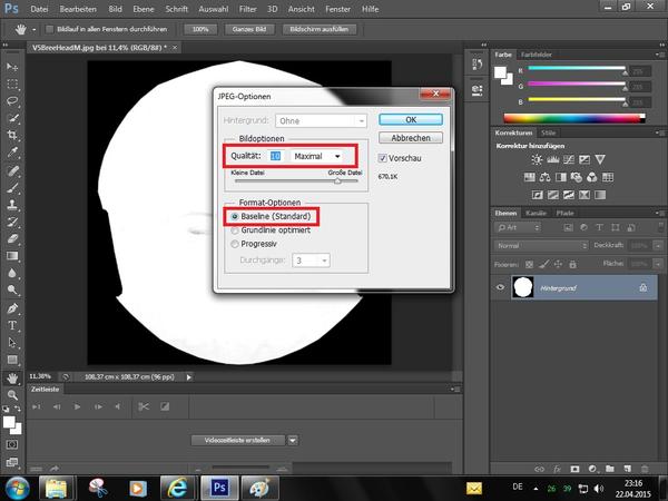

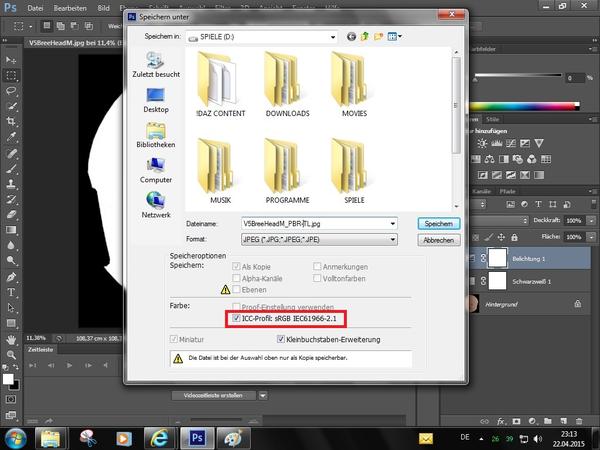

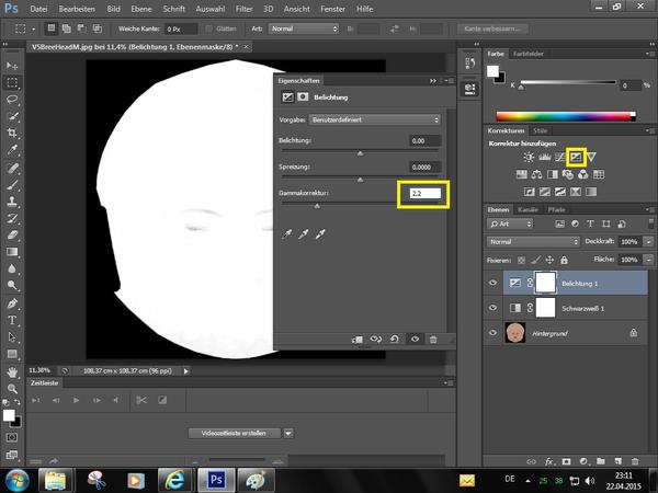

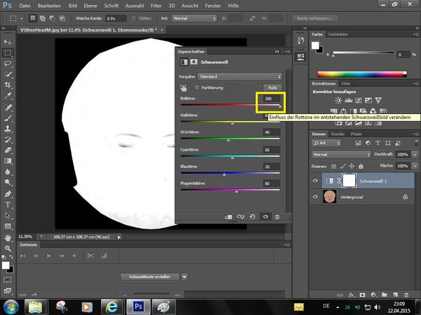

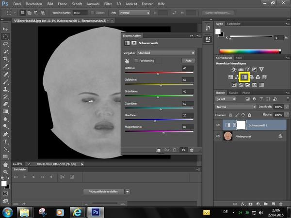

    I got some questions about creating a "Shadow Catcher" map like those MEC4D noticed in the "Show your Iray Renders II"-Thread (http://www.daz3d.com/forums/viewreply/807952/). Since I'm not a Pro in Photoshop (mere a bloody beginner) I want to be sure I'm on the right track here. I made some screencaps for the most important stages (using Photoshop CS6).
    1. Convert the skin texture to a Black & White (greyscale) image.
    2. Remove reds by pulling the red channel slider all the way up (to 300 in that case).
    3. Apply a Gamma Correction value of 2.2
    4. Save as JPEG in ICC sRGB IEC61966-2.1 formate, as recommended in this Tutorial (http://www.computer-darkroom.com/ps10_colour/ps10_1.htm) Would have chosen .png, but sadly there's no ICC option for this.
    5. Choosing JPEG Options "Quality: 10" and "Baseline (Standard)".
    The outcome is, depending on the texture set used, a mostly white jpg. (Victoria 6's conversed textures came out almost entirely white).
    Would that be the correct procedure, or am I missing something?
    - Picking a color for the SSS "Transmission Color" :
    I choose an area of the skin texture which would be one of the brightest (in Victoria 6's case I picked an RGB of 230 - 156 - 124 on her cheek). Is that recommendable, or are there other, more accurate methods?
    - Defining "Scattering Measurement Distance":
    when applying the Iray Uber Base to V6 ("Belle" texture set), you'll get a value of 10.0. That seems to be way to high IMO.
    Using the standard value of 0.10 would also be too low I guess. Are there any recommendations, how to set this right?
    I never worked on SSS values before, I always used "what I got".
    Thanks for your attention.

  • MEC4DMEC4D Posts: 5,249
    It would be better if you choice the color for Transmission by seeing the exactly level of Luminosity , what is the L in color picker
    forehead is good place to pick up the color should be not less than 56 and not greater than 72 ... around 68 is the best for Caucasian skin .
    Also regarding the shadow catcher to block the translucency from washing off the eyebrows, when you slide the red channel up , you control the level , how darker the eyebrows how better , you can remove everything else than is not white from the textures and leave only the eyebrows for ladies .. for guys would be good to leave the hair stubble too ... or scalp or body hair ...
    thanks for the illustrations it will help people to get off of the washed off eyebrows and hair
