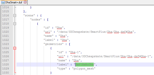

    Edit 2 (25th Apr): I've been checking this prop in DS4.6 - it puzzled me that both oProp.name and oProp.getLabel() return "Dha" for this prop? Until I noticed that the "SmPlHaRo"label is in the 'geometries' section. What's puzzling me now is how the heck my script knows that this is a Smart+ prop ???
    ...Ah,found it - around line 972 of GenericpropGotoPlus.dsa...
    } else if ( (oProp.name.slice(0,3)=="Dha") || (oProp.name.slice(0,13)=="WaterJarScoop") ){
    ...hard-coded check forthe original prop names.

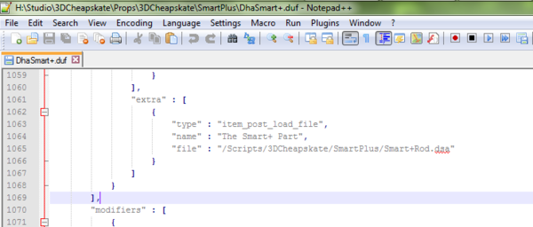

    If you manage to create a DUF prop that works with a HANDPROXYDATA line with six zeroes, then read the following thread (the other one DaremoK's comments got me to unearth)...
    “Can I automatically run a DSA script when I load a prop from a DUF/DSF file?”
    Simply adding a post-load data item as Rob suggested should magically turn such a DUF prop into a fully-fledged Smart+ prop - i.e. it will automatically call the Smart+ script when it's loaded. The script you need to use as the post-load thingy is 'DS Content/Scripts/3DCheapskate/SmartPlus/Smart+Rod.dsa'. The screenshot shows the relevent bit of the DUF after you've saved it.
    Also note the bit at the end of the thread about the cack-handed workaround ! :D
    (Edit: a DUF prop done like this should work with release 1 and 2 of the Smart+ stuff. I really do think that's all there is to it!)

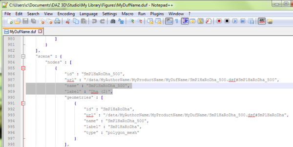

    So I then tried simply saving the 'DAZStudio Smart+ Release 2 Dha PP2' as aprop asset ( File >Save As >Support Asset > Figure/Prop Asset ),loading the newly created DUF, and running GetproxyData.dsa on it...
    :HANDPROXYDATA
    {propName},Dha,SmPlHaRoDha_500,0.000,0.000,0.000,0.000,0.000,0.000
    Now THAT looks perfect ! (screenshot is the relevant bit of the newly created DUF)
