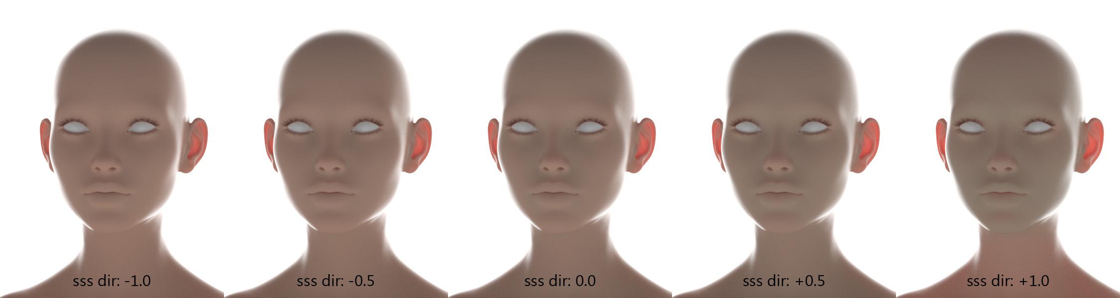

    Okay, this is what I'm working with now. Switched my previous translucency and transmittance colors to have the brighter one in translucency as was recommended by Arnold. That left exactly the same color because DAZ just multiplies those two together, but I'm hoping as he showed it will change with other parameters more realistically. Also changed the base skin tone to something more yellow so most of the red would come from scattering. That seems more normal for human skin (something like 95% SSS contribution).
    These shots were using those parameters, varying only the SSS direction. As you can see, -1.0 and -0.5 have very strong back scatter. Between 0 and +0.5 look the most reasonable to me, then at +1.0 the through scatter gets unrealistically overpowering.

  • AndyGrimmAndyGrimm Posts: 910
    edited December 2015
    agent unawares
    as i understand it and my test showed it...
    transluceny map or color - get's just added (or multiplied (photo algo - multiplied - no change in gamma)...  with TMC(invers, absorbtion... that's the start sample ... for absorption.. here guessing.. but that's what i see...
    Nice test serie .... i am surprised that Scatter 0 looks good - i guessed it could be a circle - and not isometric (doing nothing)...  but must test that myself.. was just a idea before somehwere in the thread thart Zero could be 360..

    Yes, I think 0 direction means that there is no weighting difference between front and back scatter, it still scatters the same amount.
    Maybe translucency and transmittance does get added, I am not sure. Whatever algorithm is used, doesn't matter to the final color which color is in which slot, at least without using maps. They rendered exactly the same.
