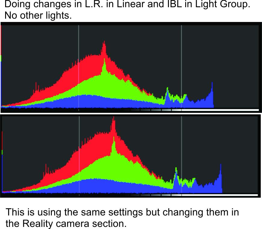

    I edited my results, posted the Histogram (I hope that's what it is, and no comments from the peanut gallery) at the END of the second test, with the exact same render time and samples per pixel. So everyone's clear, the first one in LuxRender, I switched to Linear and tweaked the ISO and all the Tone Mapping settings. I went into the LIght section and increased the IBL. There's no other lights in the scene, I kept it simple.
    So then, I used those settings and in REALITY, I put them in the Camera section. In LuxRender, I left it at the default Auto Linear and the default 1.00000 for the IBL Gain. Here's the two results.  This is using Malibu IBL. (from the HDRILabs site)
    750 x 1000 - 1M
    750 x 1000 - 1M
    Post edited by Novica on
  • NovicaNovica Posts: 23,925
    edited March 2016
    LOL, I was getting there, but someone already asked what the settings were. I start at these when doing it the L.R. tweaking way, because I can change slightly from the dropdown options in Reality. I'll explain in (  )

  • pcicconepciccone Posts: 661
    edited March 2016
    They look the same to me. Is that what you were looking for?
    Post edited by pciccone on

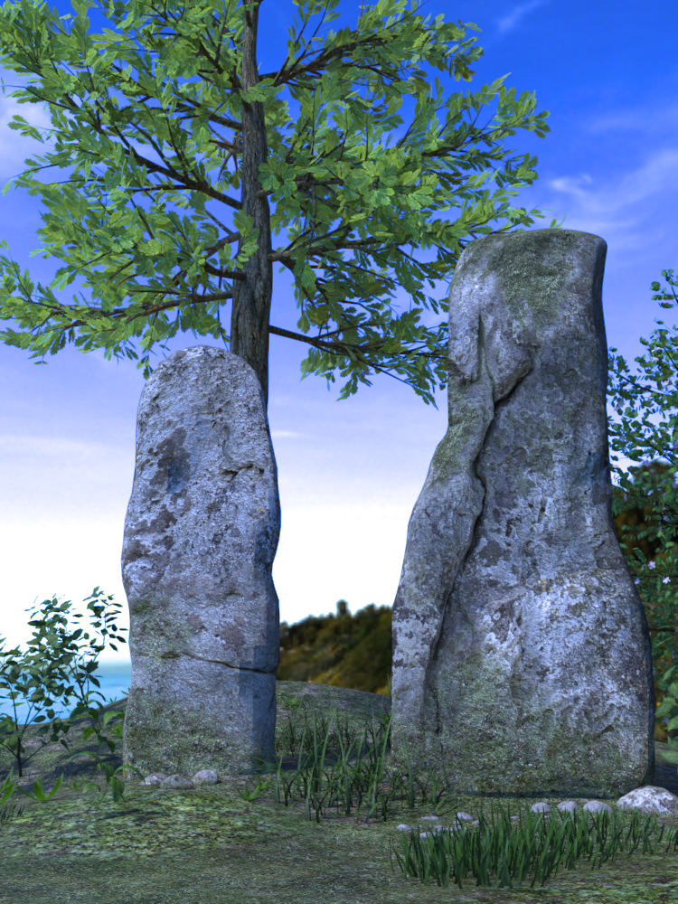

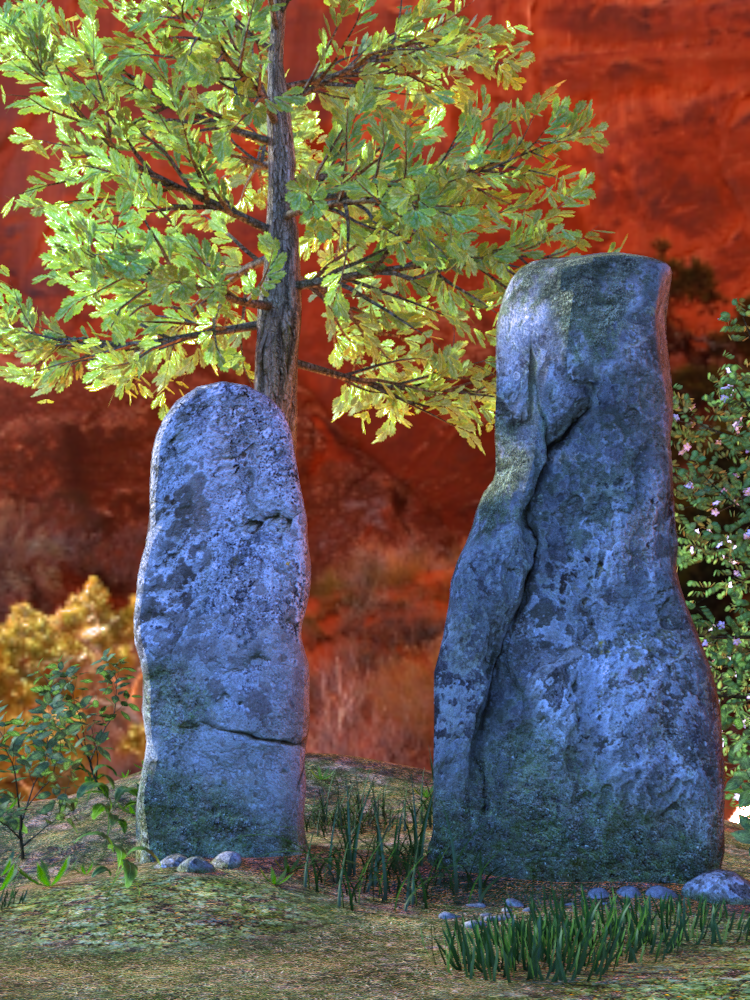

    Okay,I'm sharing my settings for the renders, testing the Smart IBLs. These may give you a good starting point, or I may be boring you. wink For this one, my settings keep the leaves from being blown out and the rim lighting noticeable but not glaring. If you have all dark objects you'll lighten everything, but I had those leaves to contend with that I really liked.
    The Arches and Pine tree Smart IBL settings in LuxRender: (and in parenthesis, what you'll need to use in Reality which is the CLOSEST setting, you can't type in numbers. As discussed, you can type these in the Camera Setting in Reality then tweak in LuxRender.)
    ISO 168 (Reality 160)
    Shutter 0.475 (Reality 1/2 is 0.500)
    F Stop 7  (Reality 8)
    Gamma 2.34    (In Reality Lights, leave that IBL image default gamma at 1.50)
    In LuxRender, the IBL light section- the IBL gain was 1.3750000 (I'm going to keep those simple, all those numbers is a pain. I'd rather tweak the other settings!)
    In the Reality Light section, the Y rotation was left at 260 to get side lighting and compare all the IBLs equally.
    EDIT: If I want the light to be more orange, can I put that in Environment Color or is that used only when there is no IBL image?
