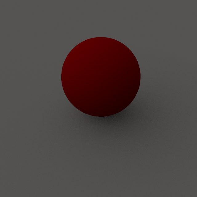

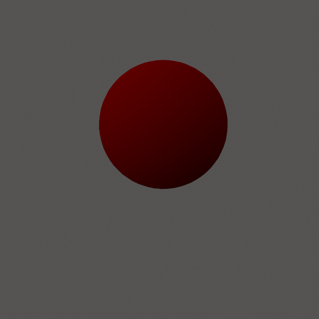

GI is global illumination and it is all the indirect light in a scene...basically there are 3 types of indirect light. There is occlusion, which is more of a where light isn't than actual lighting. It is all the self shadowing that folds, wrinkles and bumps make on a surface. Then is 'ambient' or indirect light...all the other light that isn't from the direct light sources. Finally there is bounce light...reflected light from other objects, that's what provides color bleeding.
Those are the basic settings in UE2....and you have your choce with most of those to include directional shadows or not.
Now a renderer like Iray does all of that, automatically, all the time. 3DL needs a special light shader to do more than just direct lighting, otherwise all it does is use the direct lighting, porvided by what lights you have added to the scene. UE2 is one of the shaders that does it...
The UE2 settings...
Ambient (indirect, no shadows at all)
Indirect...(directional, soft)
Occlusion (diriectional, soft)
Bounce
A couple of other things about UE2...
It does not provide specular lighting, so the last image (bounce) is the only one that is showing proper specular response...because it has the added spotlight.
The UE2 Bounce setting really doesn't work without an addirional light source in the scene.
The effects are mostly cumulative...so you don't need an indirect UE2 AND an occlusion to have both.

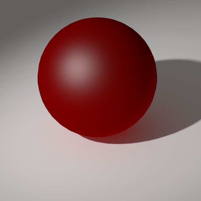

This is an alternative GI light. It was created by Matt Ebb and uses the more 'modern' features of 3Delight. It was originally written for the Blender 3Delight exporter, but imported to DS. It uses the same environment map as the UE2 did (manually added) and the same spot as the bounce did..
There are some other differences, but the most noticeable one is that the color bleeding is more pronounced (also there is more 'softening' of the shadows).

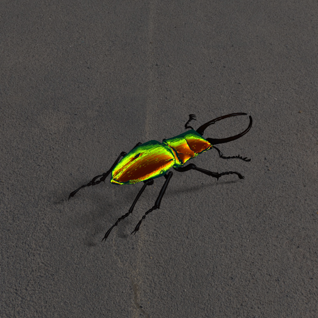

Some test with other objects. I think i've figured out glass for US2 and why it works well with some models and not with others. It works well with simple, solid objects - like the glass swan - but once you started using more complex models, the nested dieletrics problem rear its ugly head. For complex models, where you have rays intersecting the model at different points, passing through all the glass, water, air etc at different points causes energy loss hence the darkening with objects. The workaround is simply to use lower opacity settings till there's as little energy loss as possible. That explains why I had to use 0% opacity with that AllenArt model.
No such problems with 3delight Glass shader for Maya though, at least from what I saw. So it's not the renderer, it's the shader.
Easiest workaround is to use the geometry shell trick (or another copy of the same item) and make sure it's casting the shadows (instead of the primary object) but invisible to everything.

The UE2 settings...
Bounce
Wow thanks a lot mjc! I guess I'm beginning to understand. The situation in my scene was that I originally used a distant light (with raytraced shadows) and the UE2, but with the standart settings, when I switched to that other light set the setup was generally the same but for the use of occlusional soft shadows in the settings of the GI.

Thinfilm() is interesting in that it does iridescence/interference type stuff for us (tempered metals etc). It's different from just varnish.
An interesting article on possible uses of thin film for more than just metals:
http://blog.maxwellrender.com/tips/pushing-the-limits-of-realism-of-materials/
Yes, I came across an old scholl iridescence shader that I imported and have mostly working (it's an older Renderman one), that 'fakes' it with six colors and ramps and such. It's pretty nice for a fake, but I saw some stuff on the thinfilm() while looking on how to improve it.
One of the 'best' improvements I stumbled on was hacking out your reflectance from Radium. It works best on items with lots of nice curves...and a little displacement.
If I actually use it, I'd pick some different colors those are just the 'defaults' that it came with.
