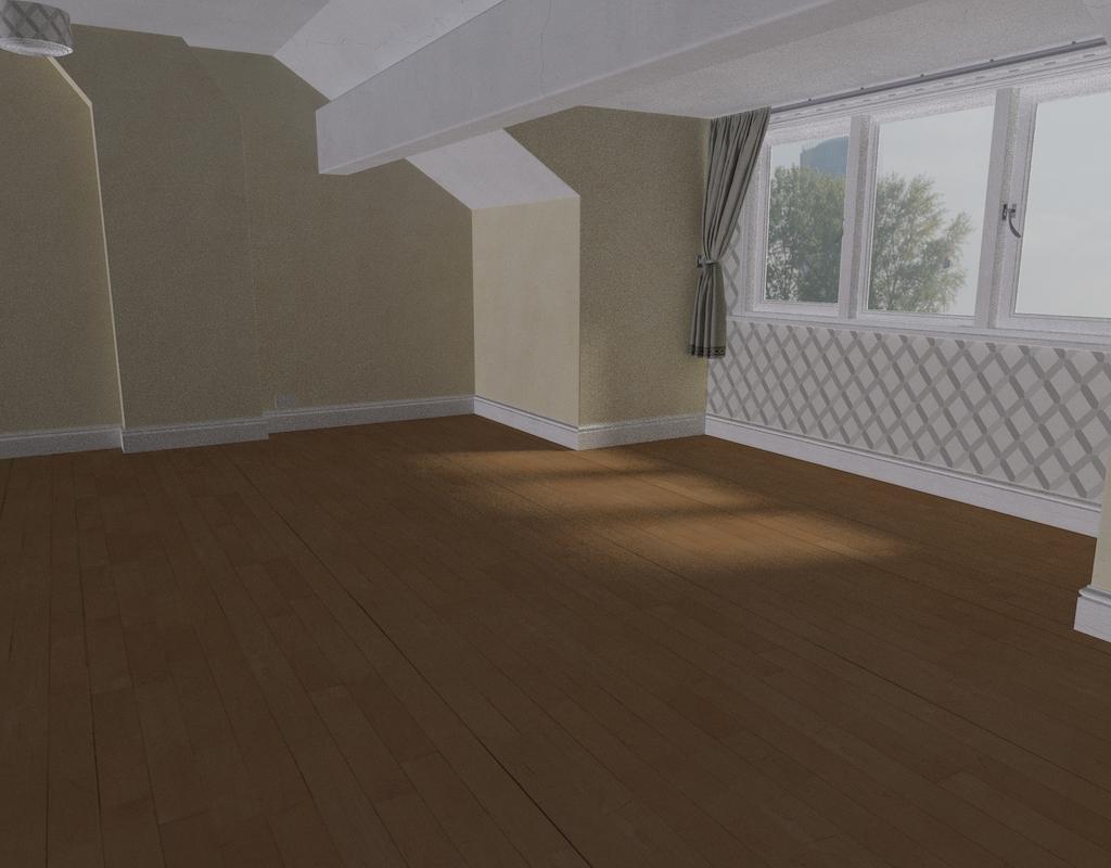

    This is the Modern Living Apartment Bedroom...with an UE2 bounce and Envlight2, with your 'simple sun' HDR, kettuworld 'space' and the background image from the 'parkinglot' HDR set on an envsphere justfor something to look at, of course).  One of the nice features of MLAB is that it has a 'blackout' box that basically seals it.  The only openings in the box are for the windows...

  • wowiewowie Posts: 2,029
    Well, I've found out that UE2's max trace distance needs to be adjusted, depending on the sun's position. If the sun is quite low (long shadows), the shadows cast by objects might get clipped. I actually had to use something like 500 with that Hyperfocal HDRI.

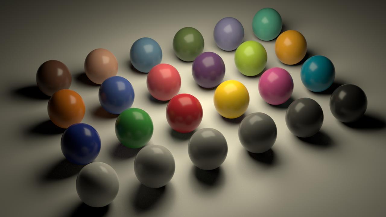

    Just finished reading this:
    https://www.fxguide.com/featured/renderman-under-the-new-varnish/
    I really like this quote:
    Christos Obretenov. "In particular with textures, RIS path tracer’s camera rays directly sample each shading point, as opposed to the grids sampling with ShadingRate in REYES, so you get much sharper textures in RIS: in REYES you would have to take the ShadingRate down to 0.25 to get that 'equivalent' quality (In RIS ShadingRate only applies to Displacements now)."
    Guess that's positive confirmation to that discussion in the old thread about shading rate in REYES and the raytrace hider. Didn't notice the part about displacements though, since i generally don't use displacements that heavily.
    Plus there's a render with color values from a Macbeth chart.
    Macbeth chart render by Liam Whitehouse.

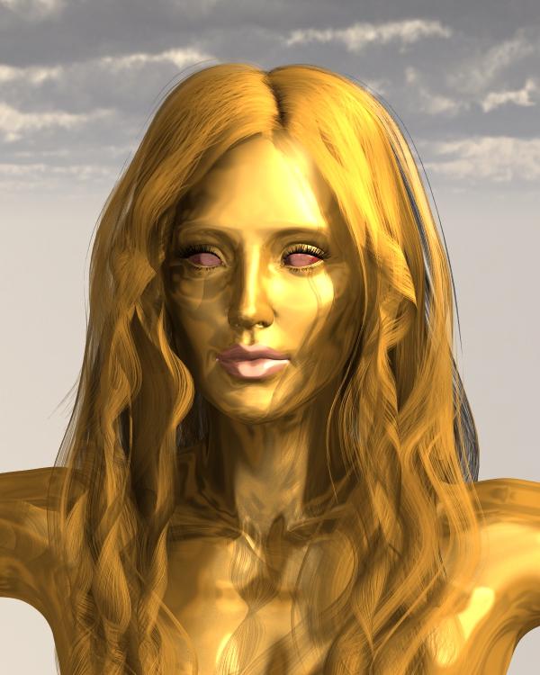

    METALLIC HAIR - Is it possible to create metallic hair in 3Delight?
    • I used Gemologica on the skin, lips and eyes.
    • Lights: Advanced Ambient Light: 70%
    • Hair: Desideria.  Used settings from Gemologica gold skin.
    • Changed Diffuse, with Specular Color lighter, Specular STR 80%
    • Glossy 70%
    • Reflect STR 20%  I even added Gemologica's Reflection jpg to the Reflection.
    The hair does look pretty good, but not metallic.  First Pic.
    Can't use Gemologica gold on the hair, because I lose the strands and transparency.  Second Pic.
    By the way, thanks to comments by ZarconDeeGrissom and Rogerbee in April - using Progressive Render shortened the time to 3 minutes (was 10).
    600 x 750 - 275K
    600 x 750 - 300K
    You should be able to add the transparency maps back in for the hair, if you've used the Gemologica presets.
    Very nice window shadows =)
    Another CC0 light map... With the main light coming from the opposite side. This time the sun is smaller, and the sky itself is darker. Probably too dark - so, it's either a supermoon night or a planet without atmosphere.
    http://www.mediafire.com/download/0c1j2hqhb6krz27/pinsun.exr
    Yup, it's one of the reasons DelightGI defaults to a "crazy" high trace distance.

  • dracorndracorn Posts: 2,379
    I added the transparency maps back in - there was a significant improvement, but not quite as metallic as I would like.  Wonder if that's the nature of the trans maps.
    I also add Advanced Distant Light to bring in some highlights and that's an improvement over the Ambient lights alone.  I imagine it will improve with proper lighting.
    First Pic: Before
    Second Pic: After

  • Here's what I got from Amaya hair by using Mjc's metal preset Gold02 from here - http://www.sharecg.com/v/83017/gallery/7/Material-and-Shader/Metals - and the following adjustments:
    1) Transparency maps and bump maps put back in;
    2) Disabled refraction - for transparency maps to actually work (otherwise it should remain);
    3) Changed reflection to envmapped, added a map (from Openfootage.NET) and set reflection blur to 0;
    4) Specular glossiness changed to 95%.
    5) Bump strength adjusted (in this case, 25% strength).
    Lighting: AdvAmbient set to diffuse only (because that should be the default) and an AdvDistant light, both with colours and strengths adjusted.

    edited December 2015
    Sorry for my absence, I've been rather busy in Hex on another project.
    Very nice looking project Kettu, and I'm not sure I totally follow that. I start to have doubts when I see settings over 100% for most things.
    UE2, well, most of the maps I have are black on the lower half, and at the very least light will 'diffuse' off the wails and reflect off the floor, so I'm not all that concerned by that horizon offset thing, just the negative vertical to a rather large margin of error, lol. I was looking at a vertical offset from the daz camera of something like 45 degrees down in the the chamber becoming 20 degrees down in the render slices, that is a tad bit to much, lol.
    706 x 633 - 262K
    Thanks for your suggestions.  I wanted to keep the Gemologica preset, and found that settings you listed above simply weren't available - whether it was the preset or Desideria hair.  So I started playing with the surface settings and lights.  I need to learn the Advanced Lights, because I ran into noise when I played with those settings.  After bringing in a point light, the highlights of the hair came out.  Here are my final settings:
    FINAL for Desidaria Hair:
    Lighting Model: Glossy Metallic
    Diffuse Color: 190  133  48  /  Diffuse Strength 100%
    Glossiness 5%
    Specular Color 255  222  155 [MAP], Spec STR 75%
    [Map was on Opacity STR not Bump]
    Reflection Color 255  182  65 [Reflection map from Gemologica]
    Reflection STR 25%
    No Refraction
    Advanced Ambient Light 50% default settings
    Advanced Distant Light 60% default settings
    A point light near the hair brought out the highlights
    ** Using Progressive Rendering, it rendered in slightly over a minute.
    The presets were presets for UberSurface, a shader bundled with DAZ Studio Default Lights and Shaders package. From your settings, I'm assuming you're still using DAZ Studio default shaders (mainly from the presence of lighting model).
  • Thank you Zarcon, and if by "over 100" you mean the 500 we're talking about, then it's not percent, it's centimeters. So it can be as high as necessary.
