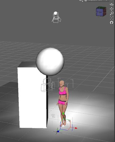

There seems to be something funky going on with your box scene, Takeo...
Is it one you built or a downloaded one? If built, how?
The main 'box' has normals pointing 'out'.
Thanks for checking!
So the glass shader loaded fine for you? Weird, because it didn't recognise itself on this office machine of mine.
I also noticed Takeo set "FixNormals" to "on" on every surface.
A word of caution to everyone (this will be in the docs): this is not a "magical fix for all bad geometry". It's a last resort fix, only meant to be used for one-sided polys you can't avoid seeing from the wrong side or for surfaces that can't be fixed in your modeling app or when it is unfeasible to invert normals manually in Geometry Editor: generally, for dynamic cloth that will often partially intersect itself when draped, or for clothing with heavy smoothing modifier when normals can get twisted on some details.
Normally, you don't need this. It's only there for a few specific cases, and even then, it's not likely to give 120% perfect results because, well, bad geometry is bad geometry.
PS We are used to all the shaders doing a general and generous faceforward() flip in DAZ Studio, but it's not good practice actually. Moritz Moeller warned against using it a long time ago already.

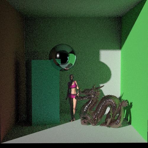

This first image is showing it rendering as it loads directly from the scene file. The second is showing as it renders after flipping the normals with Geometry Editor. I'm rendering without caustics, because I'm having a crashing problem when trying to render any refractive caustics (don't ask, it's driving me nuts, because I can't figure out any possible causes...reflective caustics work with no problems). There are no other changes between the two.
Yep made it inside DS and didn't want to fire up blender to invert the normals and I used the "fix normals" in the shader.
Didn't think there would be no faceforward() in the light shader
Try it for yourself. Put a genesis with your shader inside a sponza atrium or something in the likes
I'm sorry, but you aren't being very helpful. You see, I did render my presets in interior scenes. Published examples... One of them is the 'cover' of the ODT doc file you should have.
This is another: http://mustakettu85.deviantart.com/art/Why-488890119
Could you please point out what is wrong? Or what could possibly be wrong? What should I be looking for?
Sorry but I thought that anyone would see what I saw easily.

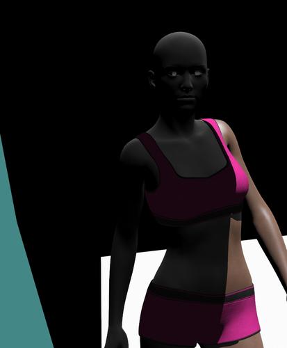

Subsurface need a lot of light for the effect. You'll get weird things with a 100% SSS unless you always put a lot of light on the character like you all seem to do. Example below with the scene from far and then a close up. One with your preset on which I used the "replace SSS color" in order to get the skin less dark already. Second close up is bree standard preset

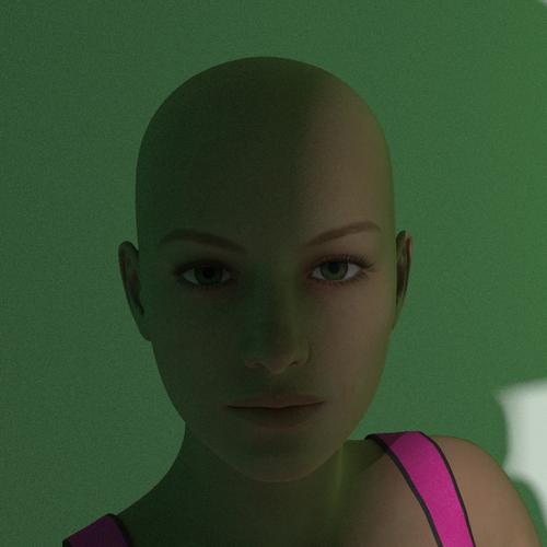

There is one Physdistant from the left and DelightGI.
Look at the ceiling. It gets illuminated by bounced light inside the box and that is the goal. If you get it to work, you know your GI is good
Quadratic or not the conclusion is the same. No light bounced off the walls
Last note : I also have a GI light with trace () and I do have bounce light like with UE.
Again: if you actually paid attention to the renders in my previous post, you'd have seen I am not getting any light on the ceiling with UE2 in bounce mode and the light colour set to black.
Correct me if I'm wrong, but even a solid colour in UE2 light colour swatch will kick in as environment color when the max trace is reached.
Is that not so?
You can see that DelightGI handles the bounce onto the primitives inside the box well.
The only issue is the ceiling. Which is strange. It's as if the normals are reversed, but wouldn't UE2 complain then in any case as well?
If you truly want to help me, then could you please compare the source code for your trace()-based light with that of DelightGI and tell me what I might be doing wrong? It shouldn't take much time, the shader is tiny.
As you mentionned a faceforward. would have worked.Don't know what Moritz Moeller said and in which context but you don't always have a good geometry and not everybody has the know how to correct them (I'm thinking about old DS or Poser stuff). Your choice

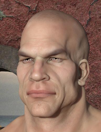

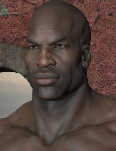

I decided to try one of Mec4D's textures with RSV and Byson came to hand. What I found interesting about morphing this one was that, in his default state, Darius is 100% him and 100% M6, you'd think Darius would just be him and not a variant of M6.

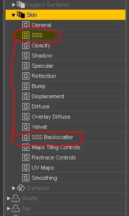

About the diffuse map. Why not a switch ON/OFF "Use diffuse as diffuse SSS map" instead? And also put the two SSS effect one after the other?
That may be easier said than done...although with ShaderBuilder it is easier to do. DS does have a habit of rearranging things like that...
Although I've found with SB, you can pretty much end up with predictable results if you pay attention to groups AND rearrange the parameters manually in them. Makes for some nasty looking spaghetti on the connections, but they tend to stay put (hopefully).

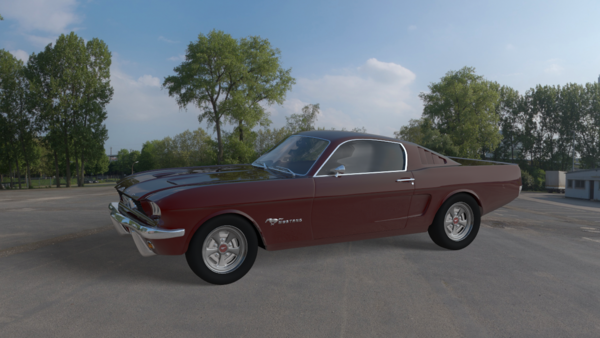

I've been trying to do a render that just was not co-operating. After suffering through some extremely long render times (2+ hrs), I looked at the geometry...it had some odd normals and other weirdness. After I fixed the geometry and reapplied the shaders, I got this from the standalone in about 5 minutes...and the same thing in the Studio included took about 15 minutes. I've never had geometry so affect the render time (one render, earlier and smaller sized, was only at 50% in that 2 hrs...so it was cancelled).
One of the other problems with the model is crappy UV mapping...so no decent tires. It would probably be easier to remodel them instead of trying to get decent UV maps out of what's there.
Is that a Daz Mustang? If it is then they are ages old and you really can't expect much from them by today's standards. DS1 was probably what it was built for.
That's actually the first time I see this with GI. Looks like severe undersampling from a multifaceted area light.
Are you sure you posted a finished render, not the ray cache preview? Is the box the one with the normals fixed already? Are you using an IBL map to make sure the scene doesn't open into vacuum?

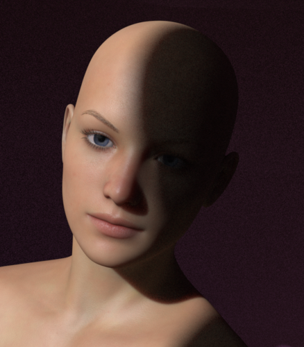

If you look at the dA post I linked to and read the description, you will see the girl is lit by IDL. The PhysicalSun delta is coming from behind her. Same with the G2F and cat in the hallway (I also should have a couple more test angles in my folder of the G2F up close against the window = in IDL; and other low-light tests on my PC).
It's not lack of GI light intensity but something else.
RT SSS will exhibit more noise with non-delta lights, GI/IBL included, but not generally that high with my default sampling values.

Takeo, I'd prefer to keep installation via shader builder files only, no custom param def scripts. Even then, again, DS can shuffle channels.
Now, why backscatter so deep down: because it's a cheat, really. A more-physically-based-than-most one, but a very specialised trick nonetheless. Only for those artists who really need it in very specific scenes. It has a long list of non-intuitive params.
You clamour for pulling diffuse up, and then you want this to get in the way? One of the two least generally useful features?
As for the switch: I'll need to think about and weigh the usability concerns with my less-tech-oriented focus group.

That's actually the first time I see this with GI. Looks like severe undersampling from a multifaceted area light. There is no arealight
Are you sure you posted a finished render, not the ray cache preview? Not the cache preview and not a finished render. I don't see the need to render further at this point.
Is the box the one with the normals fixed already? Yes you see the light bounce off the walls Are you using an IBL map to make sure the scene doesn't open into vacuum? No but I don't see why you'd need an IBL. Adding an IBL would add an additional light source. That is not what I want . Just IDL and that should work like it is working with the default G2F preset. No cheating please
Stop looking at the noise. That is not what I'm showing. It's about the shading especially in the part in shadow which btw is less noisy
The scene is pretty simple to reproduce. Try it

It was coming out translucent in parts, black in others and all sorts of weirdness. Also, every surface shader behaved differently, but none of them were completely 'correct'...the results were always 'off' somehow. And this was a case where the GeoEditor didn't help. It just flips their current direction. I had to use Blender and repeated 'recalculate' runs to get them all in same direction, and even after that I had one door that was backwards from everything else. I'm thinking that it was constructed as half a model and the other half was 'mirrored'...and in the original application, that was fine, but the conversion to obj didn't 'make real' the mirrored parts correctly. I still haven't figured out why the tremendous time difference...
No, Roger, that's from Turbosquid...which even makes it more surprising that it was such messed up normals. But I think it was automatically converted from max file, through 'squid's converter, instead of saved out from Max as an obj. Overall, it's got nice clean geometry and is rather high poly.
If I was thinking I probably should have exported without writing the normals and then tried it.
Sorry, Takeo, I don't understand where to look for wrong stuff on a render that noisy. My eyes only see the noise, and my brain refuses to process anything else.

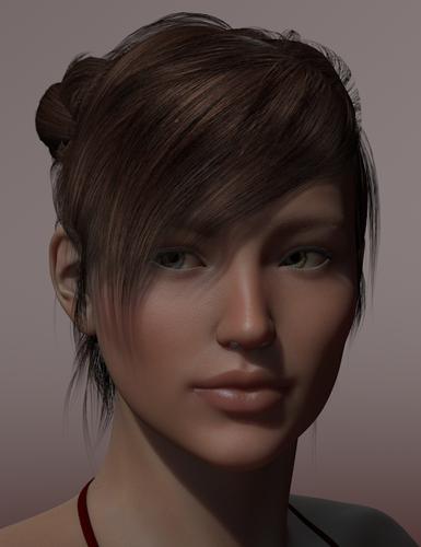

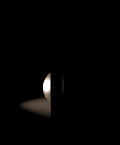

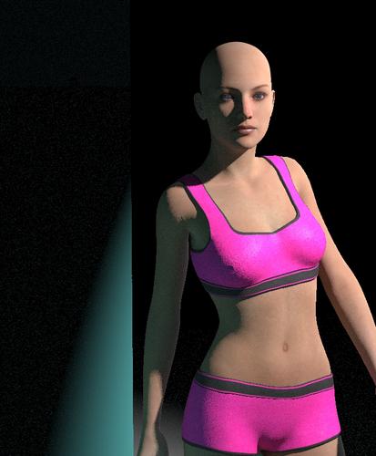

Here's a render in which I tried to reproduce your scene. It's the G2F preset (with only transmapped new brows overlaid) sitting in a 4m diameter DS primitive sphere out of which one poly has been deleted to make a window. There is my ground prop, a DelightGI and a SimplePhys distant.
I did kill Edge Strength in the preset because the new ones will come with it off by default.
The pink background is with normals flipped (two versions: SSS only and diffuse only). The black background is SSS-only in an unflipped sphere ("sitting in the void"), for reference to see only the light the SSS-only version bounces on herself.
Flipping the SSS vs diffuse back and forth, I basically don't see any meaningful difference. There is less interbounce in the ear, but I think it's logical because SSS does not reflect all the light straight back, it absorbs it and reemits (=scatters), so more energy will get "eaten".

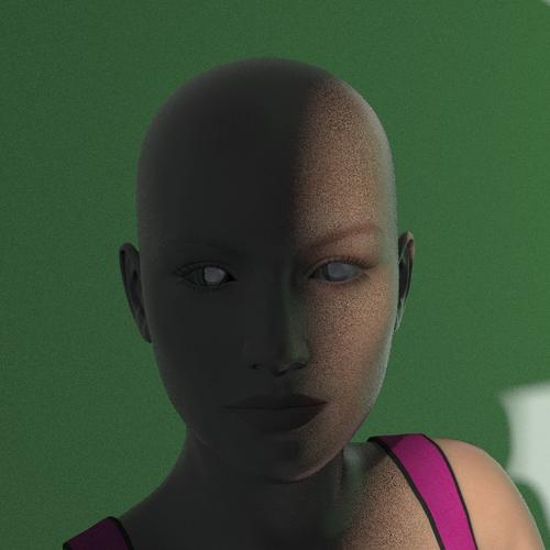

We need a photo reference to clear out the ear thing.
If there is something I don't see, could you please draw arrows on the image to show the wrong places?

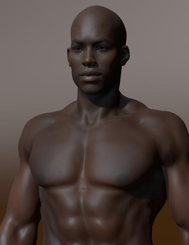

Under the heading "diffuse reflection" there is an archive of the measured Oren-Nayar roughness values for various real-world stuff.
As you can see, by increasing roughness the Oren-Nayar diffuse becomes more "even" - subtly darker in the better lit areas, but with more retroreflection along the edges.
When very rough, an Oren-Nayar sphere will look like the Moon.

I tried out a V4 map and that glowing nostril effect still persists, even when you turn off that edge setting completely. Something else is awry and I'm not sure what. The texture is Farissa by Virtual World, it's one I really like as it comes with textures for different brow colours which makes it a bit more versatile. Once we have all the lighting and shaders worked out I can move onto what I know I'm good at which is creating characters. I got bogged down in testing lights and shaders and haven't done any for ages.

In fact that is not the 100% SSS which causes the problem. It seems you have something wrong in the ambient
Put a delta light and something that will make some shadows between Genesis and the light

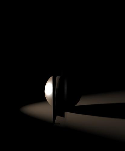

Rendered three pics
First with a sphere that is making shadows on G2F. No GI. The part in shadow gets some specular somehow (top of the head for ex)
Second render. Put a delta spot on the left of G2F. Nothing between genesis and the light.What is in shadow from the spot is completely black (not rendered but trust me). I then added a DELIGHTGI with no map. I get some IDL from the wall. That works. I played with shadow softness and shader hitmode and shadow sample. I kept the softness low because I want very sharp shadows. If you make them soft you may not see the problem
Third render. I saw that G2F Top and short get colored in shadow and no specular. And I thought that must be the ambient channel. So I put 0% ambient on the top and bingo. It gets black.
I didn't have a look at your code. There is no control of the ambient channel on your shader so there is no way to control that but there is something

*** Last edit : added an Iray render for reference. You see that you get some IDL from the wall and the floor that tint a bit G2F in the part in shadows.
Other problem : the default glass transmission hitmode parameter and shadow color being inverted or something like that
Create a scene with a plane as ground. Create a cube that will get the glass absorption shader and resize it to be thin enough to simulate a window glass. Add a PhysSpotlight and a camera to see what happens with shadows
First pic : transmission hitmode = primitive and shadow color = black
Second pic : transmission hitmode = shader and shadow color = white

Thought I'd try RTK out with an HD subject, in this case Boris by Smay. Normally HD slows down renders, which is why I tend not to use it much, however, with RTK there is no noticeable difference in render time and the detail is all there. Once we really get going with this shader kit, I might invest in a few more HD things if it doesn't slow up renders like it used to.
It's not specific to the shader.
DS have improved HD morphs support for quite some time now. Although it's slightly slower when rendering (depending on what subD level the morphs were built in), there's no more long load times with HD morphs.

I experienced something very weird tonight...
Rendered three pics
* Edit : added a screencap of the scene
** Second edit :
Imagine, it's the night or you are in a cave with just a lamp torch. What is the environment color? Black. If you put a black map into your GI light it's the same effect as not putting any map. Try it
* Added a screencap of the scene
CHEERS!
I got to thinking 'What would I get if I crossed Boris with Darius!?'. The answer is this guy!
CHEERS!
