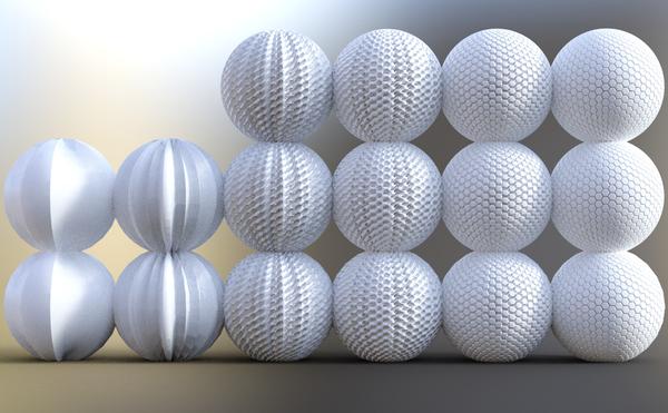

  • Oso3DOso3D Posts: 15,097
    That doesn't... fit the testing I'm doing? Or maybe I'm not understanding your explanation.
    In this example:
    Bottom row: Open SubD 0 (Base), Displacement SubD 0-5
    Middle row: Open SubD 0-5, Displacement SubD 0
    Top row: Open SubD 2, Displacement 0-3.
    It looks entirely like the two effects combine, that the effective displacement resolution is Open SubD + Displacement SubD (or, well, x4^that number)

  • DAZ_SpookyDAZ_Spooky Posts: 3,100
    edited May 2015
    In this example:
    The bottom row, you are still getting the same number of polys for displacement, so they should look, for the most part, the same. The top level they are slightly different but closer than what I would expect from the way it is supposed to work. Now I am going to have to figure out if it did indeed change, and if that change was intentional. LOL
    Edited to add: Unintentional change that is different at render vs. viewport. Thanks.

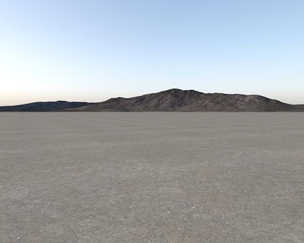

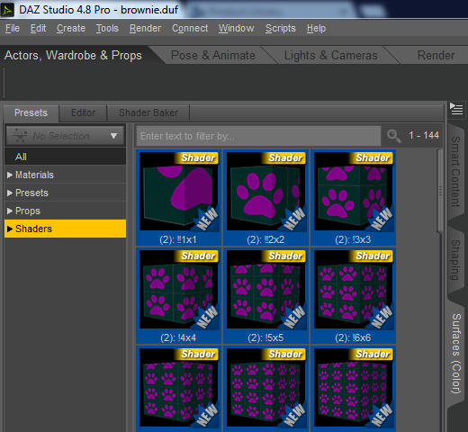

    I know most people probably already know this, but I'm going to share it here because it had me stumped for ages and Topher (Daz support) has kindly explained it to me.
    Blurry Ground Plane Textures in Iray
    I was having a big problem with ground plane textures coming out blurry in Iray on all of my landscape products. Turns out it was because the Iray conversion doesn't keep the correct tiling information in some cases. Here's what I had to do to resolve it:
    1. Select the ground plane in your Scene tab.
    2. Go to Surfaces tab (Editor) and select the corresponding surface for the ground.
    3. Expand that list out and find the section called 'Tiling'. This contains the tiling information for that surface. Make a note of the values.
    4. Still in Surfaces (Editor) tab, make sure you have the ground surface selected then switch to Surfaces (Presets), find the !Iray Uber Base shader and double click it to apply (no need to ctrl + click).
    5. Go back into Surfaces (Editor) and if you expand your ground surface list you should now see a section called 'Geometry'. Iray won't carry over the tiling values when you convert to uber base, so you have to input the appropriate values that you noted down earlier manually.
    6. Render.
    This should sort out the problem! :) Yay! I'm so happy.

  • K T OngK T Ong Posts: 486
    tl155180 said:
    K T Ong said:
    I've a couple questions as well. If I've read correctly, I've read about converting the shaders used on any surface in a DAZ scene into Iray shaders so the surfaces will look even better when rendered in Iray. How do I do this conversion? What items do I need to purchase and install? Also, will any surface that has an Iray shader applied to it become a potential emitter, meaning I can adjust the luminence settings so the surface will emit light in my render? Any help will be appreciated, thanks in advance.
    See my post above yours for applying Iray Shaders to surfaces. In most cases you won't have to worry about the tiling part. I mention the !Iray Uber Base, but its the same principle for all of them. The only difference might be that you may have to use Ctrl + click and select 'ignore' when you apply the shader if you want to keep the original texture maps... not sure if thats still necessary, but it doesn't seem to hurt.
    Surfaces will only become emissive if you apply the specific Iray 'Emissive' shader. Otherwise they are just fancy shaders for use in Iray. With Emissive you do have to use Ctrl + click and 'ignore' when applying the shader if you want to retain the textures.
    You don't need to purchase anything as all default Iray shaders come with the new content package for DS 4.8. Just make sure you have the latest free content package installed in DIM.
    Thanks, but I wasn't able to find this '!Iray Uber Base' thing. Where is it?
    Below is a snapshot of the menu in which I searched for the said shader. There isn't a 'presets' option there, as can be seen. And it's DS4.8 I'm using.
    You mentioned this free content package. I presume it's separate from the DS4.8 program proper? If so, where can I find it?
    520 x 580 - 190K
    Sorry, my mistake, I just spotted the 'presets' tab.
    Still no luck searching there either, though... :down:
    520 x 480 - 240K
    You will find the Shaders in the Content Library (not the Surfaces pane)
    DAZ Studio Formats > My DAZ 3D Library > Shader Presets > IRay > DAZ Uber
