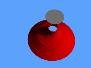

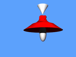

  • Hermit CrabHermit Crab Posts: 833
    Just to say thanks for all the efforts to crack this that are being made.
    Maybe later in the week I'll be freed up enough to try to build my own body-armoured figure with its own cloth.
    In the meantime I played with the concept again last night with only one collision sphere attached to a cone. The cone's movement is followed by the sphere.
    The cloth has a soft-body-attach region around the waist. It remains still in its place in the scene because those vertices aren't attached to any geometry. The vertices are too tightly packed, as you can see.
    I played with many settings to make the cloth rubbery or flowing in different attempts. Apologies that I didn't document them. In general I reduce bending to zero and stiffness to about 28 just to begin with. I think that this one has stiffness even lower and bending about 12. But it really depends on the mesh. Self-collision of the cloth was enabled.
    The simulations were very fast.
    320 x 240 - 1M
    320 x 240 - 876K
