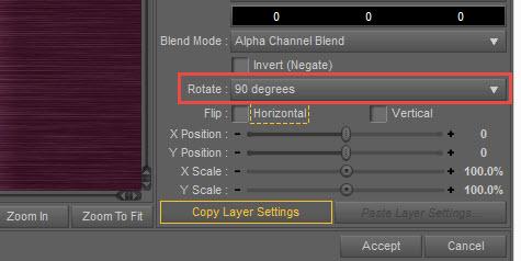

...this has been working great, until I tired it on Fabiana's Twin Fair hair. For some reason when I apply the shader to the side strands the texture loads crosswise instead of following the direction of the hair. Not sure how to fix this as the LIE only has a flip but no rotate texture option. The same also happens with the original UHT as well. The native 3DL maps work fine so I'm not sure what is causing the conflict.
I find this a bit perplexing as I have used UHT2 on other non Daz hair (including Koz's hairs) and it has worked perfectly.
More than likely it's because the uvs for the hair have been laced out horizontally, rather than vertically.. I'm not aware of a way to rotate textures in Iray, though there very might well be a way to do it
There is a Rotate option, at least in DS 4.9.2.70:
