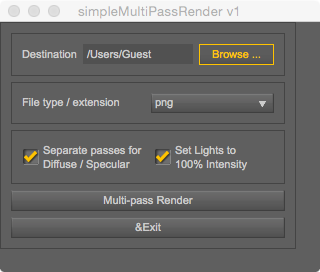

  • EsemwyEsemwy Posts: 578
    edited March 2015
    OK, It now supports separate specular and diffuse passes. It also has an option to set the light intensity to 100% before rendering. Both options can be disabled from the dialog.
    Like a number of others I've seen on these forums since, I purchased the ReLight product full of hope. Unfortunately, the product hasn't been supported in quite some time and doesn't function under DAZ Studio 4.7. I own DreamLight's LDP-R and like it a lot, but sometimes I want a bit more control. A bit more searching turned up butaixianran's freebie script in this forum post (http://www.daz3d.com/forums/discussion/38514/) which is in turn based on mCasual/Jacques’s mcjListRender (https://sites.google.com/site/mcasualsdazscripts/mcjlistrender-for-ds-1-2-3-4).
    Since it's under the MIT license, I took the script and ran with it.
    I've recently started using DAZ Studio, and have been looking for an excuse to learn to script it. I've spent two evenings hacking on it to do what I wanted and modified the user interface to suit my tastes. I've made it available on GitHub (https://github.com/esemwy/SimpleMultiPassRender).
    I'm sure it can do more, but I need ideas, and testers, and even code contributions.
    Right now, it's only tested on what I have, which is 4.7 on OS X Yosemite. Anybody else interested in helping out?
    Either way, I'm going to use this topic as I make updates in the hope that it will be useful to others.
    Updated to save preferences in a JSON file in the same directory with script.
    Added file prefix for those that don't want to keep creating new directories or overwriting files.
    I'm still taking suggestions.

  • I write a new version for Iray:
    https://www.daz3d.com/forums/discussion/451996/free-script-simple-multi-pass-render-iray#latest
    This new version is pretty easy to use, it will use the file path in your render setting, so just click it, everything will be done.
