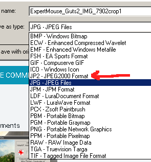

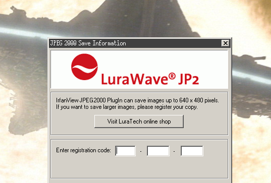

    And JPEG2000 (JP2) costs money to get things to be able to understand it (Or at least that's what I understand from the warning in IrfanView, when I try to save one on occasion by accident). If the standard was not under such strict user rights restrictions, It probably would be more popular then the older 8bit JPG format.
    I've started doing as much as possible with PNG (Portable Network Graphics), however sometimes limits on image MB often forces me to go to a format with Lossy Compression (jpg, gif, cringe), especially on the forum.
    http://en.wikipedia.org/wiki/Portable_Network_Graphics
    (EDIT) Note on IrfanView. I have stopped looking at newer versions, as everything after 3.98 has resorted to odd image resizing when you resize the window, and the zoom thing also changed drastically (I hate the new method, others Love it). So if the restriction on JPEG2000 has been lifted, I am unaware of it, and still can not use it.
