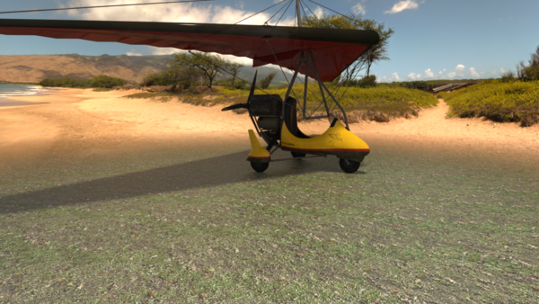

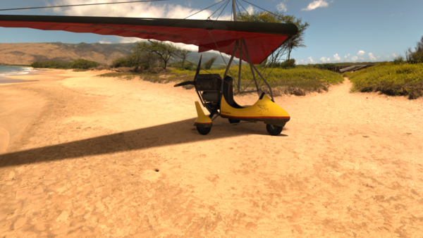

  • zaz777zaz777 Posts: 115
    The first attached image shows the Ultralight model on the Maui beach (DimensionTheory's DTHDR-MauiA). Looks OK, at least for the purpose of this example, but lets say we want some grass in the center of the scene, as in the second attached image.
    If you want to use the same HDR environment without editing it, you can add your own ground plane with a Cutout Opacity map. In this example, I used a plane with dimensions of 25 meters on both sides.
    1) First, I applied the Iray Uber shader to the Default surface of the plane.
    2) I then applied the "New Texture 9" diffuse, normal and displacement maps from the Woodland Floors DAZ Studio Shaders pack. These were all individually tiled by a factor of 20 both horizontally and vertically. You can do that via the "Image Editor...." which can be found directly above the Layered Image Editor... option in the image menu.
    3) The third attached image, circular_mask-001.tif, was then put into the Cutout Opacity channel.
    In the example images, it is pretty obvious where the visibility of the plane goes away and the material settings for the new ground plane need tweaking. Choosing a texture that more closely matches the environment HDR, tweaking the Cutout Opacity strength or the changing the actual opacity map can much better blend ground plane into the background.

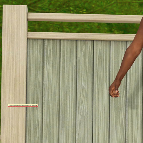

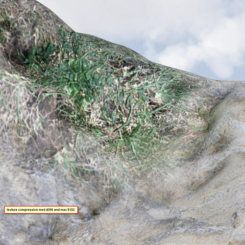

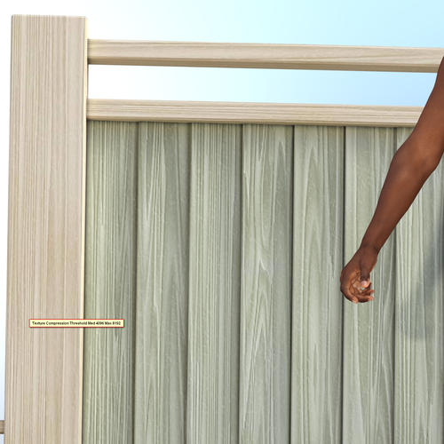

  • hjakehjake Posts: 1,313

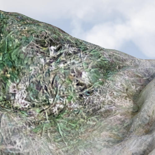

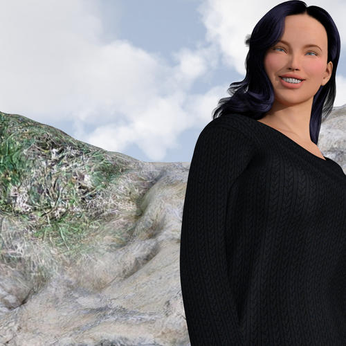

    Can anyone tell me what might be causing this polka dot effect on the textures as well as the blocky shadows?

  • DAZ_SpookyDAZ_Spooky Posts: 3,100
    The texture issues may be due to texture compression. The triangle shaped shadow looks like it is caused by a non-planar quad.
    edited June 2015
    Can you suggest anything I can do to eliminate this?
    The landscape is Fantasy Camp III - http://www.daz3d.com/fantasy-camp-iii
    The fence is Hot Tub - http://www.daz3d.com/hot-tub
    I should have mentioned that I am applying the iRay Ubershader Base by pressing the control key while applying the texture and selecting no for replace images.
    Post edited by hjake on
    Can you change the landscape prop to Sub-D without it ripping apart? That might smooth it out.
    hjake said:
    The fence is Hot Tub - http://www.daz3d.com/hot-tubAdjust the texture compression settings in the render settings pane under advanced.
    The non-planar quad, turning it into a sub division surface may do the job.

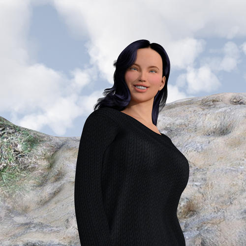

    marshian said:
    First off thanks to both of you for responding in real time :-)
    I converted the landscape prop to sub-d and it did the trick.
    A note about render times:
    3 min 5 seconds with GPU only and cpu/GPU combo.
    Converting prop to sub-d added 1 minute. (3840x2160 was render size)
    my system is a i4790k 32gb ram with asus gtx 970.

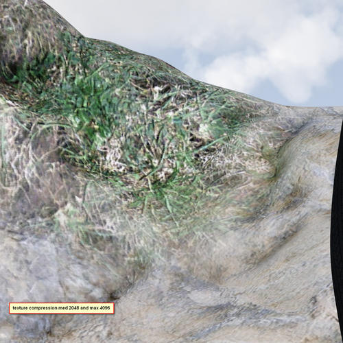

    hjake said:
    I increased the max threshold from med 512 and max 1024 to med 2048/max 4096 then med 4096/max 8192.
    Please see attached.
    1240 x 1240 - 590K
    1209 x 1209 - 523K
    edited June 2015
    So texture compression was definitely the problem.
    1999 x 1999 - 1M
    1999 x 1999 - 1M
