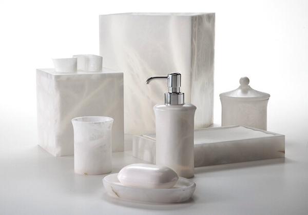

    Those renders are amazing and your render times are ridiculously fast.
    I haven't been able to get Photoreal results like that from UE2, no matter what I do.
    My ex is a commercial product photographer and your renders look as real as the shots from her catalogs. I'm not being hyperbolic either.
    I saw your renders and I thought of this photo below.
    638 x 446 - 42K

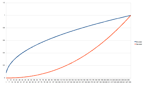

    Well, I think I've wrote the steps needed in Parris's thread. But here are some hints.
    You need:
    * Linear workflow (gamma corrected textures, everything in linear space, output to gamma space). Output gamma should be 2.2.
    * Plausible materials (never, EVER, use pure white - 255,255,255 for the diffuse) and lights. The Disney's Principled BDRF paper says albedo (total reflectivity) stays generally around 40% in linear space (works out to around an RGB value of 168,168,168 at 100% levels).
    Example values in gamma and its linear counterpart:
    RGB 24,24,24 = 1% Linear
    RGB 90,90,90 = 10% Linear
    RGB 124,124,124 = 20% Linear
    RGB 160,160,160 = 35% Linear
    RGB 192,192,192 = 53% Linear
    RGB 230,230,230 = 80% Linear
    I generally use 192,192,192 for lights since that allows me to raise or lower temperatures easily than if I set it to 255,255,255. At that value, i need to work out the offset for strength. It also has the advantage of being more granular and can be extended in range more easily. 2 x 192,192,192 works out to 106% strength.
    * Establish a white point based on the above material. You should get plausible looking lights and light setups that way. In simpler terms, your pure diffuse white material with an RGB value of 160, 160, 160 will look almost pure white (255,255,255) when there's light casting on it. That light intensity you use to get to that point is your maximum intensity.
    * if you use several types of lights in your scene, you need to divide that max intensity between direct light and indirect (ambient light). You can use less than max of course, but should never go above. Think of it as doing energy conservation the manual way.
    * At grazing angles, specular can go up to 255,255,255 at 50% if you use diffuse, 100% if there's no diffuse (reflection can go up to 75%). When viewed perpendicular to the camera, they drop to something like 3 to 5%. You need fresnel in your shader for that. Outside of US2 and Kettu's shader, I haven't seen any shader in DAZ Studio with fresnel attenuation for specular and reflection.
    * Same as white, black is not an RGB value of 0,0,0 but should be around 16,16,16 to 24,24,24 (best stick to this value). Why 16,16,16 then? That value works out to 0.2% in linear space. I use that value to see if how that blends with very dark areas/shadows. If its the same, then you need to raise ambient light a bit.
    * Total reflectivity is diffuse + specular + reflection. The more diffuse you have, the less the specular/reflection. The more roughness the diffuse, the less glossy the specular and the higher the fresnel strength. The same applies to reflection - rough means blurry reflections. It's not enough to have energy conservation in lights, but you need to use that in materials as well.
    * Smooth metals are generally Lambert (low roughness diffuse). Even when its rough, it's still a very Lambert diffuse. Vice versa, rough materials generally are still rough even when they're smoother. And there is such a thing as a smooth coat over diffuse.
    * Build your scene without textures or HDRI first. They should generally look plausible even without them. Add textures later, since they generally need to be converted to linear space. Most of the time, they will either need to be corrected in an image editor or be compensated in some way (raising strength levels or rougness for diffuse/color maps).
    * Even on an empty scene, it's best to use an environment sphere to get reflection looking correctly (and to see if your reflecting materials doesn't reflect more than it should).
    * The layered approach works pretty well. As noted in the Disney's Principled BRDF paper, most BRDF falls short of real world materials. Even the more advanced like Ashikmin Shirley or GGX fails since they do not have a long enough tail (wide specular) at very high glossiness. You need to use a wide and narrow specular with fresnel enabled on both to get close to plausible.
    * The layered model isn't just limited to specular and reflections, but can also be used with diffuse as well.
    * Never, EVER use ambient unless you're doing emissive materials.
    * Don't use velvet. Use a low glossiness, high fresnel specular instead.
    You need:
