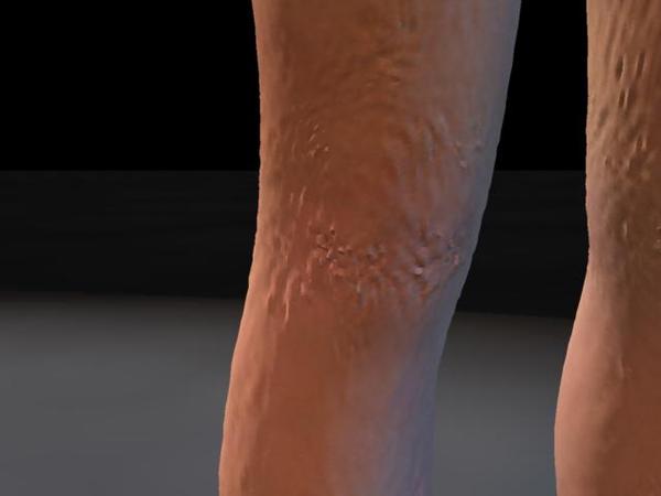

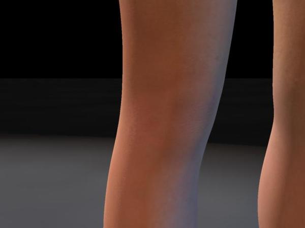

    Like I mentioned, the displacement map has way too strong an effect. I found I could get a more reasonable use by creating a nested shader tree in the displacement tab.
    - in the top displacement tab channel, use an "Add" operator.
    - set the top channel of the add to a value of 50%.
    - set the second channel of the add to a "Multiply" operator.
    - place the displacement map in the top channel of the multiply operator.
    - Set the second channel of the multiply to value and put in something small like 1% or 2%.
    In the attached pics, I show a close up of the right knee with the multiply value set to 2% and to 20%.
    Do you think this could be adapted to use some of the more detailed textures for Studio in Carrara? Or, maybe I am just reinventing the wheel.

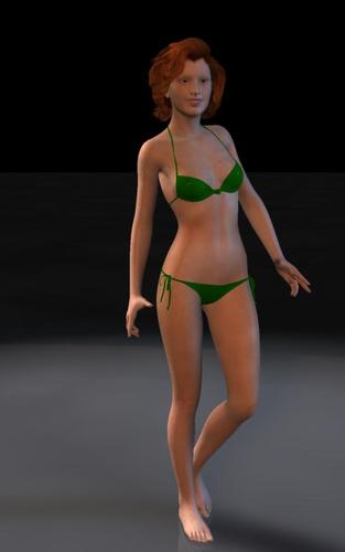

    Also you'll want good lighting to refine your skin settings and testing. A carrara shader that looks good with Full GI won't necessarily be right for a non-GI lighting scenario. I have just lately been trying to work on hair shaders to try to find settings that would appear more realistic, and what I've done is take PhilW's portrait studio scene (I'm using the one with the 'fashion' lighting setup) and add to it some lights in a replicator using Rashad's 'fake GI' approach, don't need many, just have 9 bulb lights replicated in a square and set above the Meshlight emitter in PhilW's original scene, turned down low in intensity, and I'm still using real Full GI, but because there aren't that many lights added, the scene still renders relatively quickly. I do think Rashad's awesome method can help correct one of the few weaknesses in the Carrara native renderer, which is that the specularity effects for skin can be diminished/incorrect/not spread enough when using a single point light, and using several point lights in tandem coming from a 'place' gives a much more accurate spec effect and also gives much better visibility to the skin itself (which is very helpful when trying to determine the right bump amount, for example). Oh and I have the gamma correction set to 2.2 to enable the linear rendering on this.
    Like I said, I'm working on hair shaders at the moment, not skin, and not doing so well in my refining process so far (please ignore the hair, it's not nearly up to scratch yet lol) but my only point on this is that a stable lighting rig is probably going to be important in determining what's going on with your skin as you fine tune it.

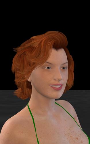

  • DiomedeDiomede Posts: 15,454

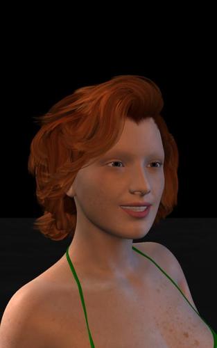

    Thanks for the vote of confidence, Jonstark. I consider you one of the skinshader gurus. In fact, I had saved a previous post of yours about skin/eye, etc. settings in a text file and have used that (and PhilW and others) to get started. I do feel like a fish out of water, though, so I'm going to be making a lot of basic mistakes. I really appreciate the support on the forum.
    I almost have a working baseline for the Forbidden Whispers G2F resource set that I bought. But I am doing something wrong in trying to get the eyebrows to overlay correctly. Not complaining, just explaining why it looks the way it looks. I'll get it worked out. Same issue regarding makeup.
    I already see what you mean about how everything interacts with everything else. Here I've used a slightly altered version of the default 3-point lighting scene in the Carrara browser. The shape of the figure, etc. is all the default G2F.
    The hair is the Portia hair by April and the bikini is Hongyu's.
    So, if anyone knows some good eyebrow/makeup tutorials for using these resource sets, I'd appreciate it. Or, am I expected to apply them to the base face map in an external program like Photoshop? Seems like should be able to use an overlay or something.

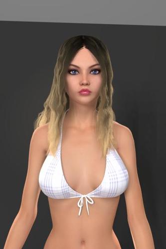

    Yay! Some eyebrows are showing up. This can't be the intended method, but I used a mixer then put the eyebrow in file in the mixer channel and inverted the color. Won't work for makeup though.

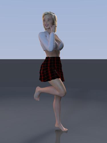

    Long way to go! But here is a little pinup showing off a skin shader built from texture maps from the merchant resource linked above and a Carrara dynamic hair based on some of Jonstark's tutorials. The skirt was draped to the posed position using Stringtheory's undesuit concept.
