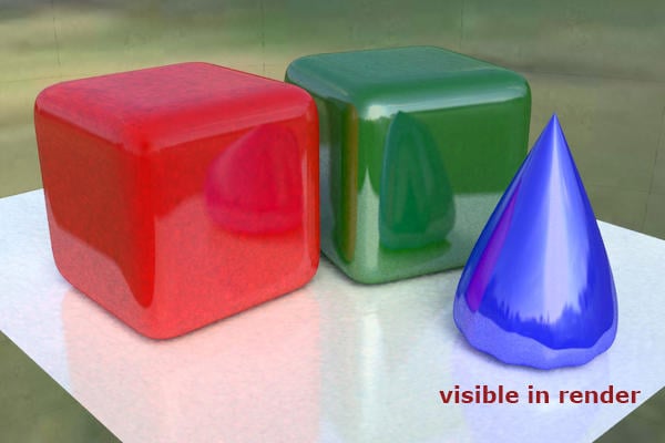

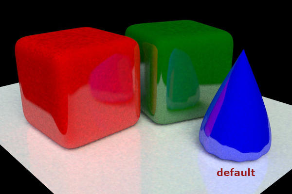

  • prixatprixat Posts: 1,617
    You can see the trees in the reflections:
    600 x 400 - 156K
    600 x 400 - 129K
