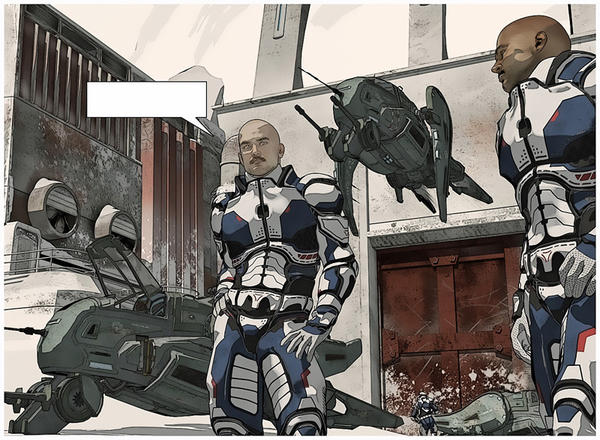

    To clarify on Outline, I do use PWToon, I simply add the outline from the Render settings on top of it instead of the PWToon outline - so basically I use PWToon shadows mainly. Here's a pic as a result. Not trying to convince you, just telling you what I experienced :]
    Good luck.

    Well, the basic thing as I said is to render 2 pictures:
    - 1 with the PWToon settings you want (the manual posted above helps a lot, but it's mostly tweaking around until you are satisfied)
    - 1 with the Outline which you get through Render Settings
    You then compose the final images using something like the free Gimp or - I personally use Photoshop Elements, and there you go.

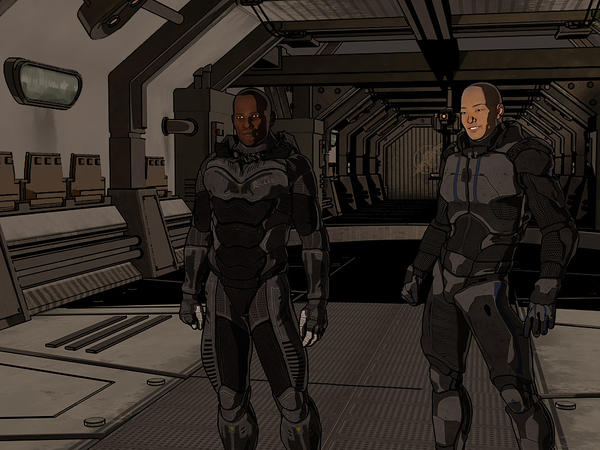

    Two other examples, one with extra effects for a more grainy, hand drawn look.
    Although I like those (the posture of the main white guy is a bit weird!), I would not recommend this for a large Comic project. Discrepancies are huge between props (things that can be better cheated with a good common lightning) and it's a lot of work per image.

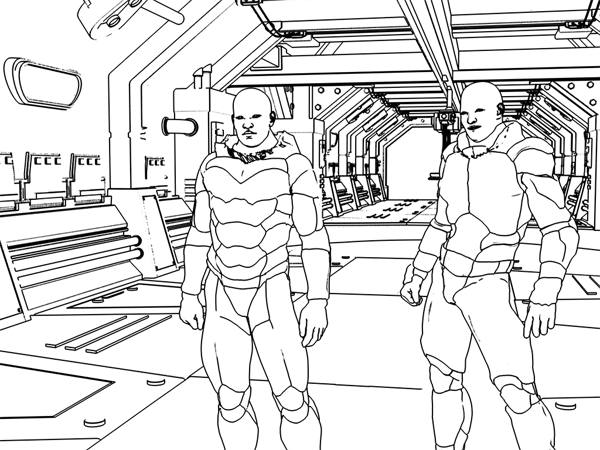

    Could you perhaps upload a render of the image you get when you render using the outline script only?
    When using PwToon and the outline script, do you set the render to default or to cartoon?

  • BalooBaloo Posts: 71
    edited September 2014
    Render is default. If you render through Cartoon, it will bypass the PWToon shaders and use the Cartoon setup, as far as I know. I'm sure more experienced Daz users can confirm this or explain it better than me.
    You add the two together simply by "layering" them together. Obviously the outline has to be saved in a format that keeps transparency. You open your editing tool and you simply put the Outline in a layer above the PWToon render and finished. There is half a million tutorials on how to use layers in Gimp, Google is your friend there :]
    Attached is an outline result.
    Edit: a format that keeps transparency is PNG for instance.
